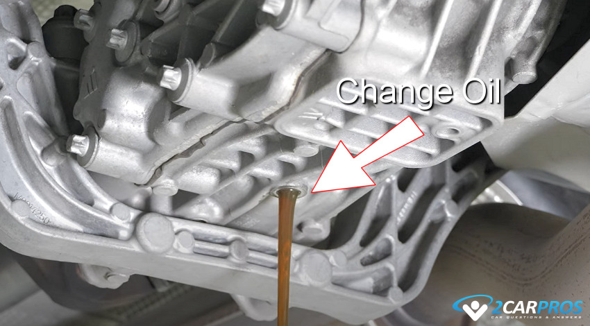

1. Engine Oil Change: Changing the engine oil is by far the best service you can do for your engine, if this service is neglected it can cause serious engine damage which is very expensive and can total the car.

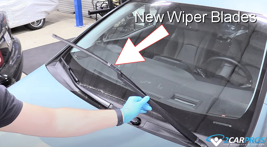

7. Replace Windshield Wipers: In foul weather is essential to have new wiper blades to ensure proper windshield vision and control of the car. Replacing wiper blades is relatively simple, snap the new wiper blade in place and lower the wiper arm, repeat this operation on the opposite side.
new automotive windshield wiper blades

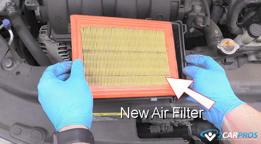

10. Checking Engine Air Filter: A car engine must have clean air to process, if any debris is present in the intake manifold it will cause premature engine failure. Inspecting the air filter is a simple process in most cases and typically only involves opening the hood and locating the air filter housing that is usually near the air intake, if the air filter is dirty it will need to be replaced.
new automotive engine air filter
