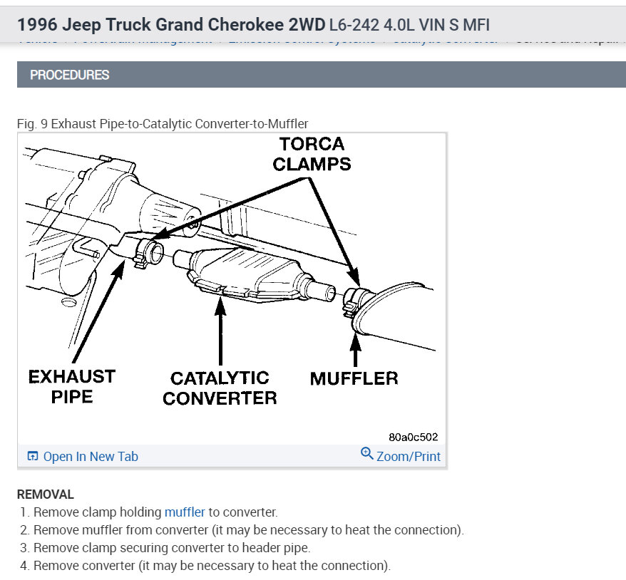

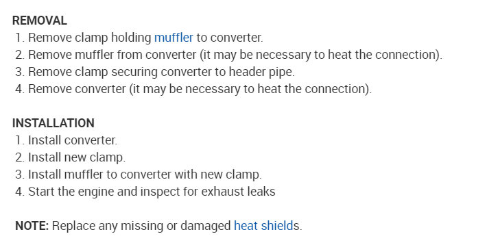

This sounds like you have a clogged catalytic converter but to be sure this guide can help us confirm the failure and I have included instructions on how to change the cat out in case you need it.
And this may help as well:
https://www.2carpros.com/articles/engine-has-low-power-output
Check out the images (below). Let us know what happens and please upload pictures or videos of the problem so we can see what's going on.
