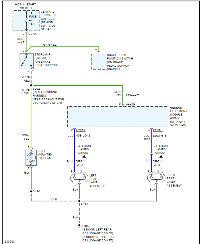

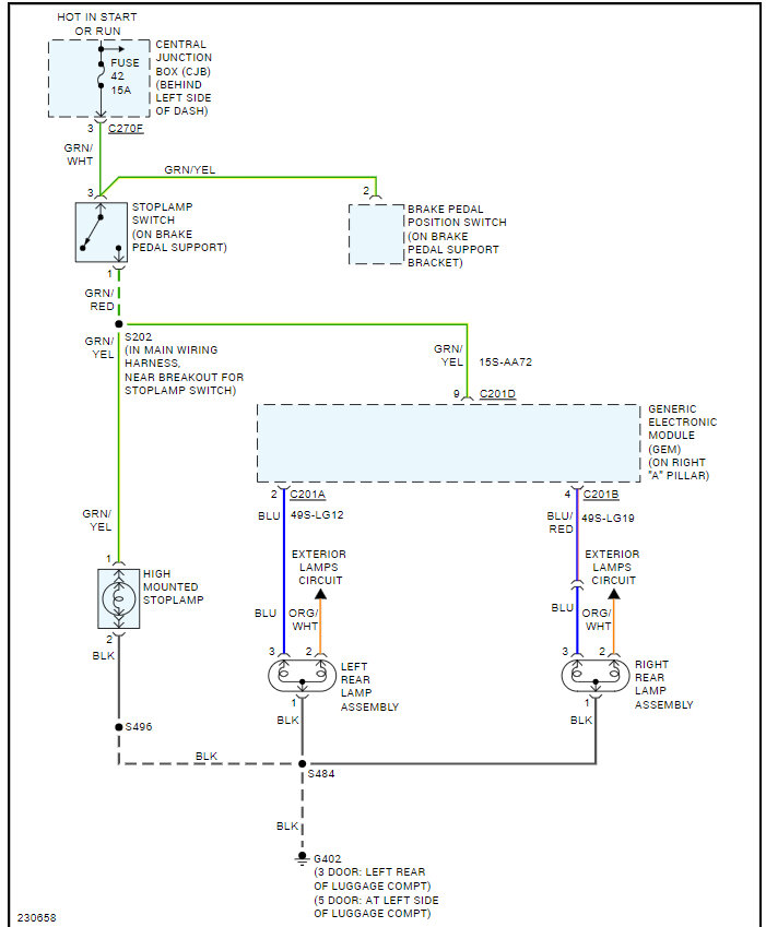

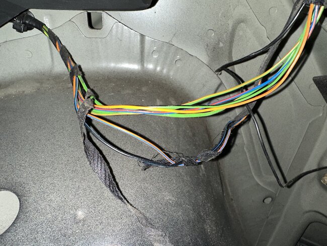

Hi, could someone tell me what color the wires are on rear brake light the car listed above Zetec. I’m trying to connect in a towbar electrics but can’t find anything online.
