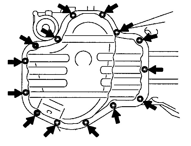

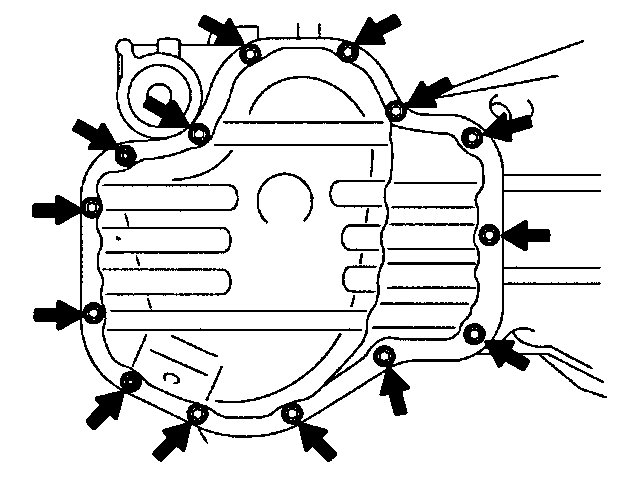

There is not a specific link for this vehicle. However, here are the directions specific to your vehicle from Alldata. I have attached the pictures which correlate to these directions.
REMOVE OIL PAN DRAIN PLUG AND DRAIN OIL.
1. REMOVE OIL PAN SUB-ASSY
(a)Remove the 12 bolts and 2 nuts.

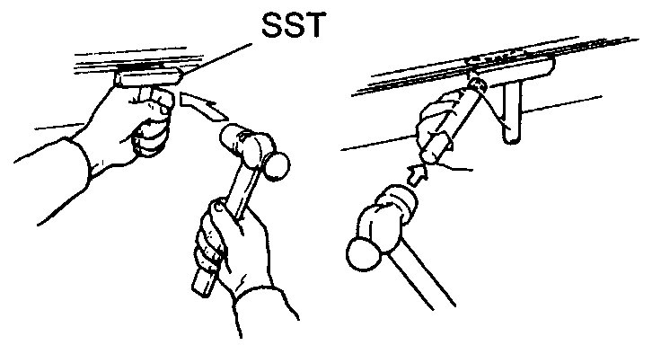

(b)Insert the blade of SST between the crankcase and oil pan. Cut off applied sealer and remove the oil pan. SST 09032-00100
NOTICE: Be careful not to damage the contact surface of the cylinder block and oil pan.

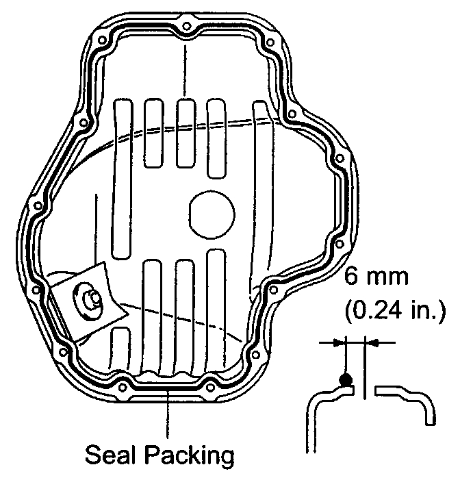

-Install the oil pan within 3 minutes after applying seal packing.
-Do not start the engine for at least 2 hours after installing.
(a)Remove any old packing (FIPG) material and be careful not to drop any oil on the contact surfaces of the cylinder block and oil pan.
(b)Apply seal packing in a continuous bead (diameter: 3 mm to 4 mm (0.157 in.) as shown in the illustration, and install the oil pan. Seal packing: Part No.08826-00080 or equivalent
(c)Install the oil pan with the 12 bolts and 2 nuts.
Torque: 9.0 N.m (92 kgfcm, 80 in..lbf)

Let me know if this helps or if you need something different. I want to add a thought. The pans are put on by the manufacturer with a sealer and not a gasket. They can be difficult to get off. Make sure you do not bend or damage any of the surfaces.
