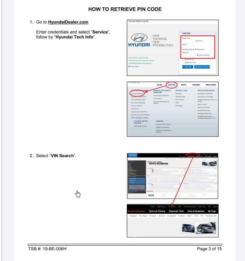

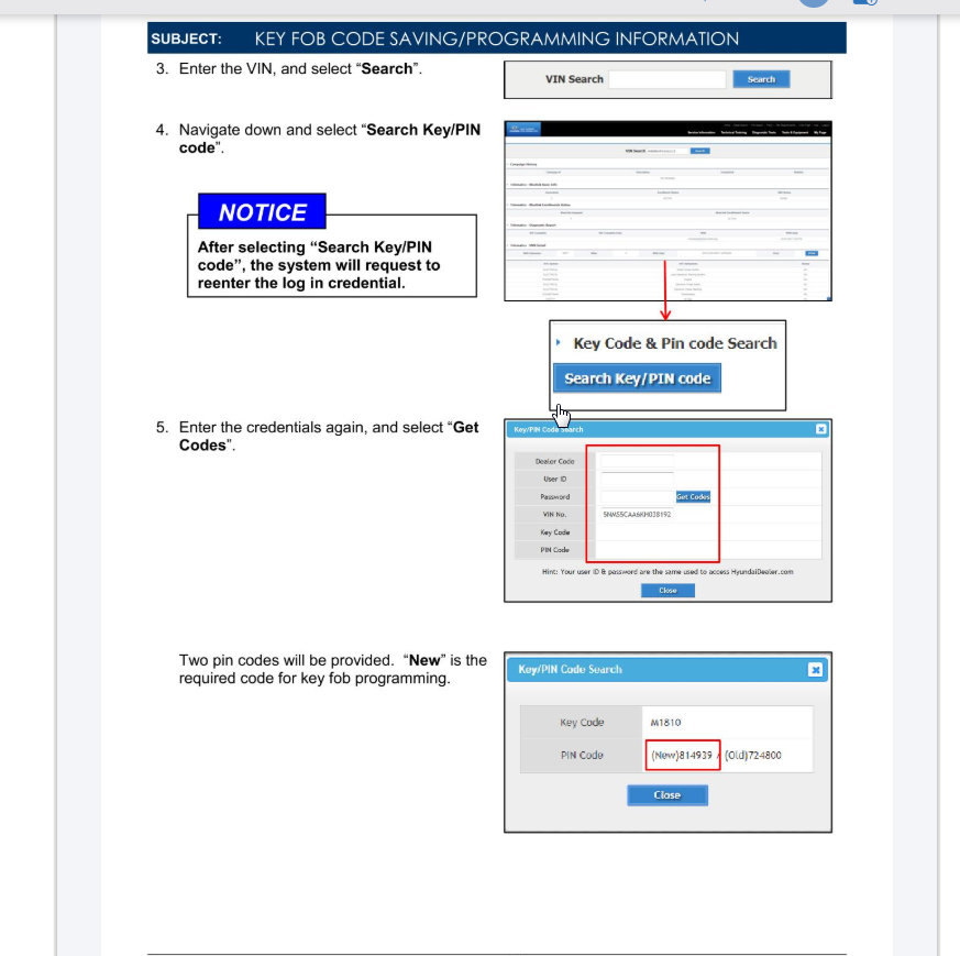

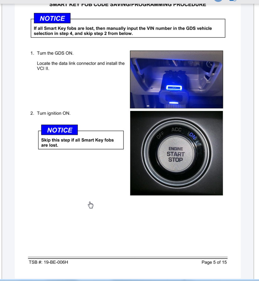

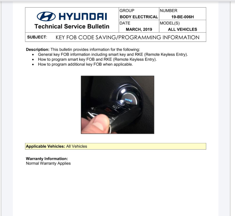

Unfortunately, this is something that the dealer would need to generate. We don't have the ability to generate these codes as it requires an OEM scan tool to program it and you need access to the OEM website to get the correct code. I attached a TSB that explains it in more detail.
The OEM does this so that people cannot get a VIN off of some vehicle that does not belong to them and then request a website like this to get the code and you can gain access to the vehicle or steal it. Basically the dealer will be able to prove ownership and we are not able to do that.
Hopefully this make sense. Let me know if you have questions. Thanks

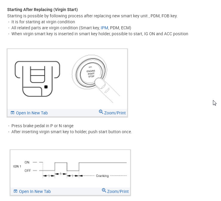

Is there a history to this vehicle? In other words, what was the original issue or what were you trying to do when this issue started?

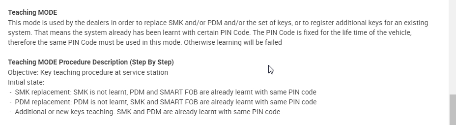

I attached the information about this system. As you will see there is a PIN that goes with the vehicle no matter what parts are changed. The only thing I am wondering is if there have been other changes made to this vehicle that has caused the PIN to change.

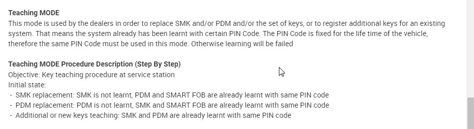

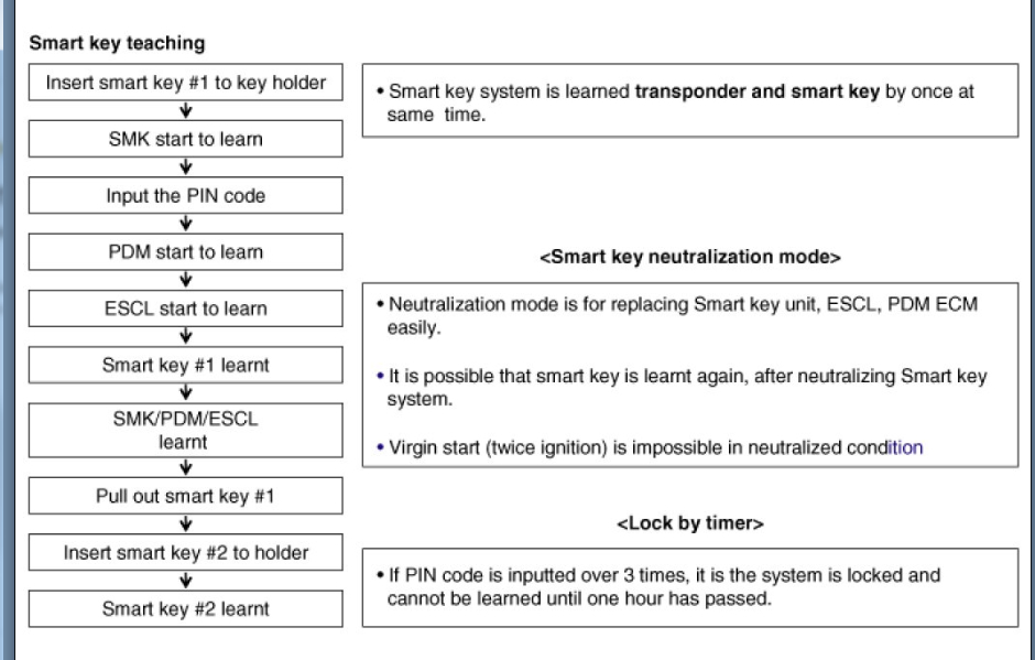

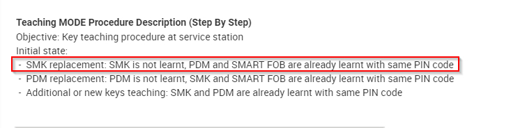

Just to be clear, the SMK and PDM are used? So they have already been learned with a different PIN information.
When you replace the SMK and you have the PDM and smart FOB that have the same pin, you can program the third to match with this pin. However, when you install one that has a different pin already learned and you input this pin, it is different and will display wrong pin.
Please review the attached document. It clearly states that when one of these three items is replaced, the other two are to be programmed with the same pin.
