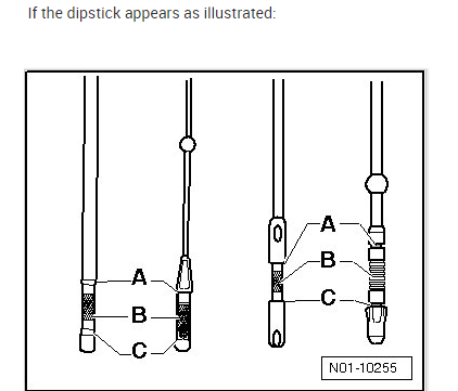

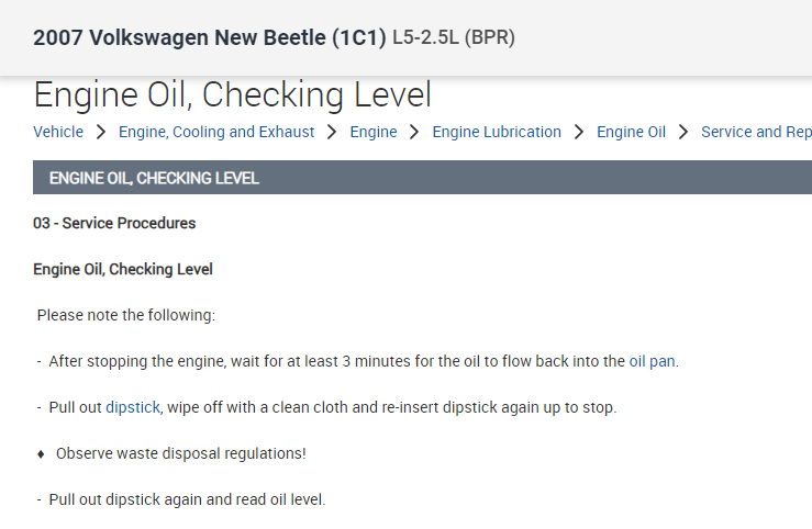

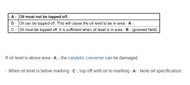

Check to see if the leak is high or low on the engine. Also, in this case, I feel it is more likely that the oil may have been overfilled.
I attached the directions below for you as far as checking the oil level. Check this and let me know what you find.
