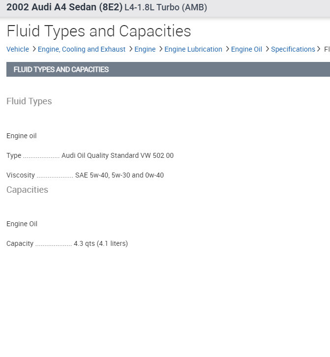

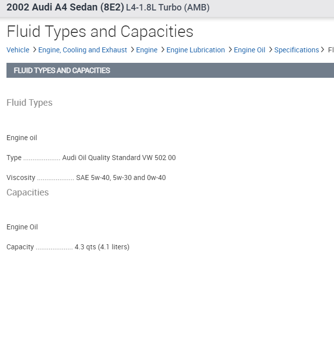

Hi, the previous mechanic did the oil change with 10w40 in the engine where it was supposed to be 5w30LL. After 13,000km I changed the oils again back to 5w30. Was any damage caused because of the 10w40? Was it a good idea to go back to 5w30?
