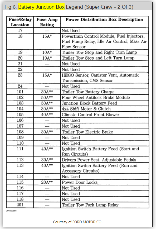

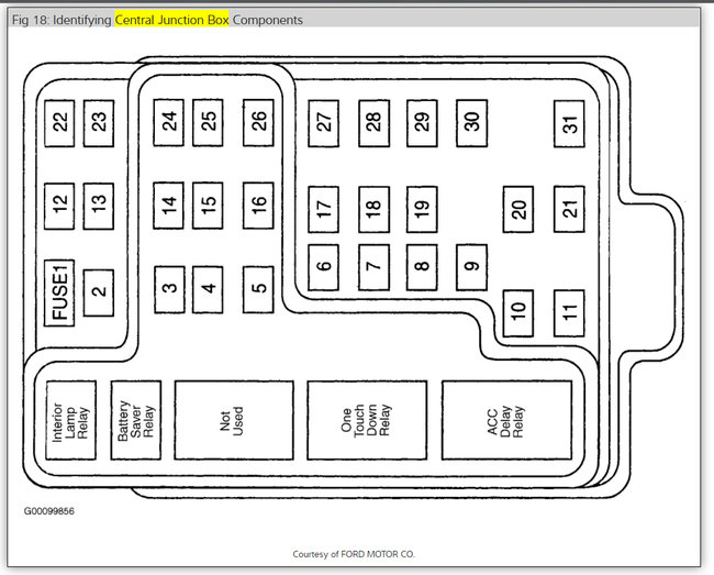

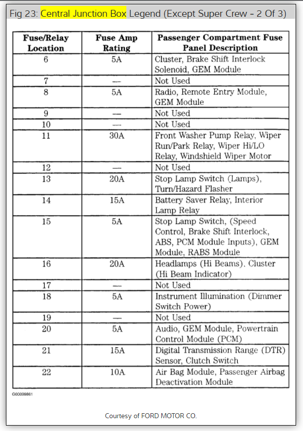

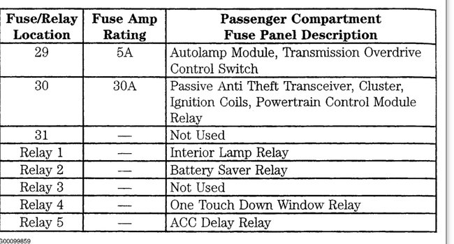

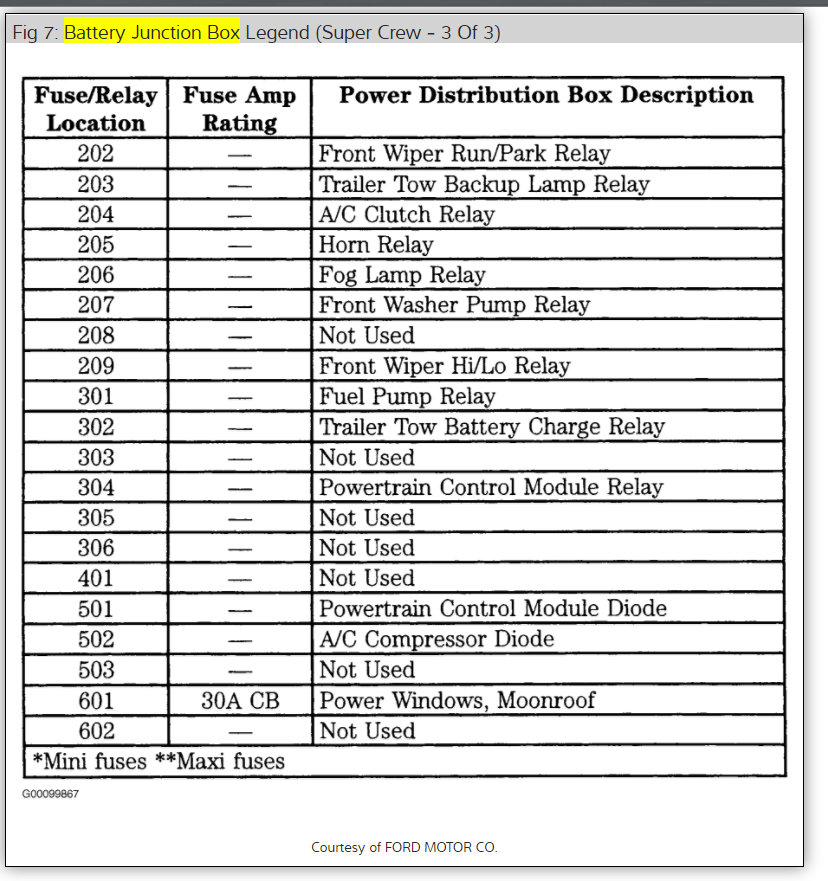

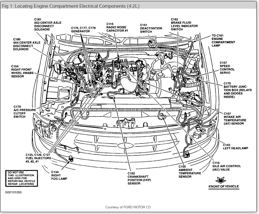

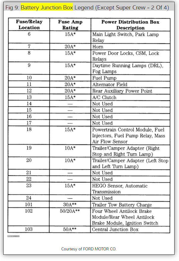

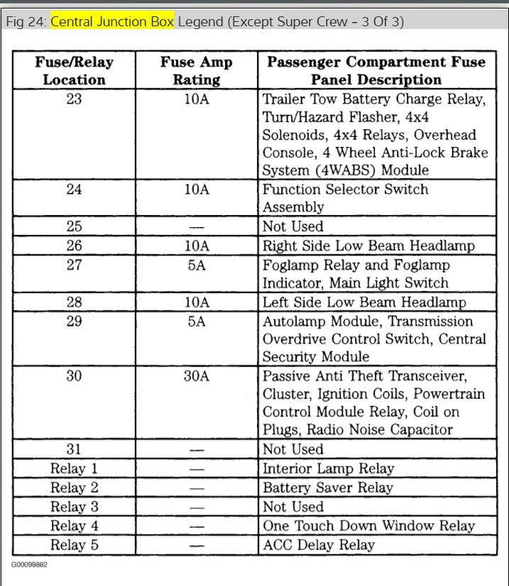

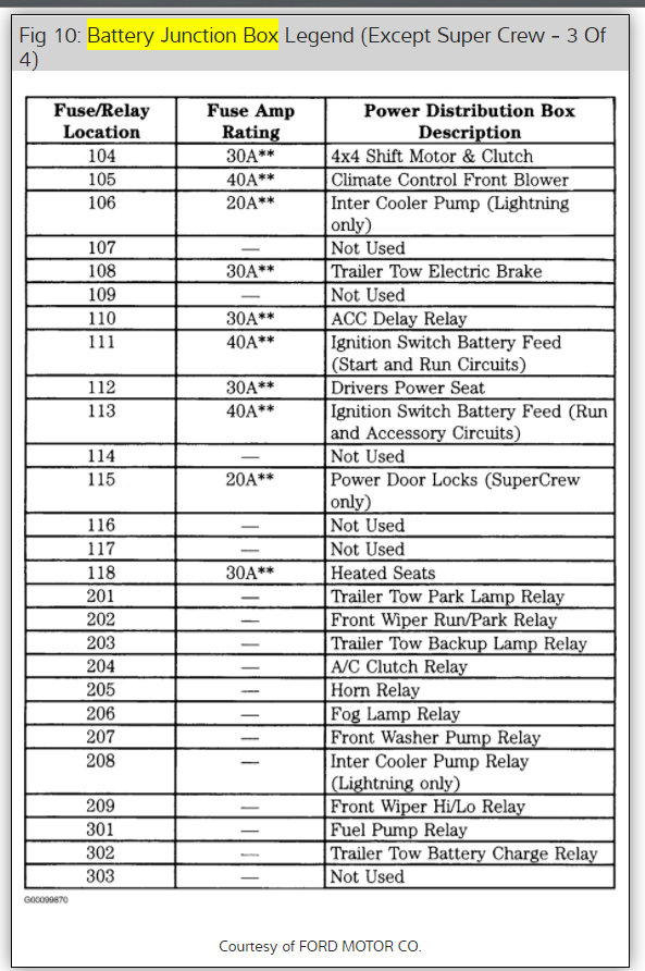

I was deployed for six months. I disconnected the negative cable on the truck. Was parked in my garage which has a small incline. Upon my returned I connected the negative cable and it would not start. The battery is fully charged but I think a blew some fuses
Apr 12, 2018 at 2:56 AM
It sounds like you had a voltage spike when you connected the battery I would start by checking the fuses.

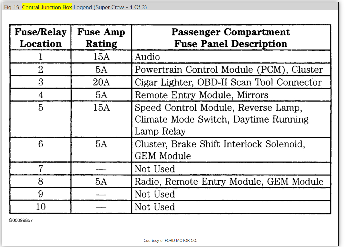

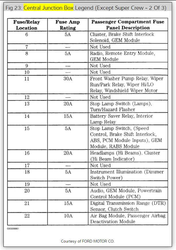

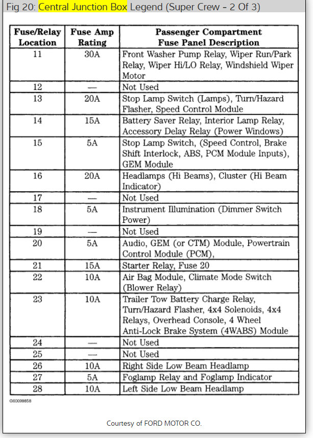

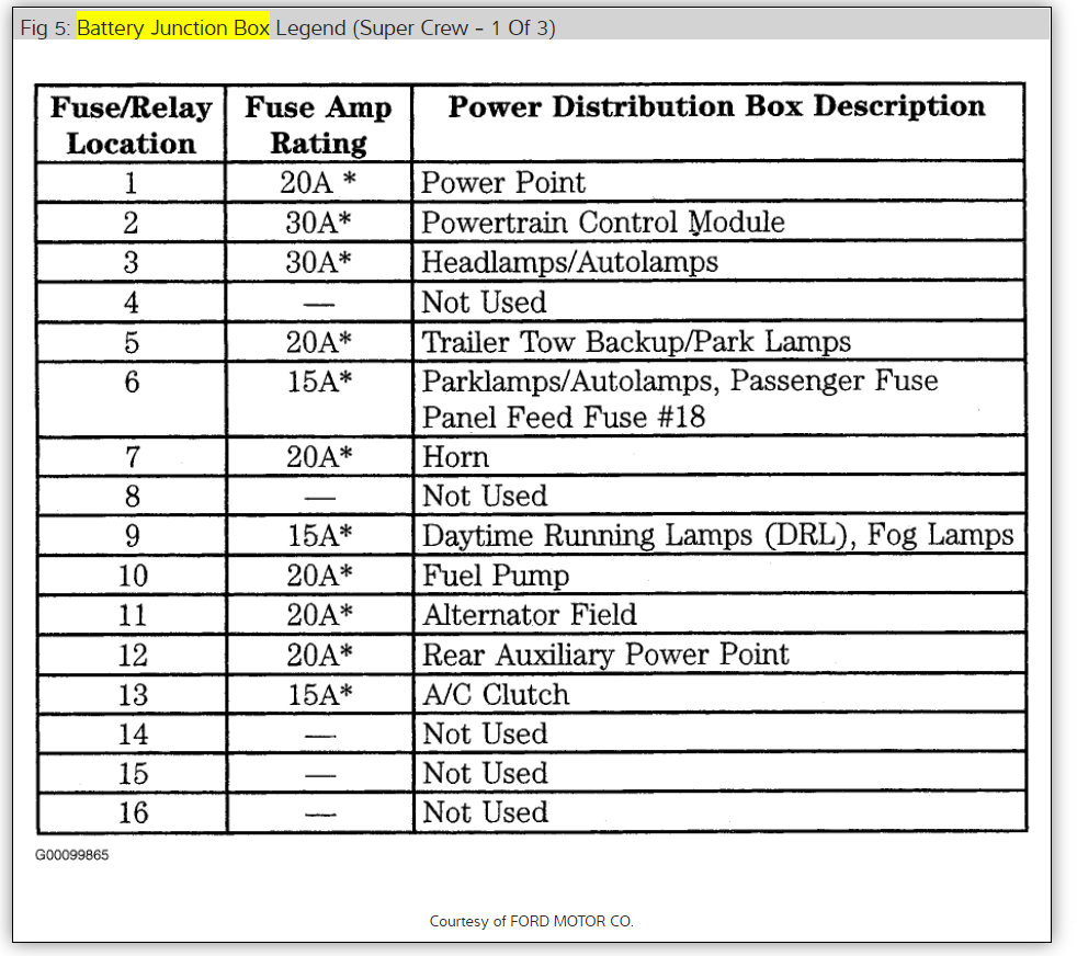

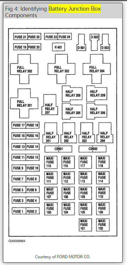

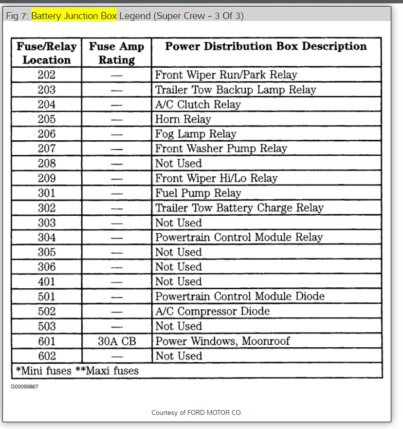

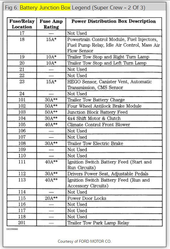

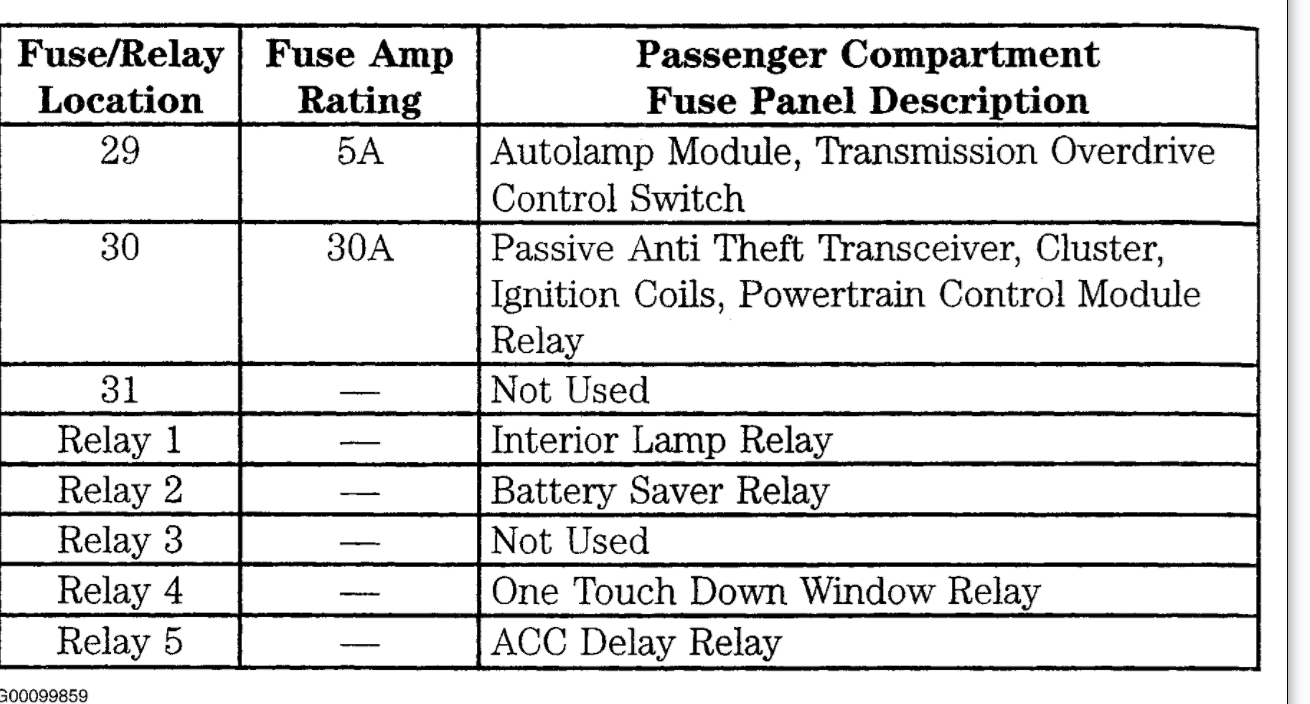

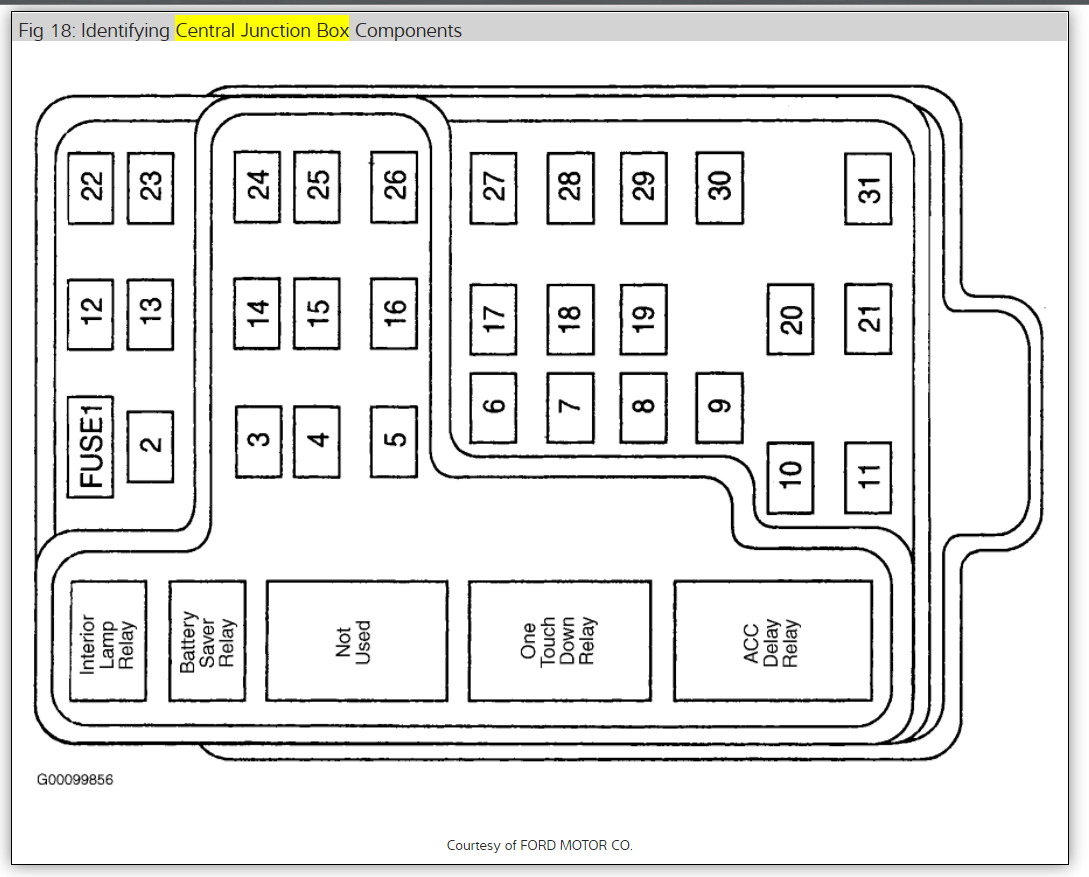

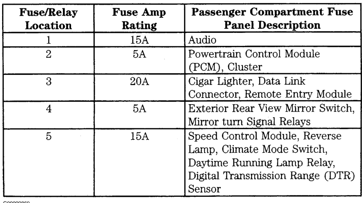

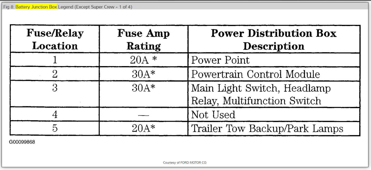

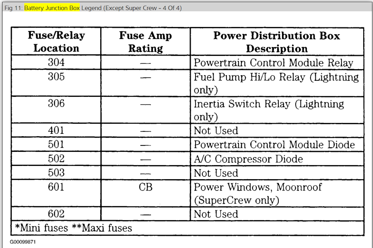

Below are the fuse locations.Check out the diagrams (below).Please let us know what you find. We are interested to see what it is.
