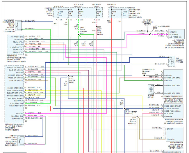

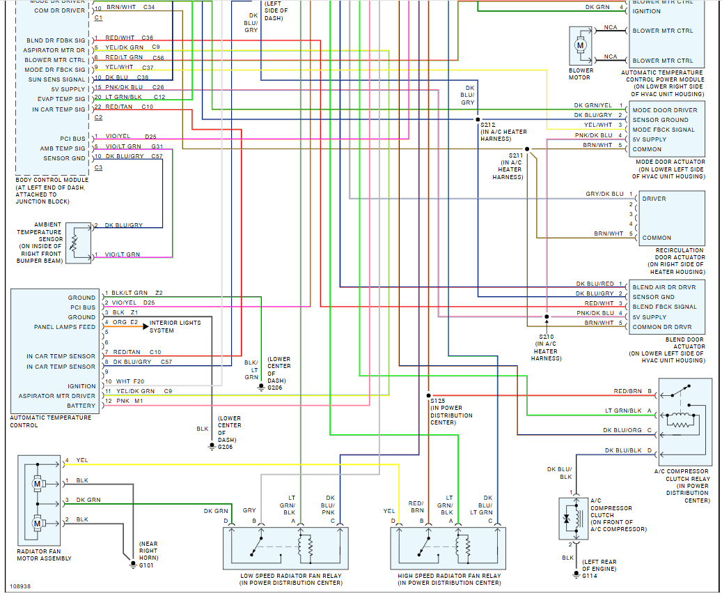

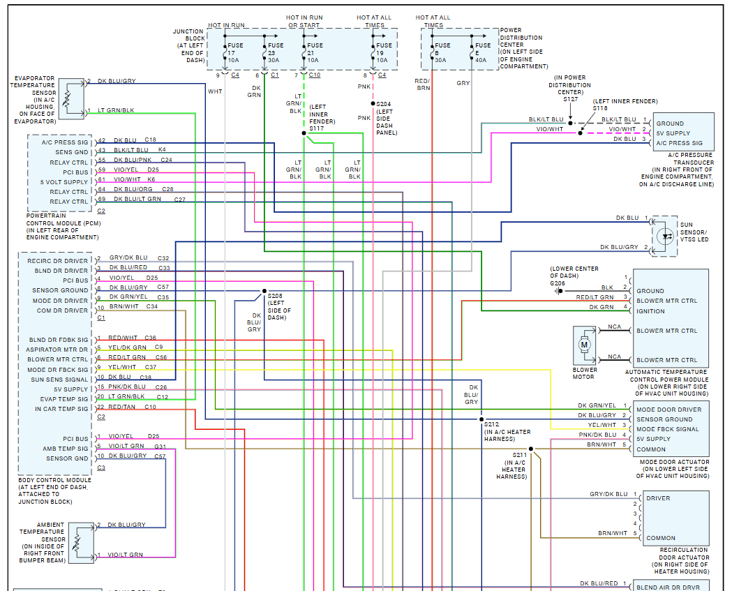

Hello Kevin, here is the HVAC wiring diagrams and a guide to help with the testing:

Hi Ken L, The wire diagrams are very helpful, thanks! Looking for info specific to the pcb components, aspirator motor and the rest. Need to troubleshoot what fails. Don't believe its a BCM issue. ATC has no relay. Rabbit hole...I know. If you can help, great, if not, that if fine, also.
