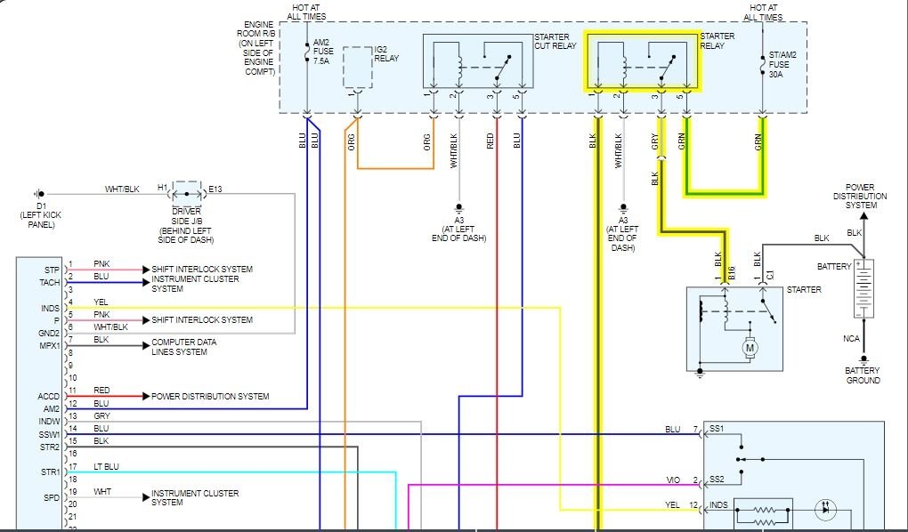

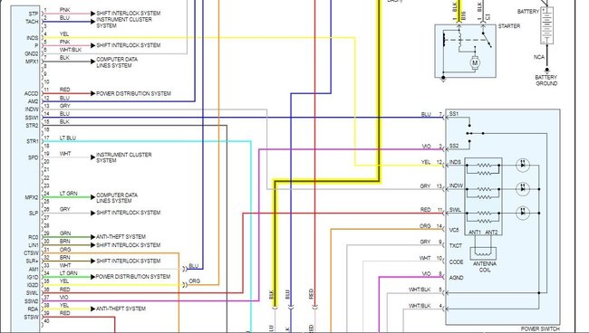

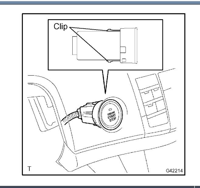

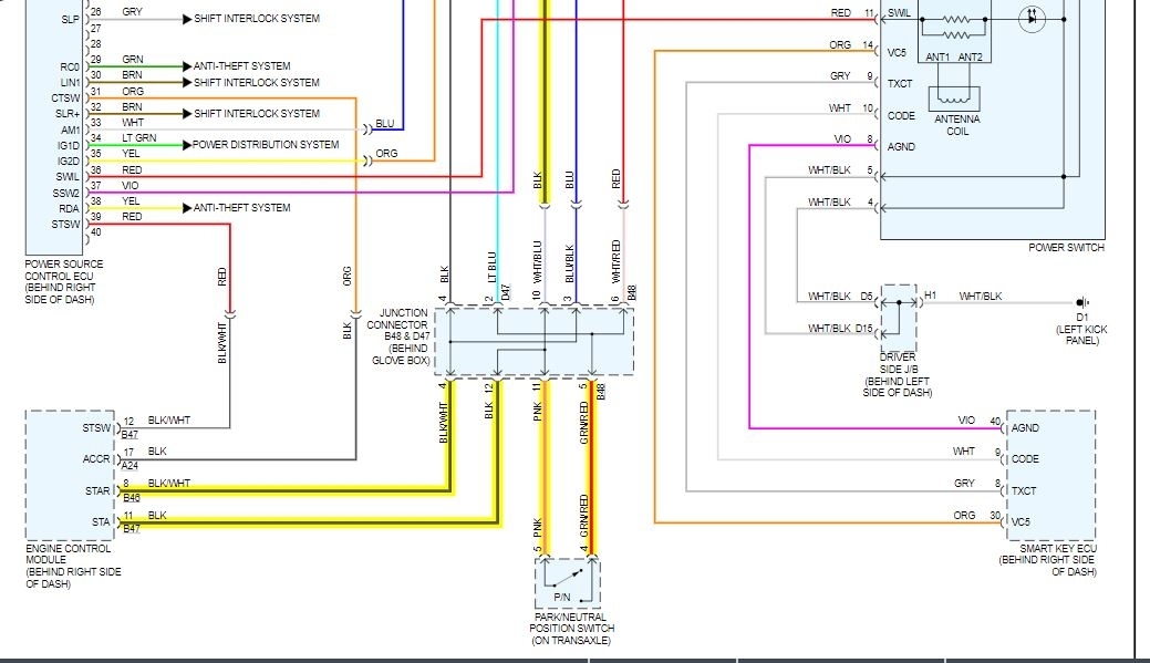

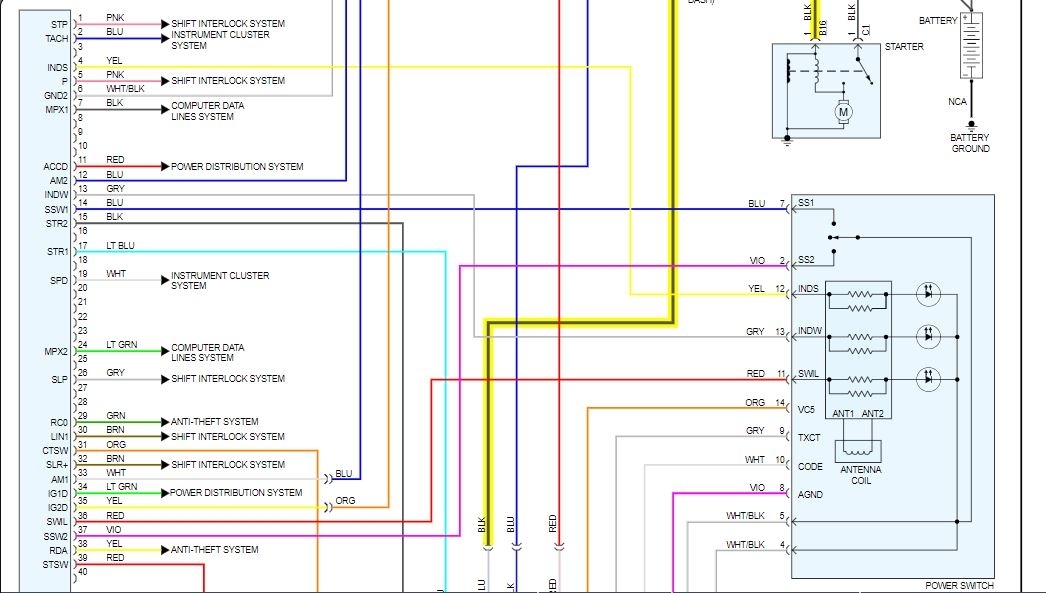

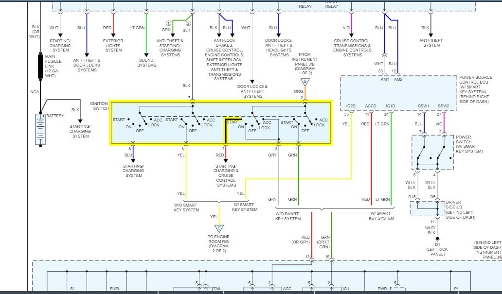

Good evening,
First, make sure you are in park or neutral.
When you push the start button, it sends a signal to the ECM. The ECM looks for a signal from the park/neutral switch and when it is right, it will energize the relay and send power to the starter solenoid.
Do you have a voltmeter to do some checks?
Jan 19, 2020 at 5:55 PM
EJAMES8
I tried to start the car in park and in neutral.. I can hear the fuel pump engine just no turnover from the starter.
Jan 19, 2020 at 6:26 PM
Okay, you will need to do some checks to see where the failure is located.
Do you have a test light or voltmeter for testing?
