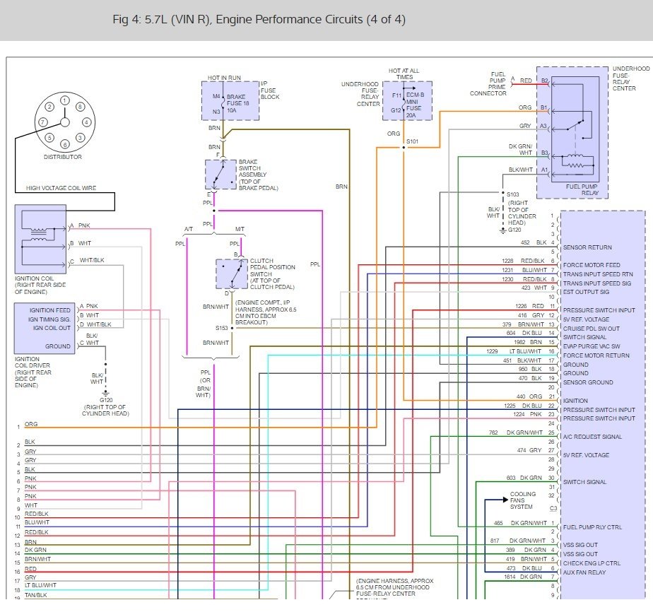

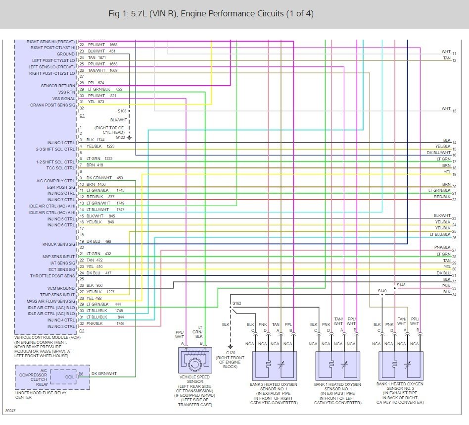

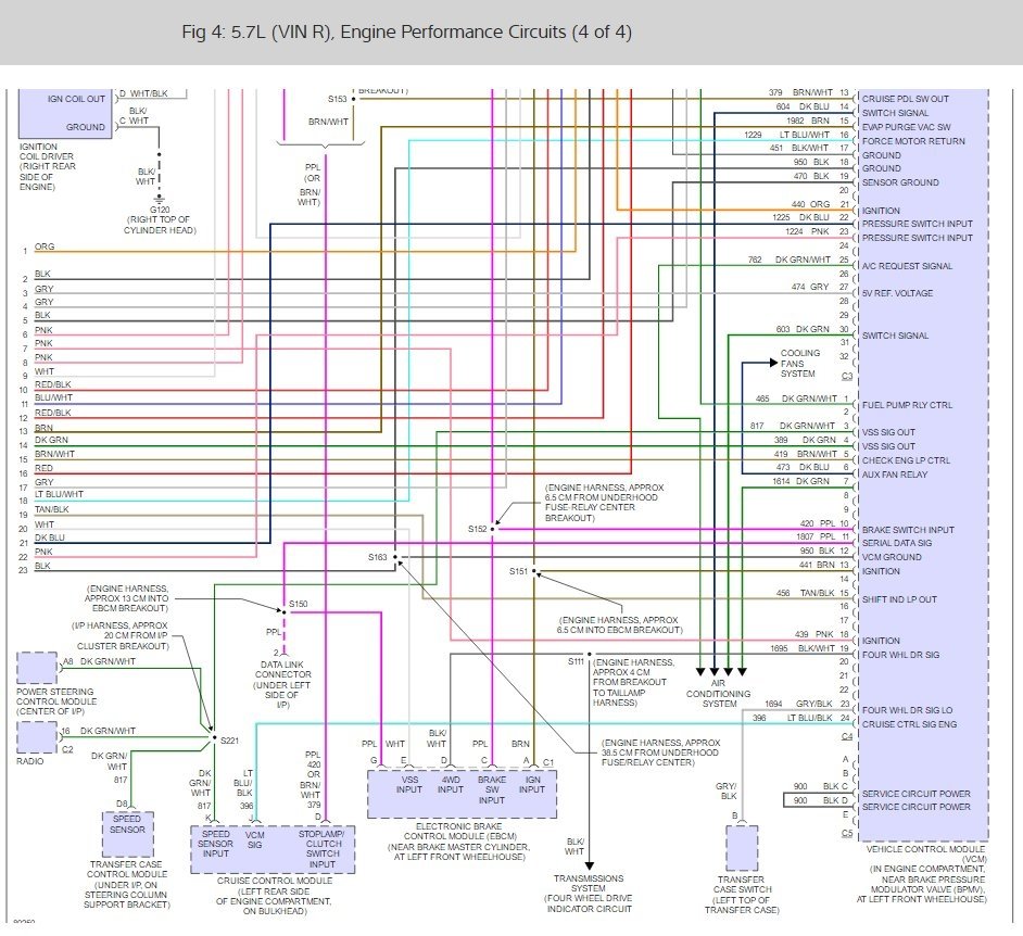

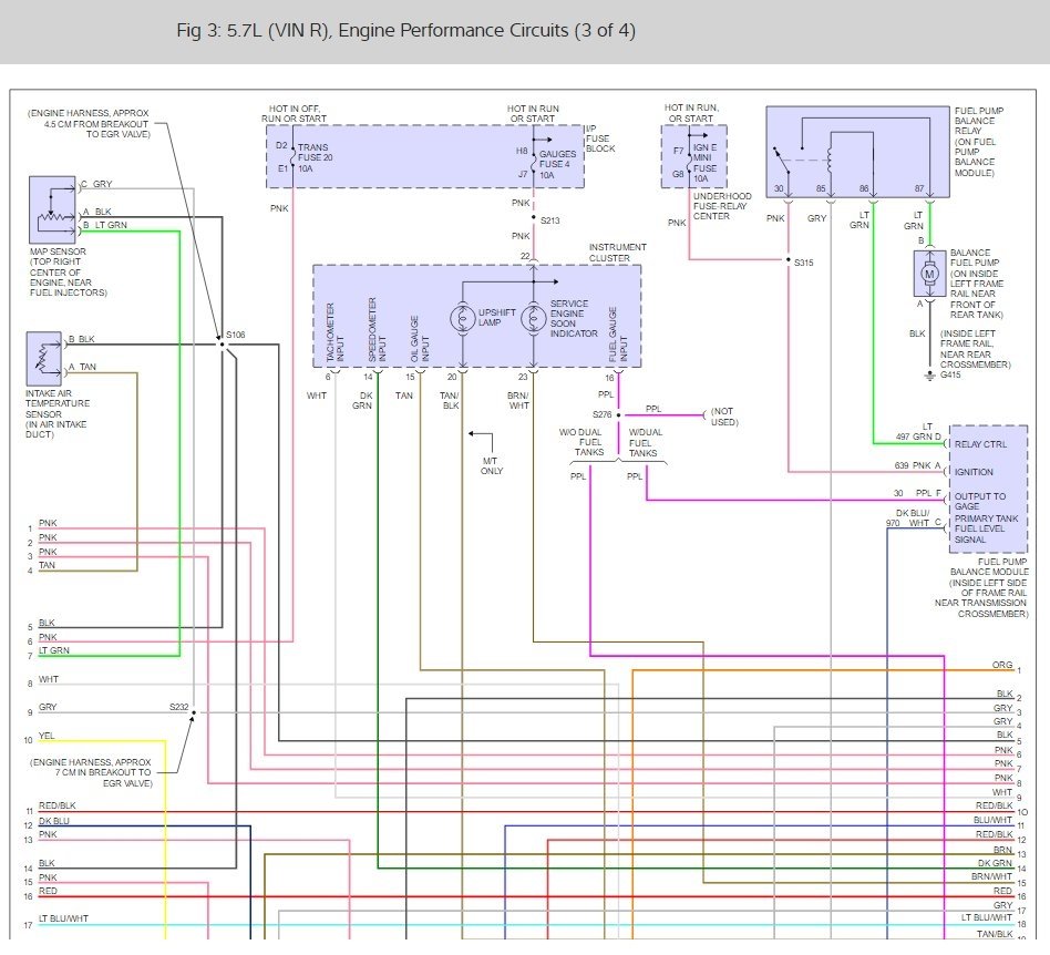

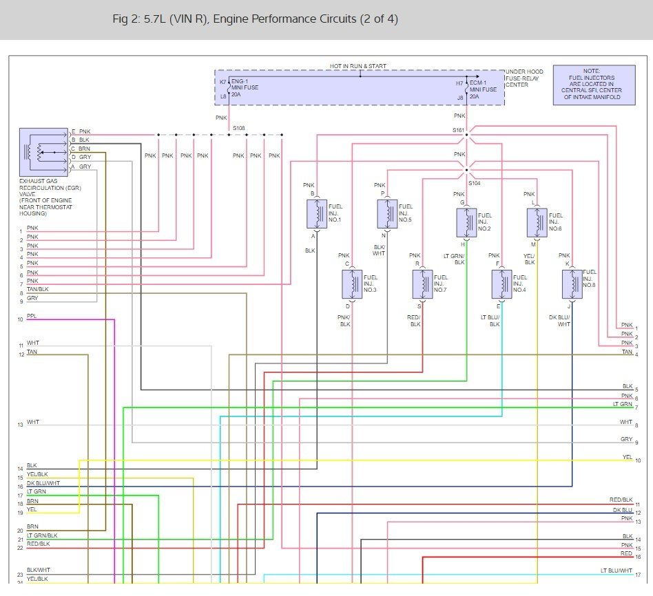

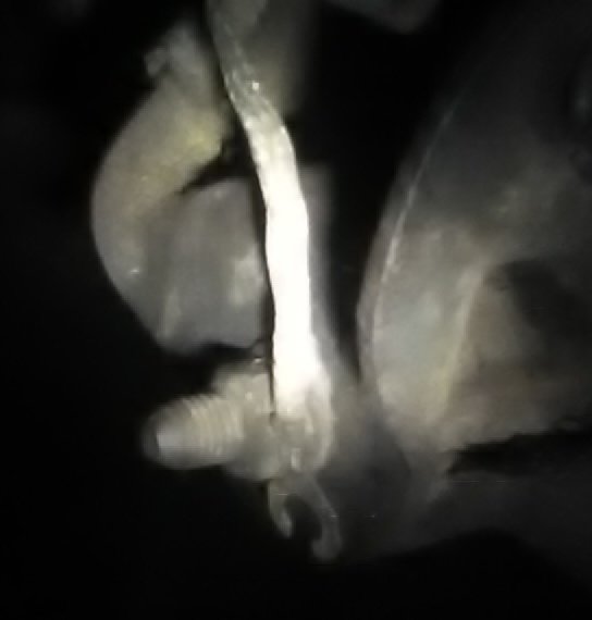

Okay well my truck as always fired right up however about month or so ago it started not firing right up. It would crank a little and the start so I thought maybe it was not getting enough gas so I replaced the fuel filter hoping that would help. It did not. The truck seemed to be running fine when driving down the road but when stopped or in park it was idling rough but never died. Came out of work the other morning to go home and when I tried to start it it cranked a little bit and then backfired and will not turn over at all. Please advise.
