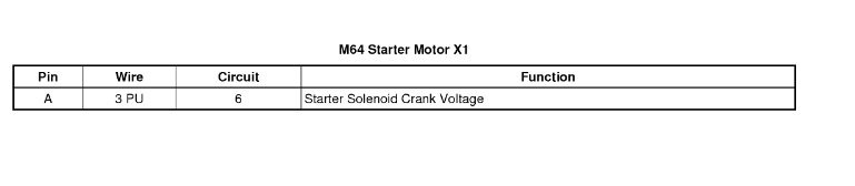

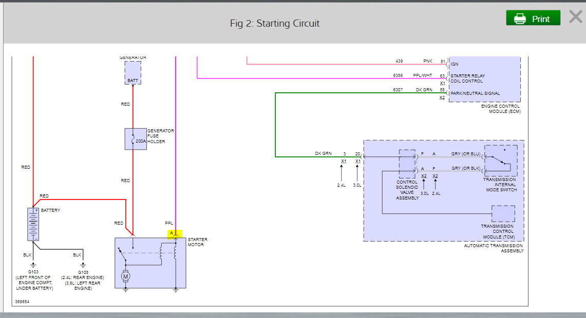

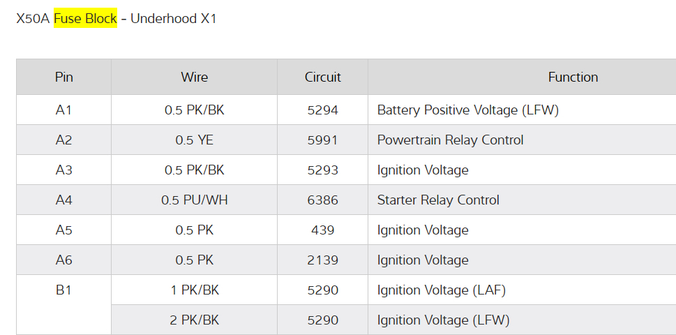

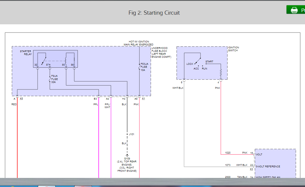

No water is in the cylinders or the oil. When we tried to restart it the starter attempts to engage. There is one click sound from the starter and then the dash lights go off for a few seconds. The engine doesn’t attempt to turn over. Took the starter to be checked and they said it was bad so I replaced the starter and it does the exact same thing.
