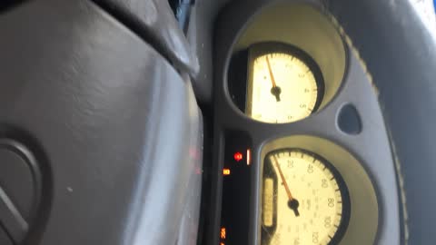

In the video you shot it appears that the check engine light is on indicating there are trouble codes stored in the computer as would be expected.
Here is a link to our tutorial on checking the codes: https://www.2carpros.com/articles/checking-a-service-engine-soon-or-check-engine-light-on-or-flashing
If you could retrieve the codes and let us know what they are that would be the best place to start. Please let us know what you find and we will be more than happy to help you further and thank you for using 2CarPros!
