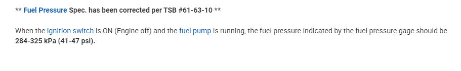

I would start by checking the fuel pressure. Low fuel pressure will cause this as well as a clogged filter.

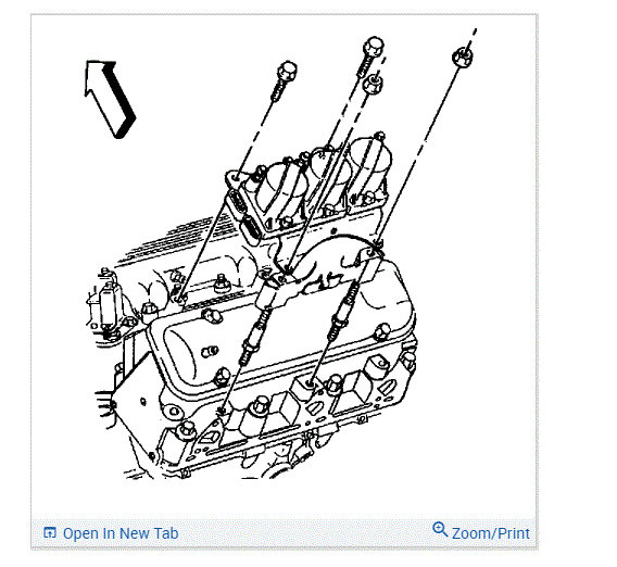

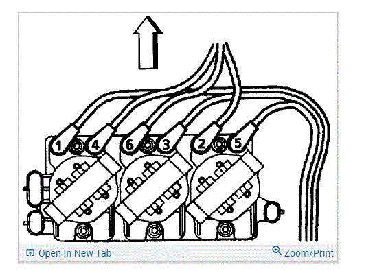

The other possibility is the ignition control mode.
