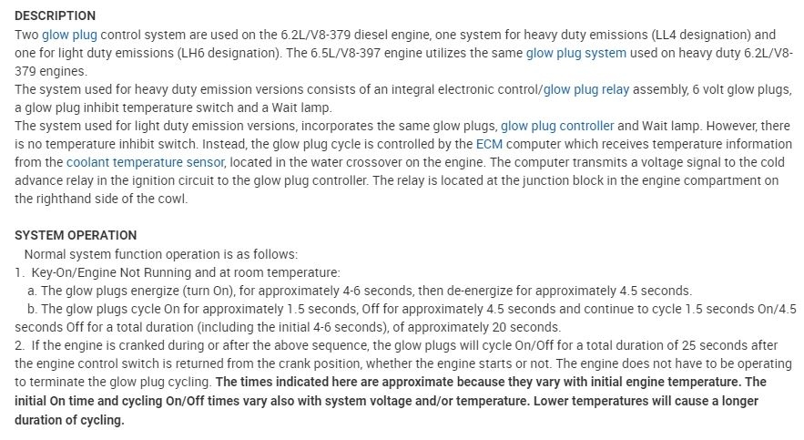

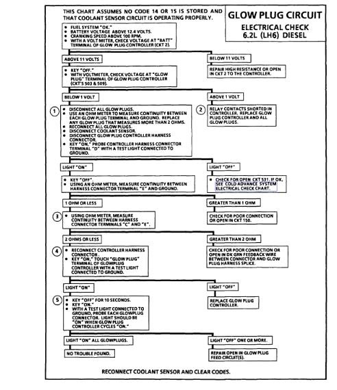

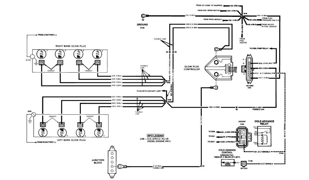

The system is controlled by the glow plug module. it will turn on and off the glow plugs. The amount of times depends on the signal from the temperature sensor. The colder the motor, the more time the plugs are used.

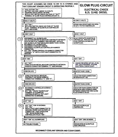

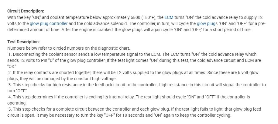

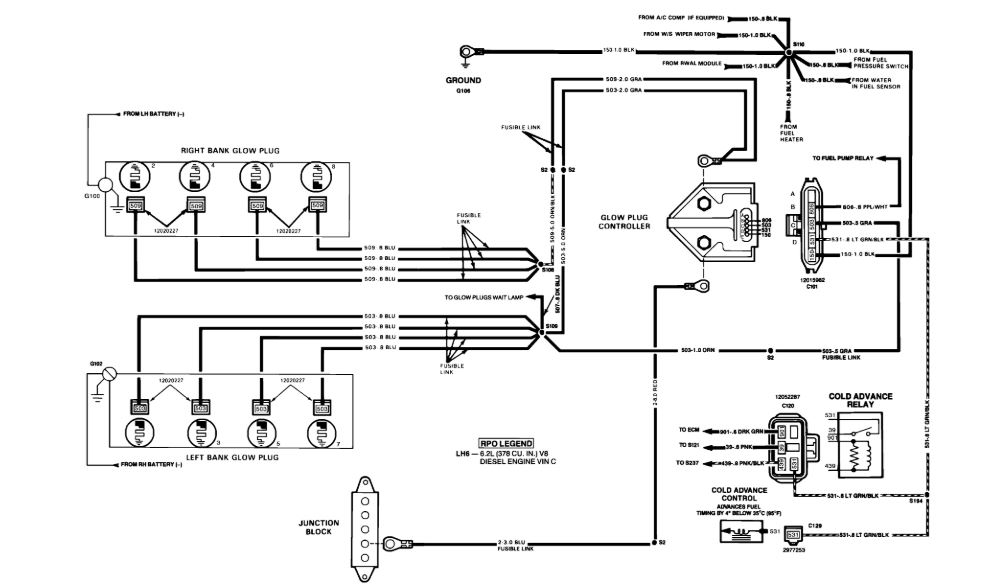

Did you verify power to the glow plugs?

A common issue is glow plug failure. If one short out, you need to replace all 8 and the controller. Very common.
