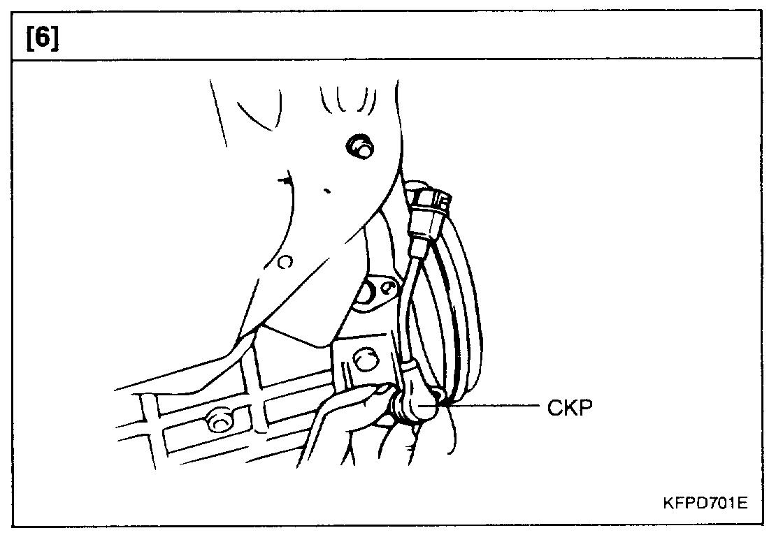

Based on your description, it sounds like the crankshaft position sensor may be bad. Take a look at this link:
What I suggest is to check for spark to the plugs when the engine won't start. Here are easy to follow directions on how that can be done:
If you find there is no spark, the sensor is my first suspect. Here are general directions for sensor replacement:

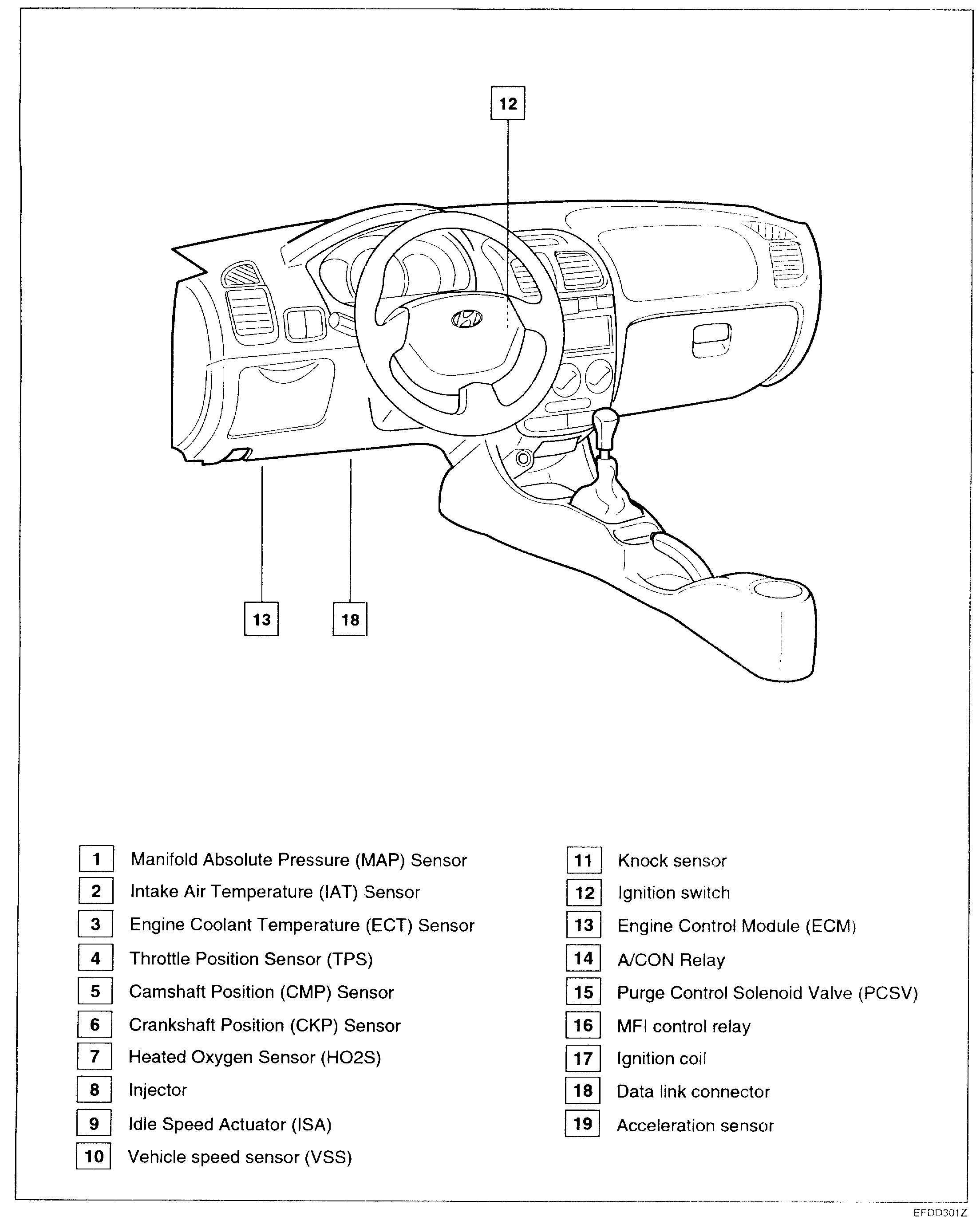

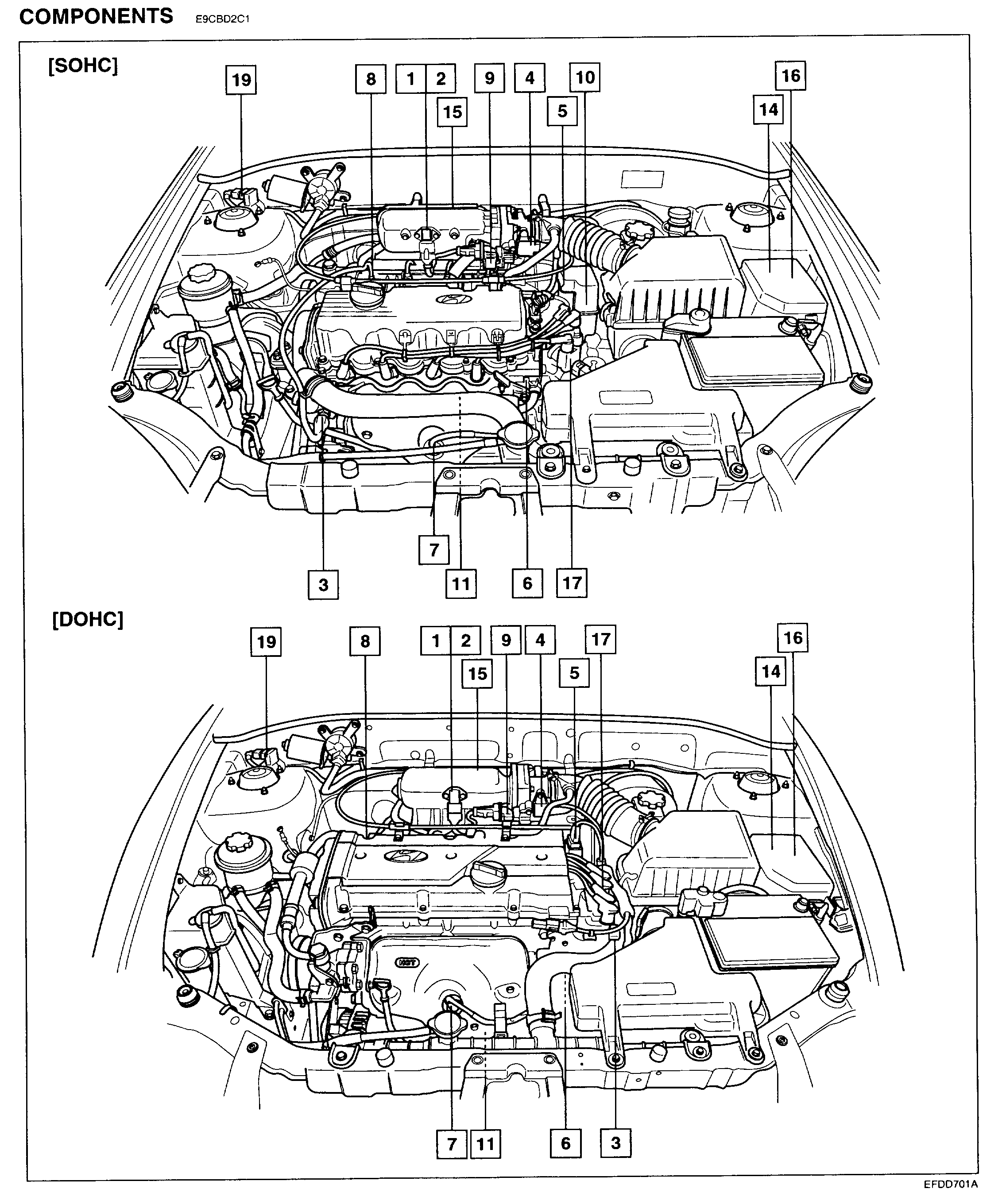

I have attached sensor location pictures.
