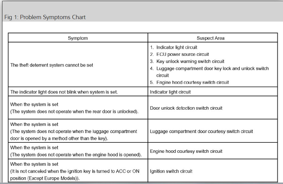

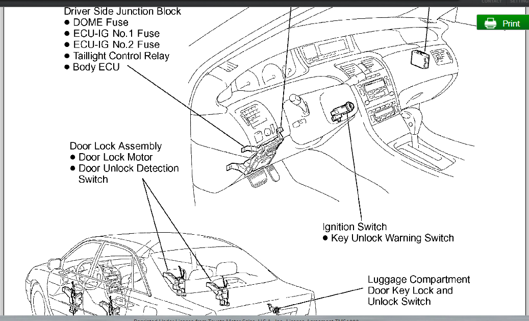

Turns over but won't start. I think it's the anti theft system disconnected battery.
Mar 31, 2019 at 2:35 PM
SCGRANTURISMO
  • 4,897 POSTS

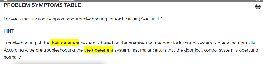

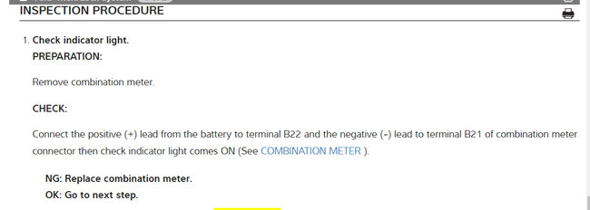

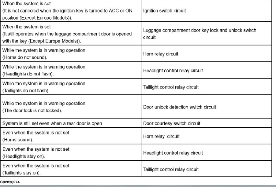

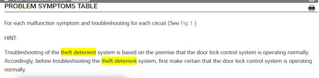

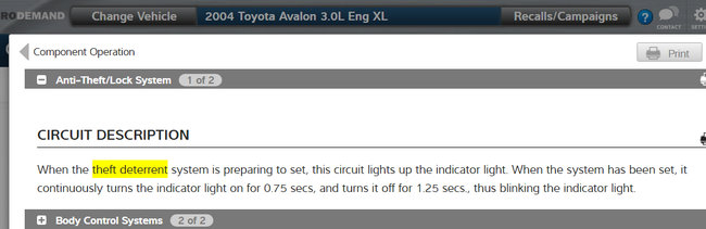

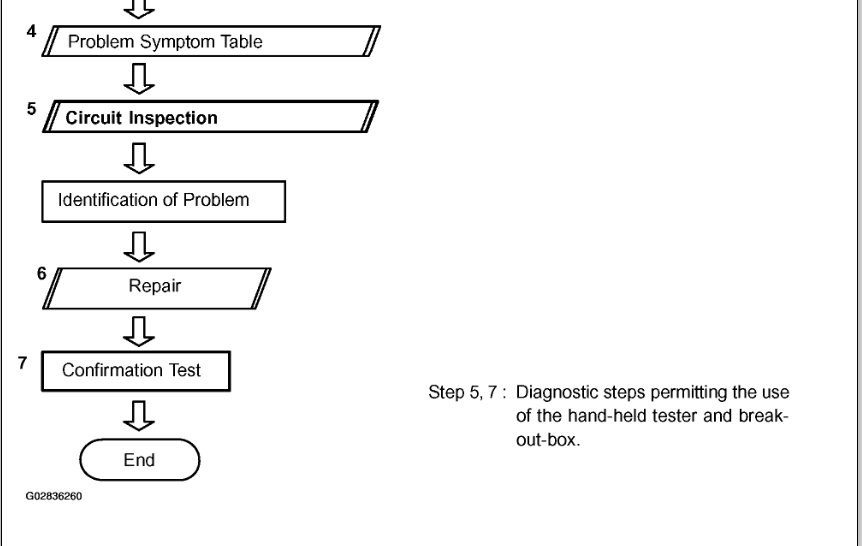

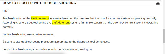

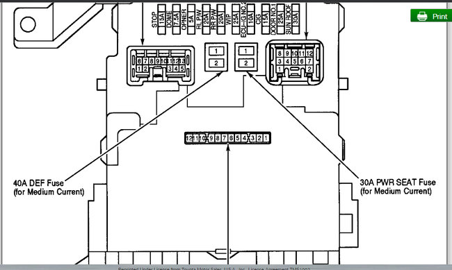

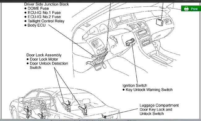

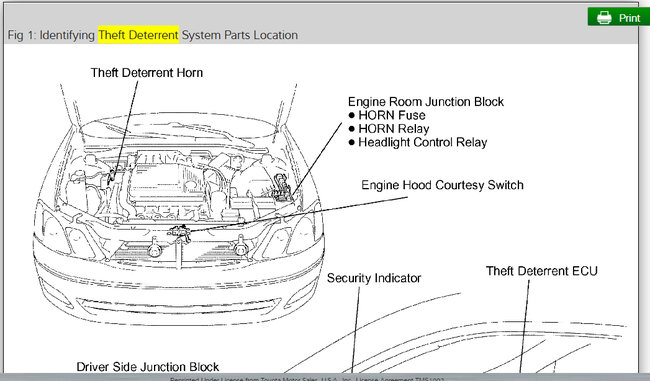

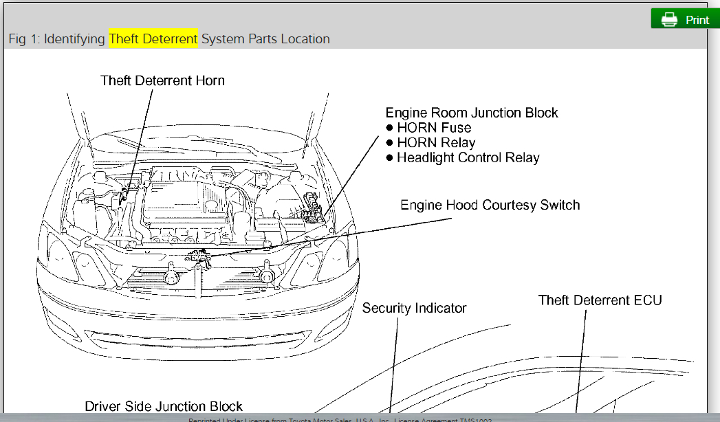

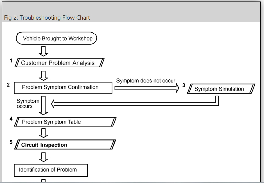

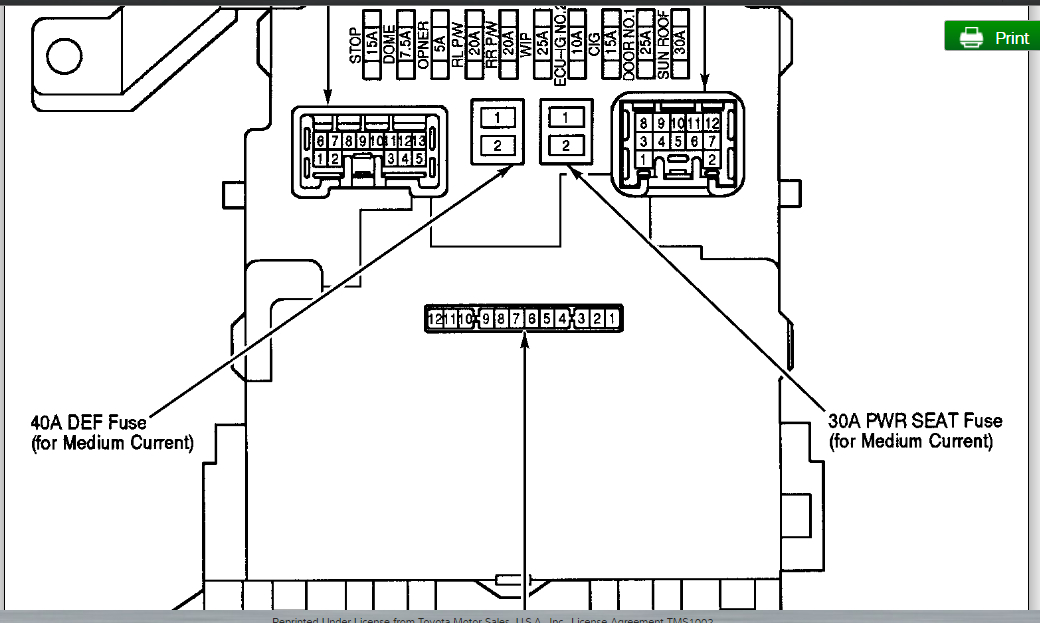

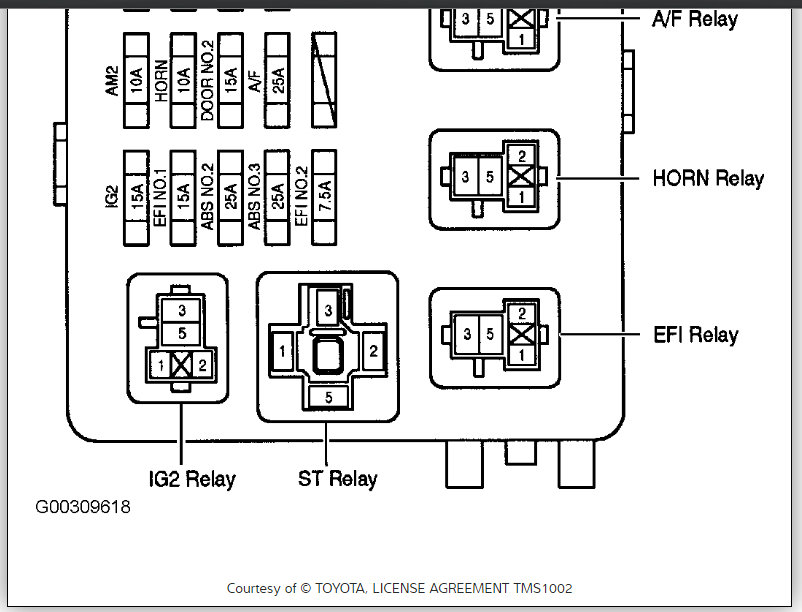

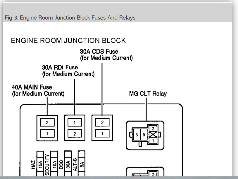

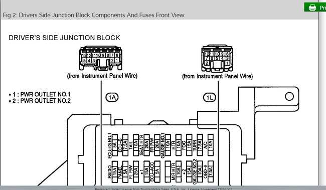

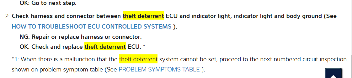

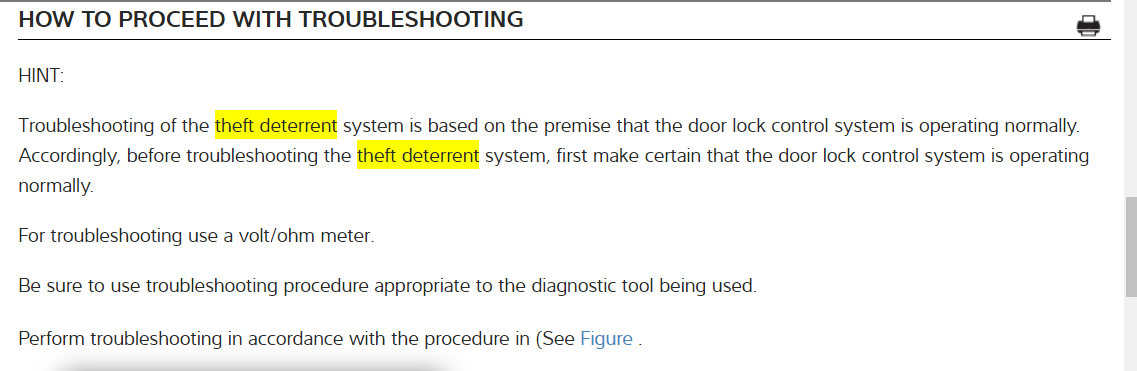

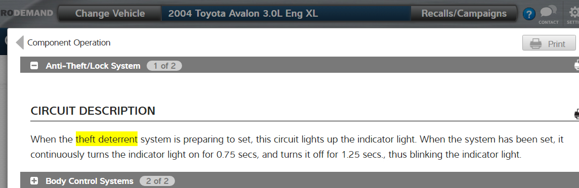

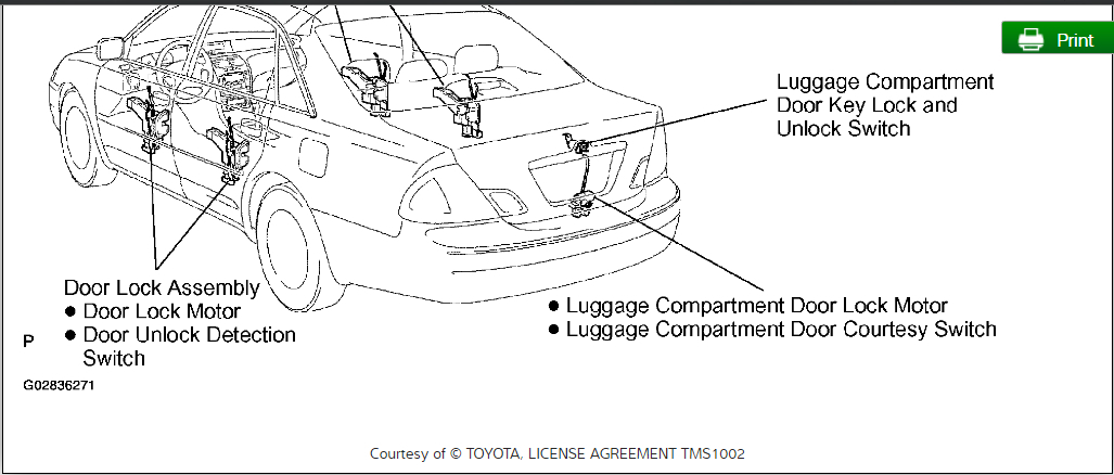

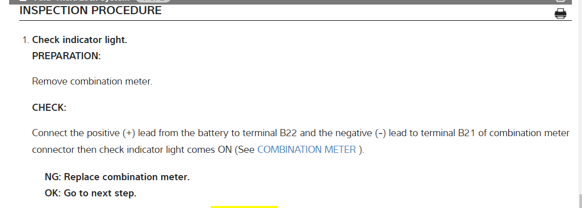

This could be a problem with your combination meter. I have included for you in the diagrams down below information and factory diagnostic troubleshooting guides for your vehicle's theft deterant system. Please go through it and get back to us with what you find out.
