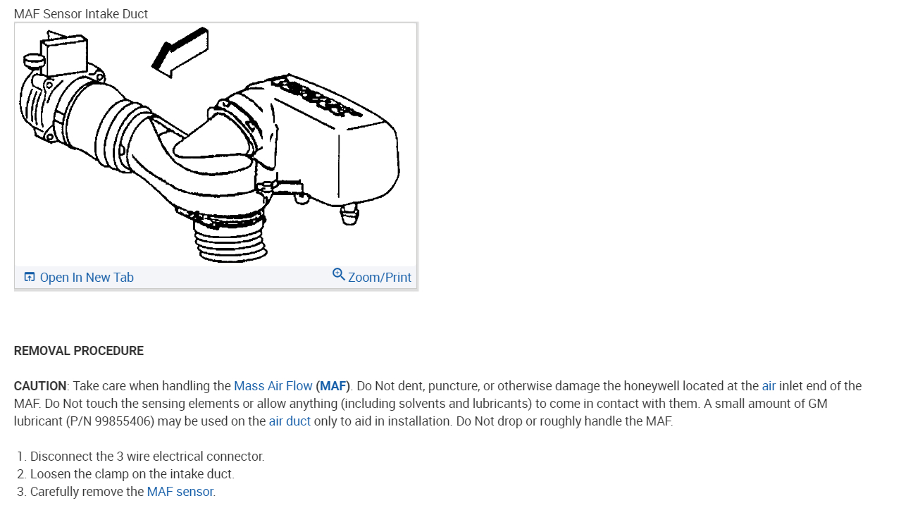

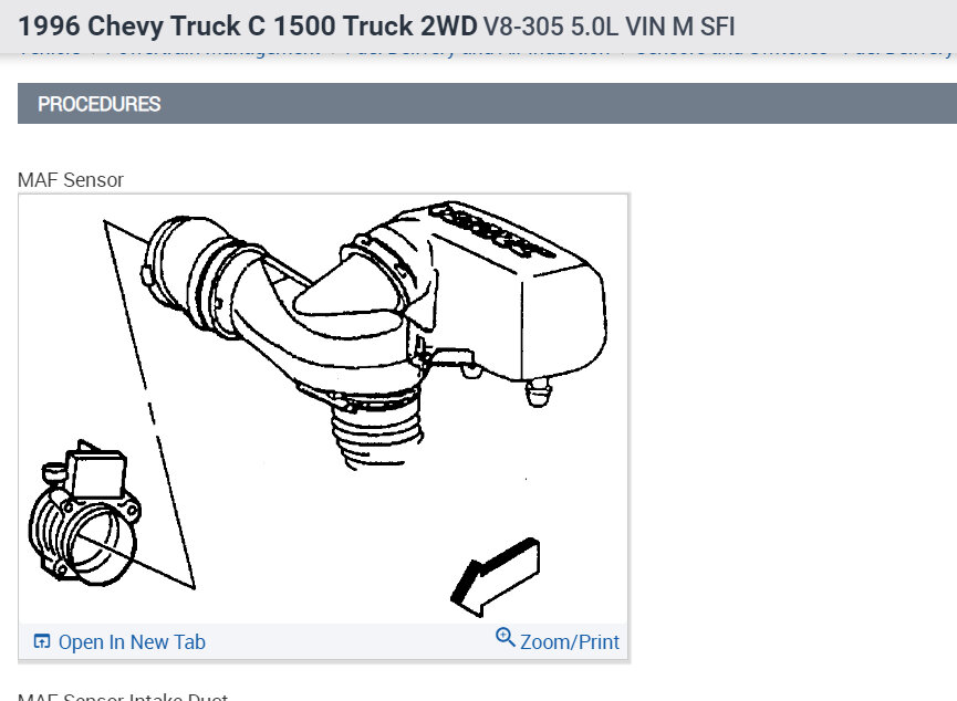

The only codes that can affect the engine running is the MAF I would get a new one and install it. here is how in the diagrams below.
