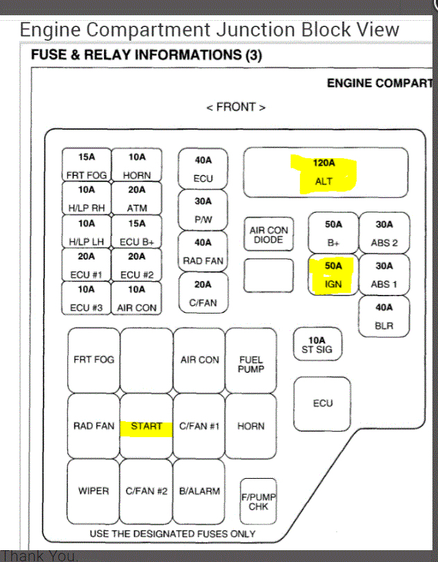

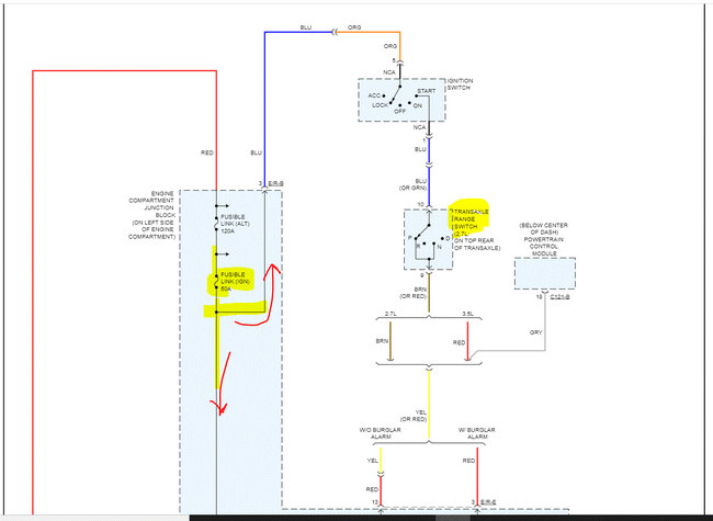

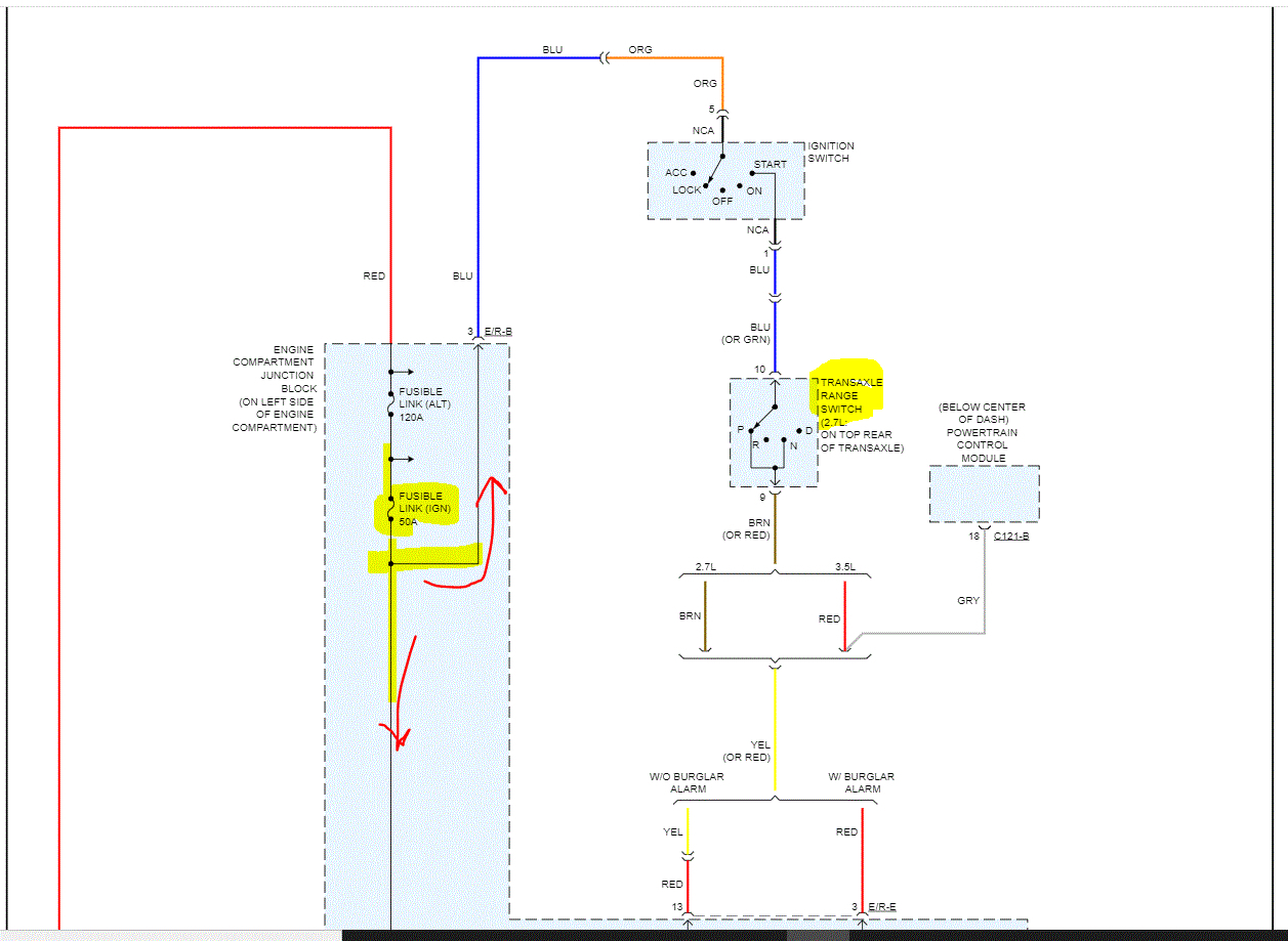

First, I attached the wiring schematic below for the charging system. If you look at pic 1, I highlighted two things. First, the park/neutral switch. As a test, see if the vehicle starts in neutral. If it doesn't, go to the under-hood fuse box. In pic 1, I highlighted the ignition fusible link. Pic 3 shows the location of the link in the fuse box. I need you to check if it's good. In addition, confirm there is power to and from it. Here is a link you may find helpful:

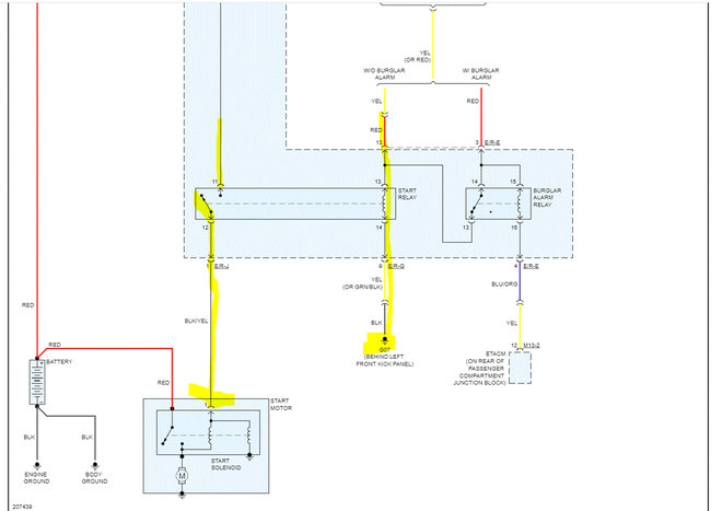

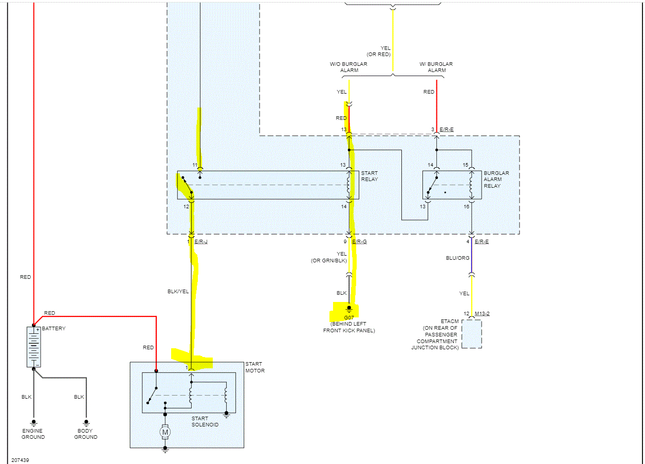

If you have power and it's good, then we need to check the starter relay. I highlighted it in pic 3 also. If there is another relay with the same part number, switch them to see if it makes a difference. If there isn't, here is a link explaining how to test a relay:

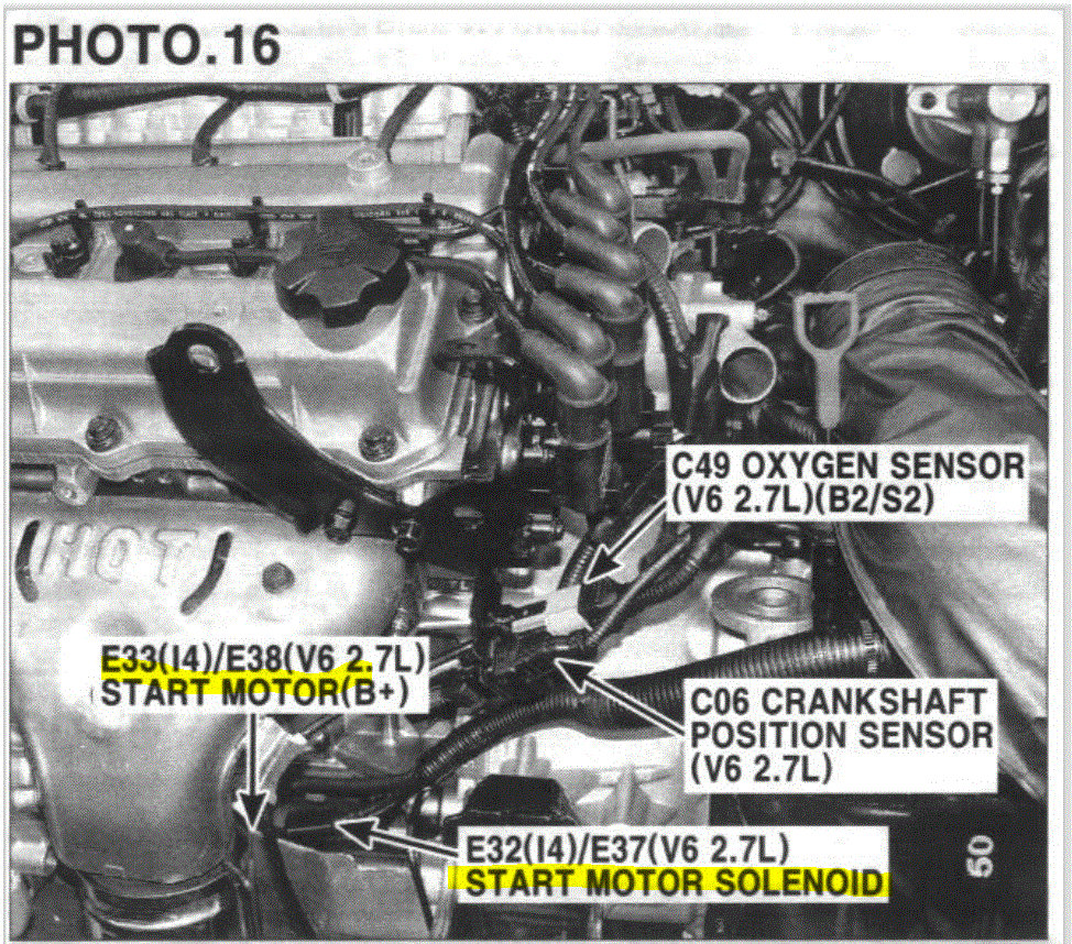

If the relay checks good and all power supplies are good, then locate the starter solenoid. See pic 4. On the starter, there will be a heavy gauge red wire. It is straight from the battery and has 12v at all times. Additionally, there will be a black wire with a yellow tracer which is a smaller wire. That is the trigger wire. It should only have 12v when the key is in the start position. Have a helper turn the key to the start position while you check that wire for power. If there is power, the starter is likely bad.
