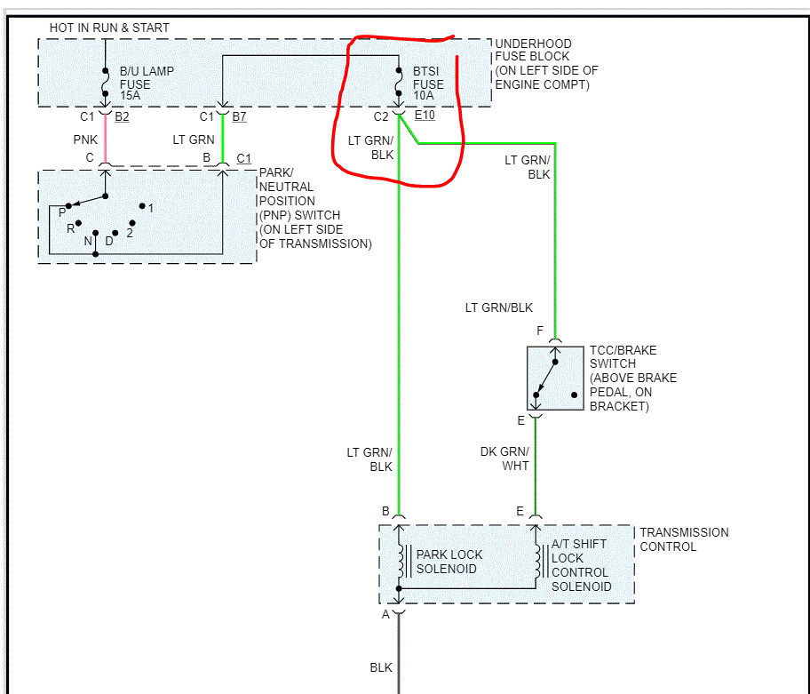

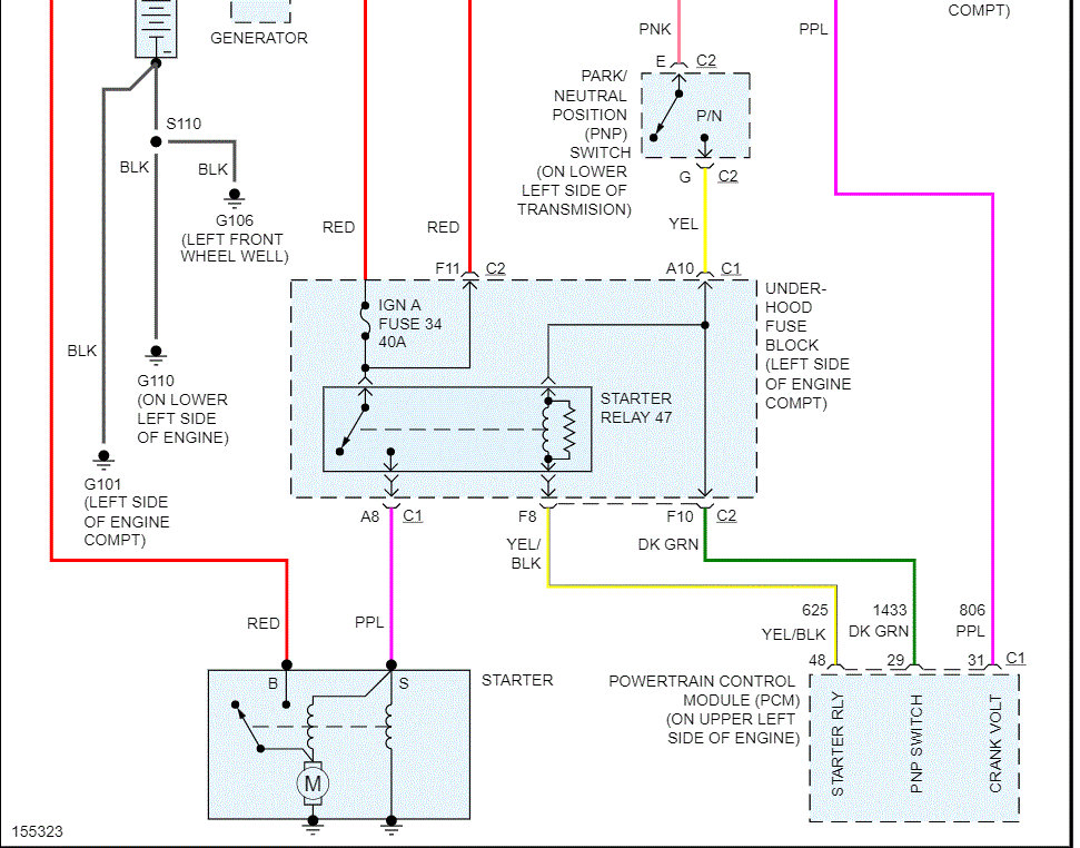

I attached two pics below. The first one indicates three fuses I need you to check. The second pic is a continuation of the starting system schematic so that you have the complete schematic.

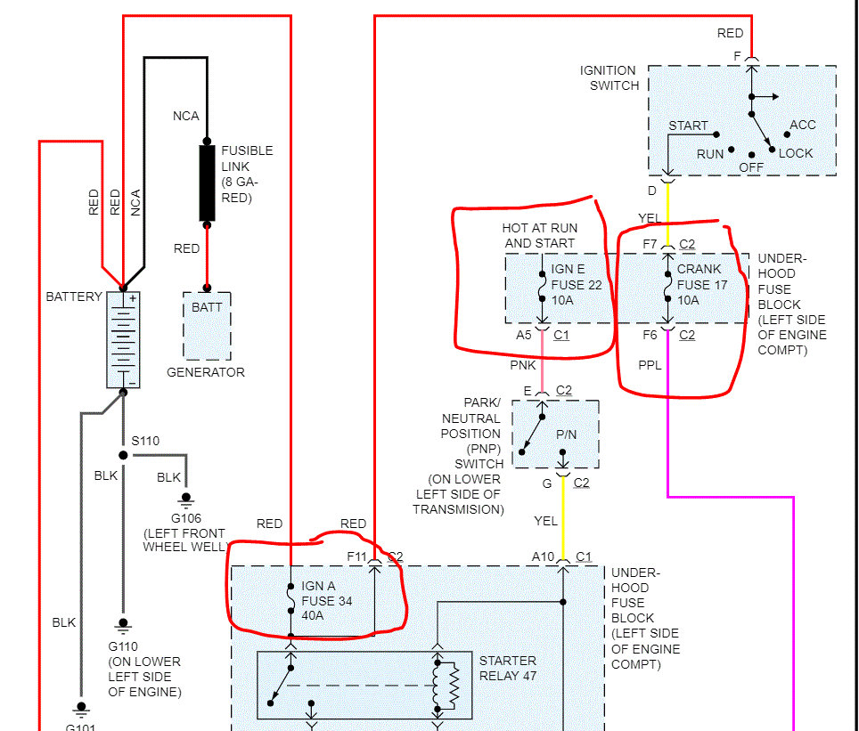

Also, I need to know if the brake lights are working and if you checked the park interlock fuses. See pic 3.
