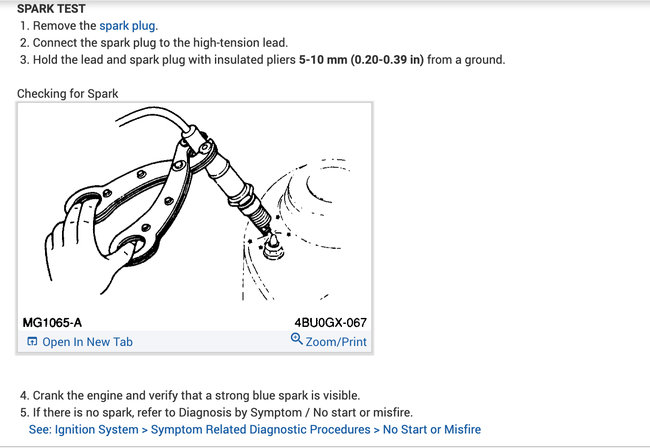

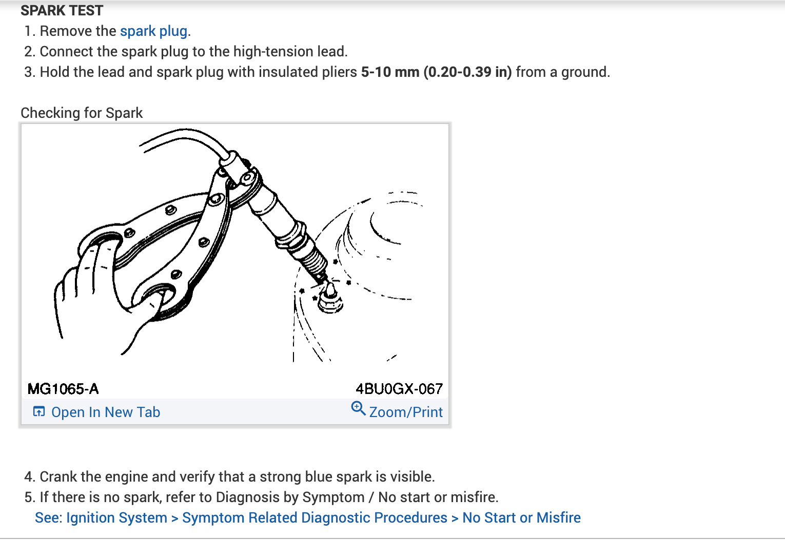

Just to be sure i have attached the process for checking for spark below.
If you have verified that you have no spark there are few things to try, starting with checking fuses.

I have already checked for spark.
What do I need to check next?

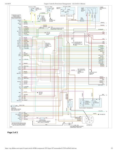

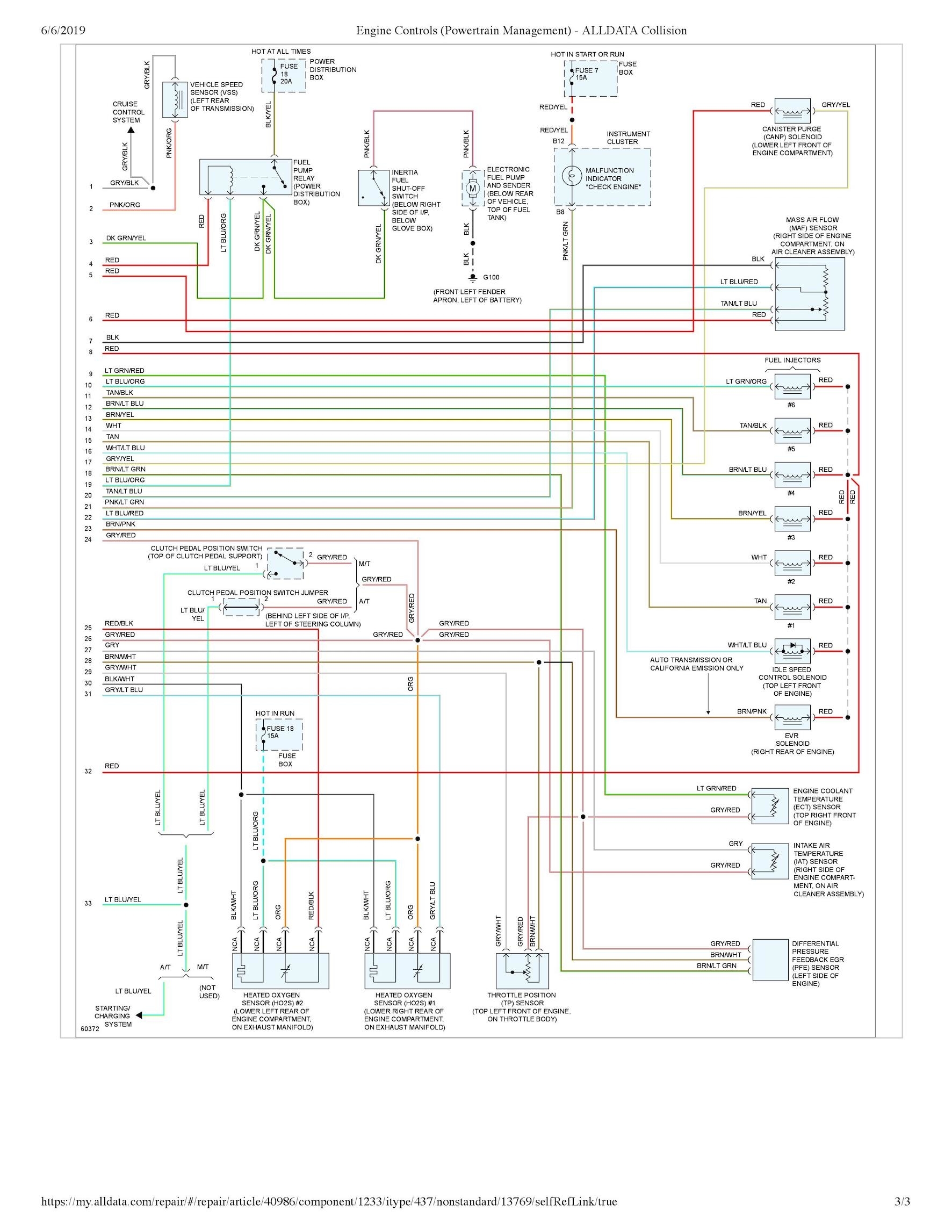

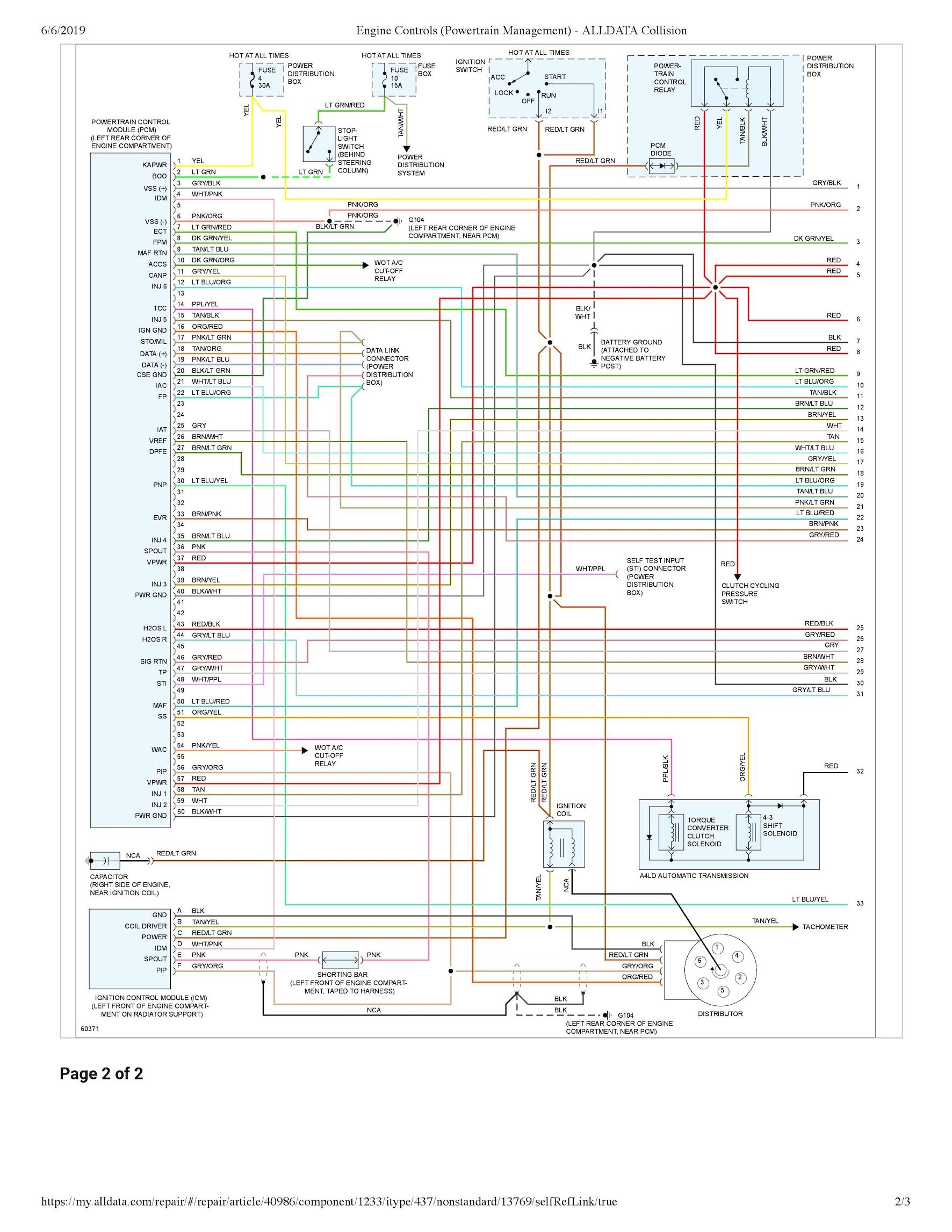

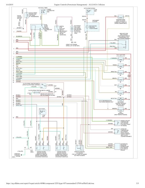

I have attached the engine controls wiring diagram below.
Things to check first would be that fuse 4 (30A) in the under hood fuse box is in tact and has 12V at both sides.
I would also check all other fuses in the under hood fuse board as a precaution while you're there.
Guide to check fuse below:
https://my.alldata.com/repair/#/repair/article/40986/component/323/itype/32/nonstandard//selfRefLink/true
Also check battery connections and engine ground wires to ensure nothing is loose.
If this is okay the next thing i would do is to remove the distributor cap and check the condition of the cap and rotor contacts. Make sure the rotor is seated correctly and the cap is fitted correctly.
Check the connections of all of the plug wires and the lead from the ignition control module to the center of the distributor.
Check connections on the Ignition control module (ICM) and Power train control module (PCM).
The ICM is mounted to the to the radiator support, left front of engine compartment.
PCM left rear corner of engine compartment.
If all connections appear okay and you have power at the fuse you will need to check for voltage at the ignition coil and at the ICM.
Do you have access to a multi-meter or test light?
Regards, Joe
