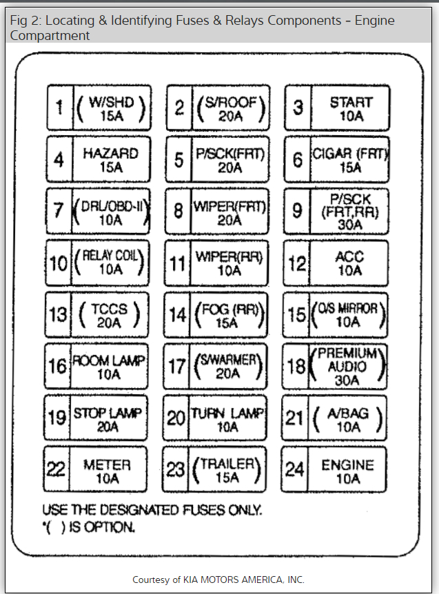

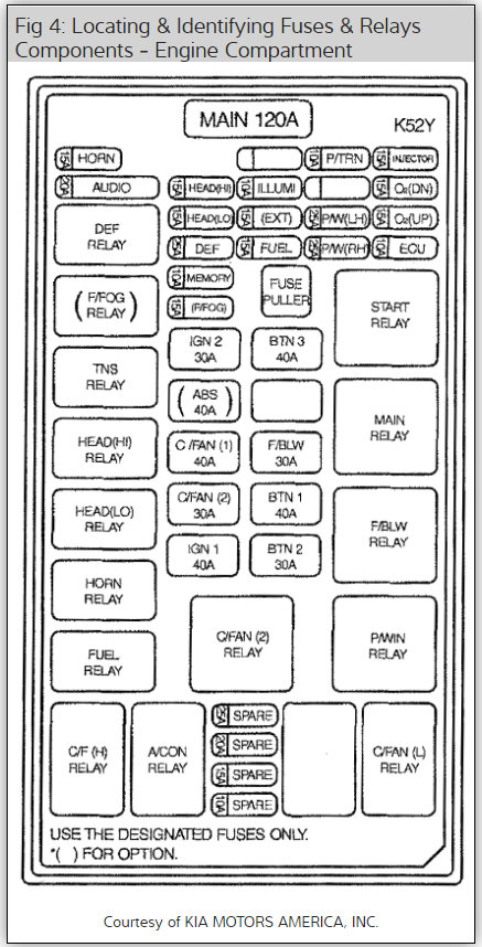

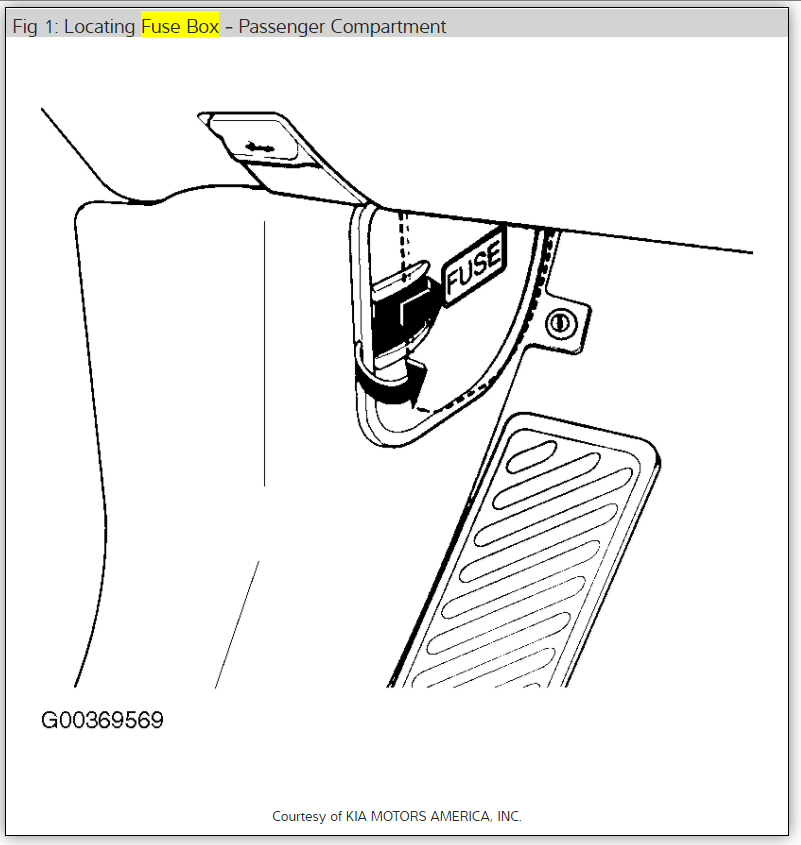

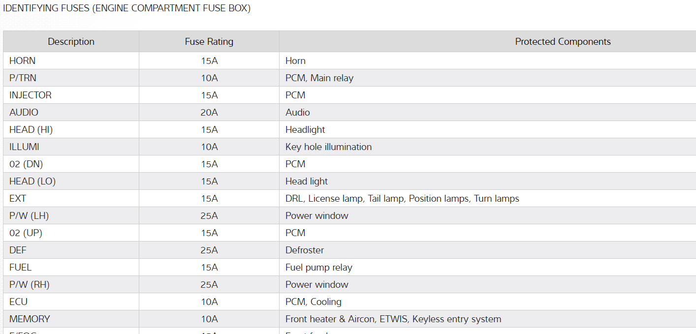

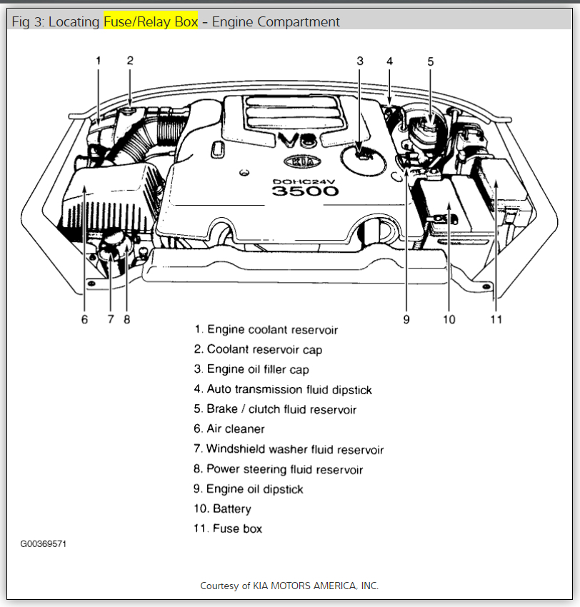

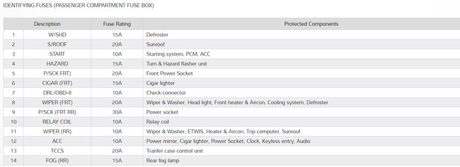

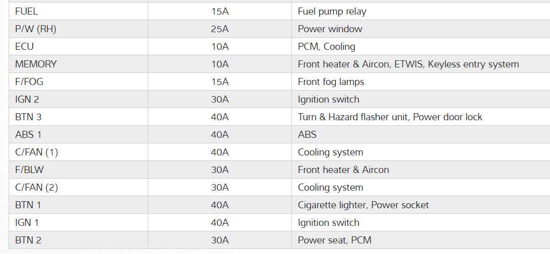

Can I ask if then security light is flashing when you you are trying the crank the engine cover? If not then I would check the starter relay.
Here is a guide and the relay location and you should check the fuses as well:
and

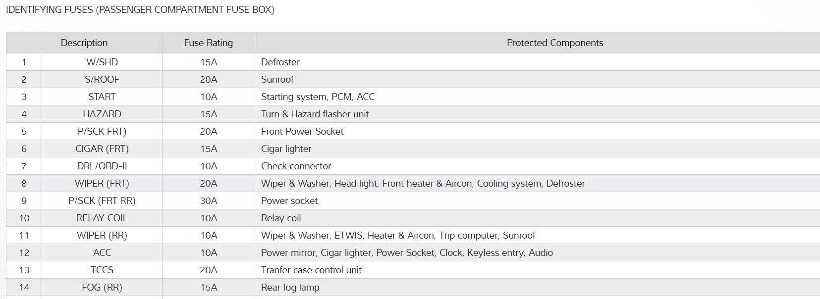

I have not heard of a rigged way which I wouldn't do anyway. The next test is a simple one let use a test light and problem the trigger wire/terminal (small) at the starter to see if it gets power when the key is in the start position.
Here is a guide look toward the bottom.
