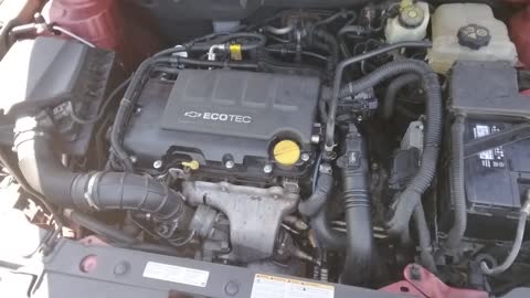

Hello Ken, I took a video for you. Also, it's getting gas. I checked the bleeder valve. It seems like it's electrical. Not getting fire. I appreciate your help and look forward to your reply. Attached is the video.

Yep, there is no need to check the fuses or relays, that engine is no good. Thanks for the video, it helps. You will need a used/rebuilt engine, sorry about that.
