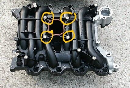

Hey Joe, I tightened intake with a regular 3/8 socket wrench because I don't have a torque wrench, but I did take the throttle body off today and noticed that the 4 screw points on the intake where the throttle body screws to the intake are coming out of the intake can this be fixed or do i need a new intake all together? If you want or need pictures of what I described just let me know. Thanks.

Is it possible to get a few pictures? Do you mean the screws have gone through the manifold?

No, I don't think the screws went through the manifold, I circled the points that are starting to come out of the manifold.
Jan 8, 2024 at 9:15 PM
It's really hard to tell in the pics, but they still appear to be okay. Even if one or two of them had a slight leak, it should have still run.
The only thing I can say is to reinstall it, make sure the gap is no longer present, and see what happens.
If it doesn't start after reinstalling it, we need to go in a different direction.
