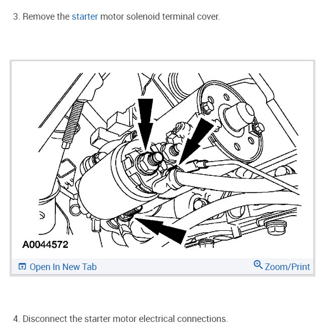

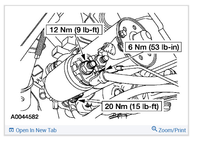

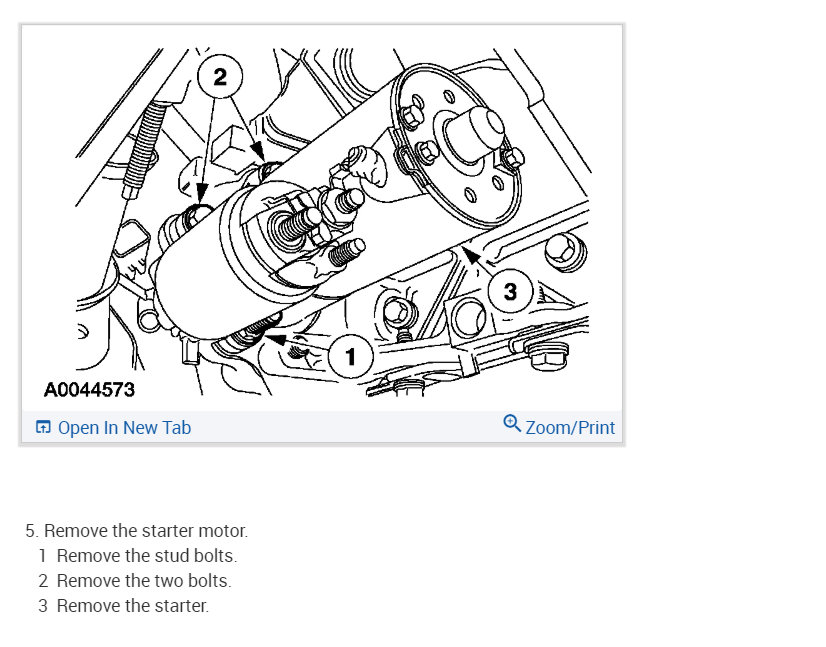

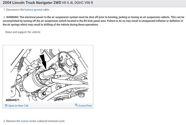

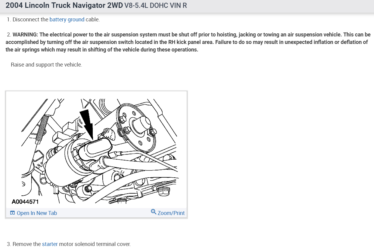

If I can step in here is sounds to me the starter motor has gone bad and the vibration of the tapping helps the starter work. Here is a guide to confirm the issue with a guide to walk you through the starter replacement with diagrams and instructions to help you with the job on your car:
https://www.2carpros.com/articles/starter-not-working-repair
