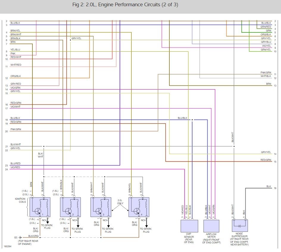

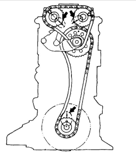

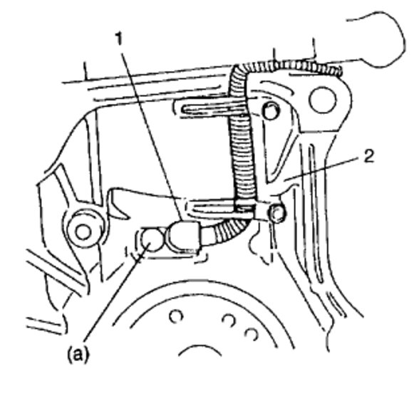

I put a timing chain in this car, someone else had already tried to put the chain on and time it, it did not work. so they brought it to me I took the chain off and timed it myself because it was wrong. I am pretty sure it timed right but I have no fire and no codes. It is getting gas. is there a ignition module or a coil somewhere that is keeping it from firing?
