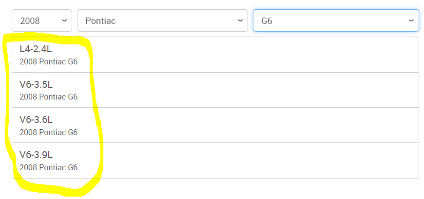

Let me know what engine you have so I can get you the correct manufacturer's fuel pressure specifications. There were four options. See pic below.

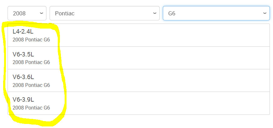

See pic below.
