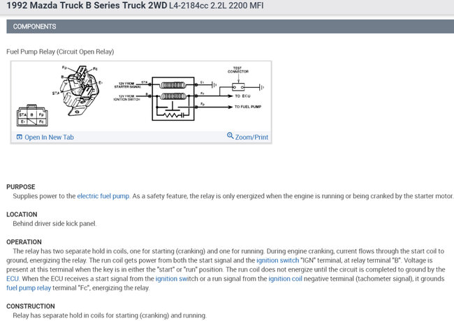

Can you hear the fuel pump turn on when you switch the ignition on?
The fuel pump is energized by the circuit opening relay, located behind the left kick panel.
A good description in image 1.

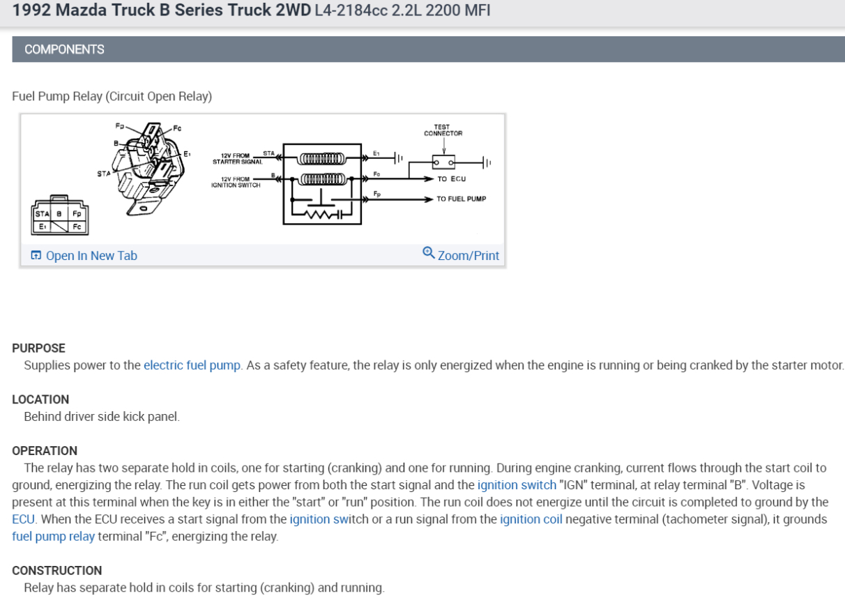

How to test relay:

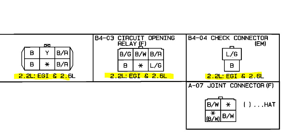

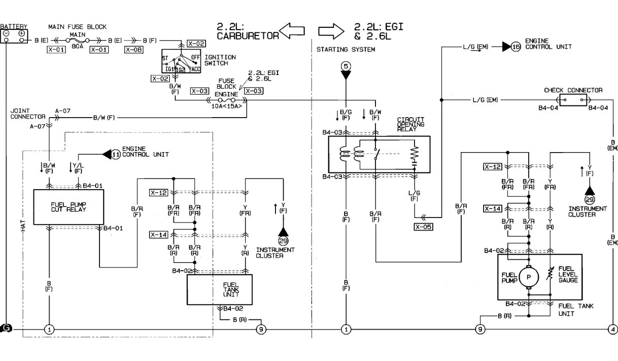

Pin out for the fuel pump connector and wiring schematics are below in image 2+3
