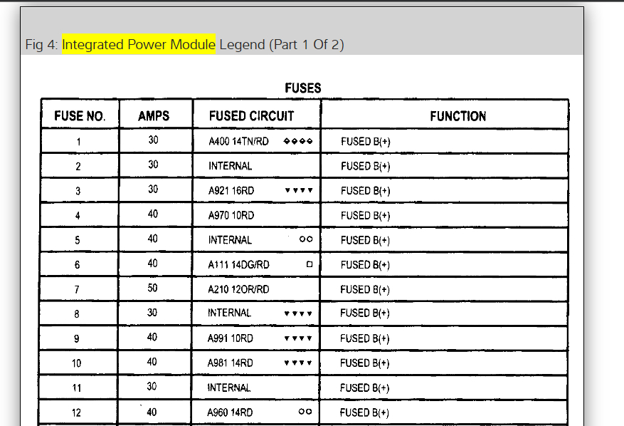

Radio and lights work, but none of the gauges will work. bought a new battery. still will not start. turn key and nothing happens.
Jul 22, 2019 at 10:14 AM
SCGRANTURISMO
  • 4,897 POSTS

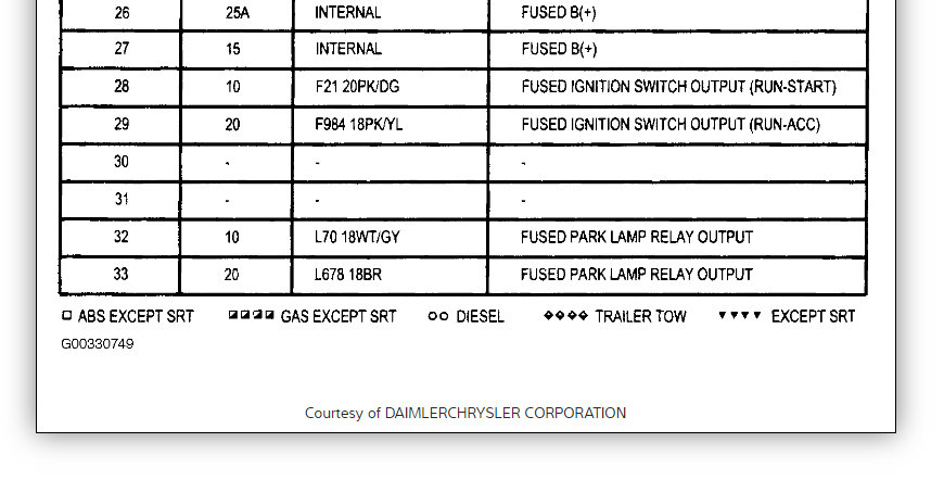

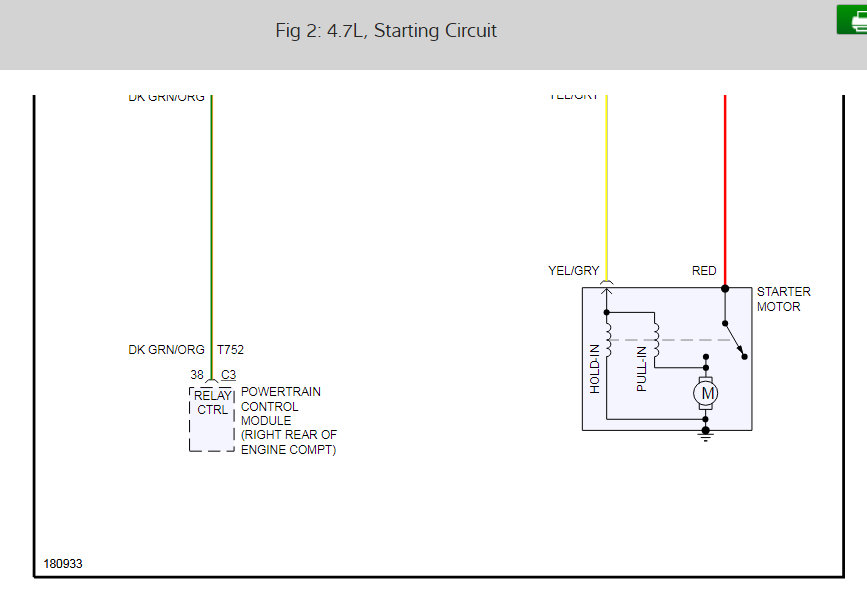

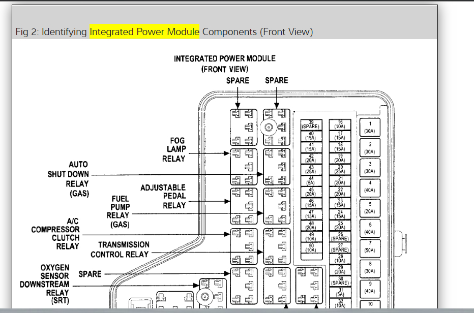

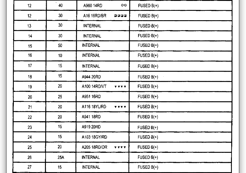

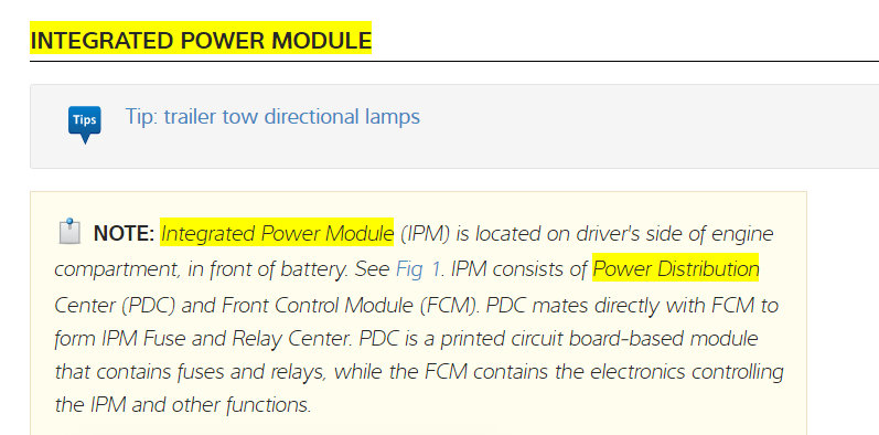

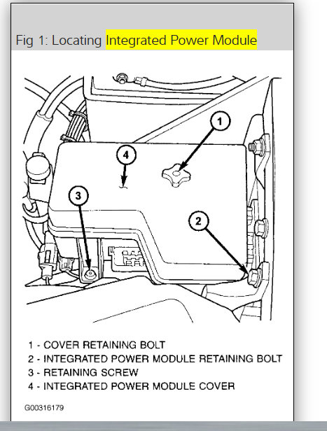

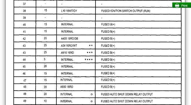

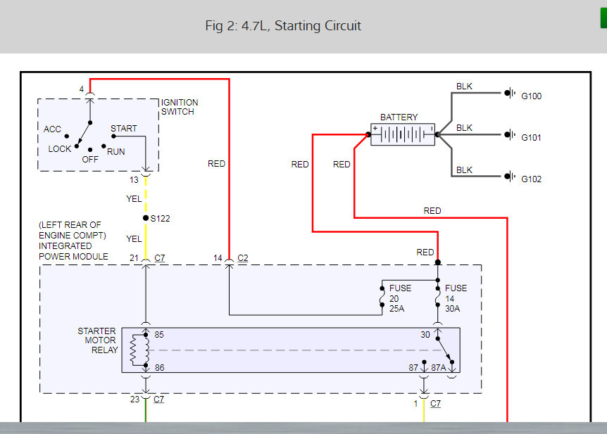

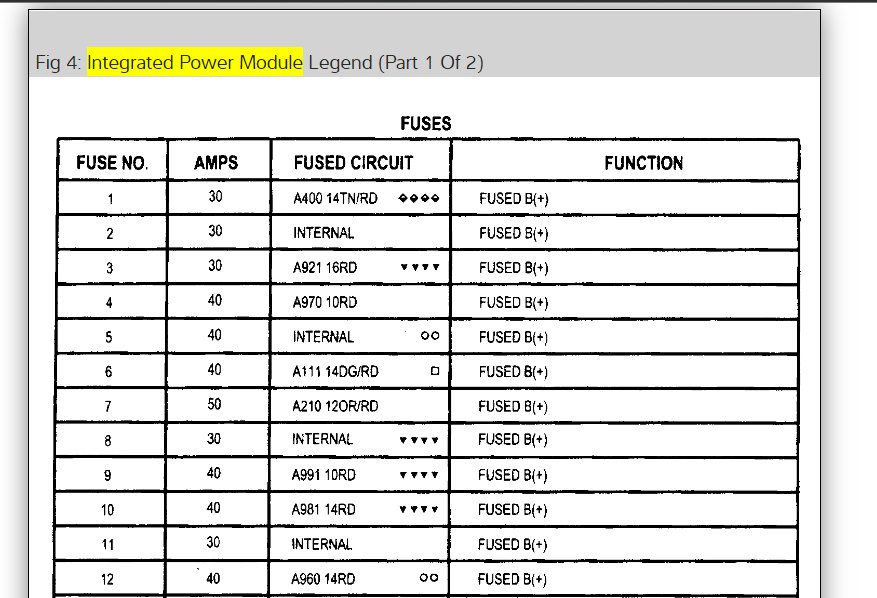

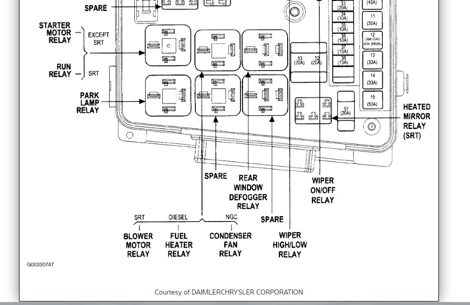

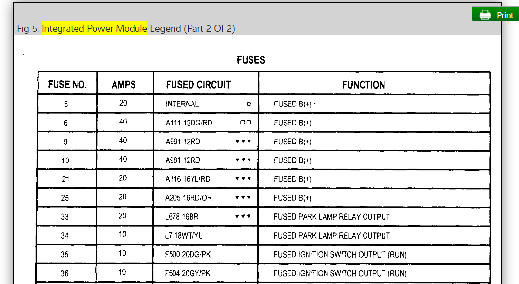

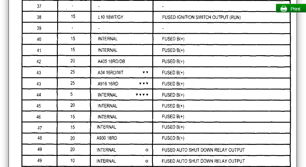

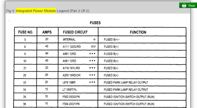

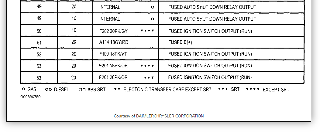

This could be a problem with Fuse #20(25A) in the Integrated Power Module on the left rear of the engine compartment. In the diagrams down below I have included a wiring diagram of your vehicle's starting system and a diagram and callout for the Integrated Power Module. Here is a link for you to go to as well, if you are unfamiliar with how to check a fuse.
Please go through these guides, if needed, and get back to us with what you are able to find out.
