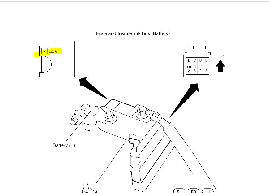

Last, there is a 250-amp fusible link mounted at the battery fusible link box. It is fusible link A. Inspect it to make sure it hasn't failed.

See pic below for the fusible link location.
