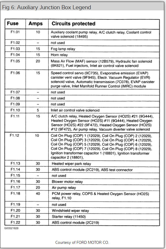

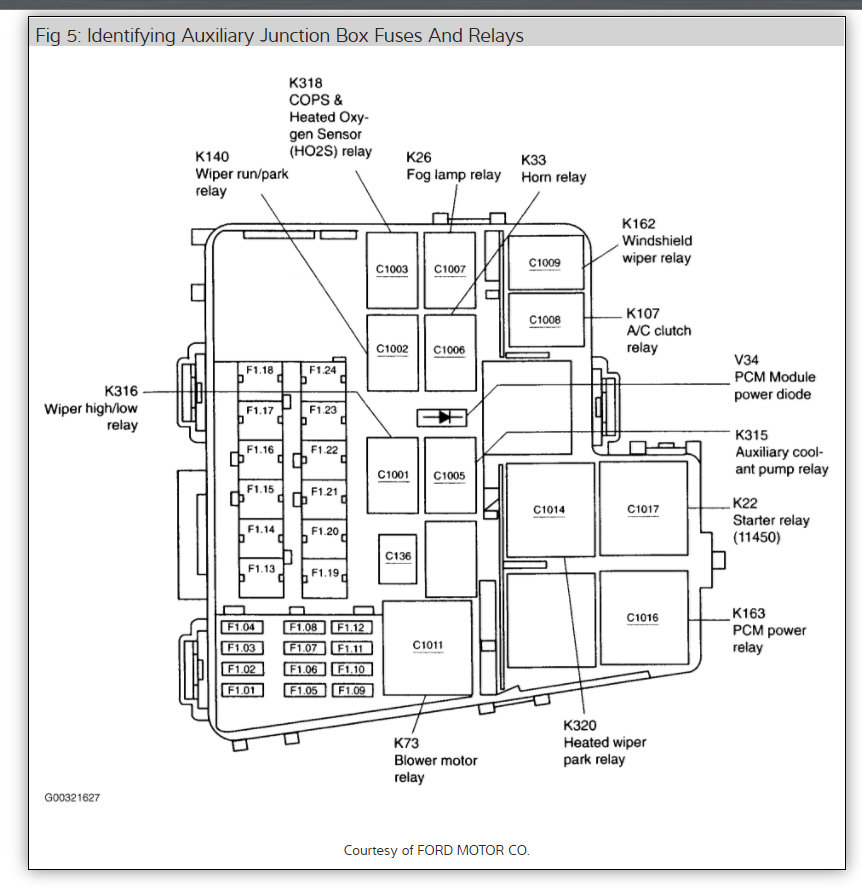

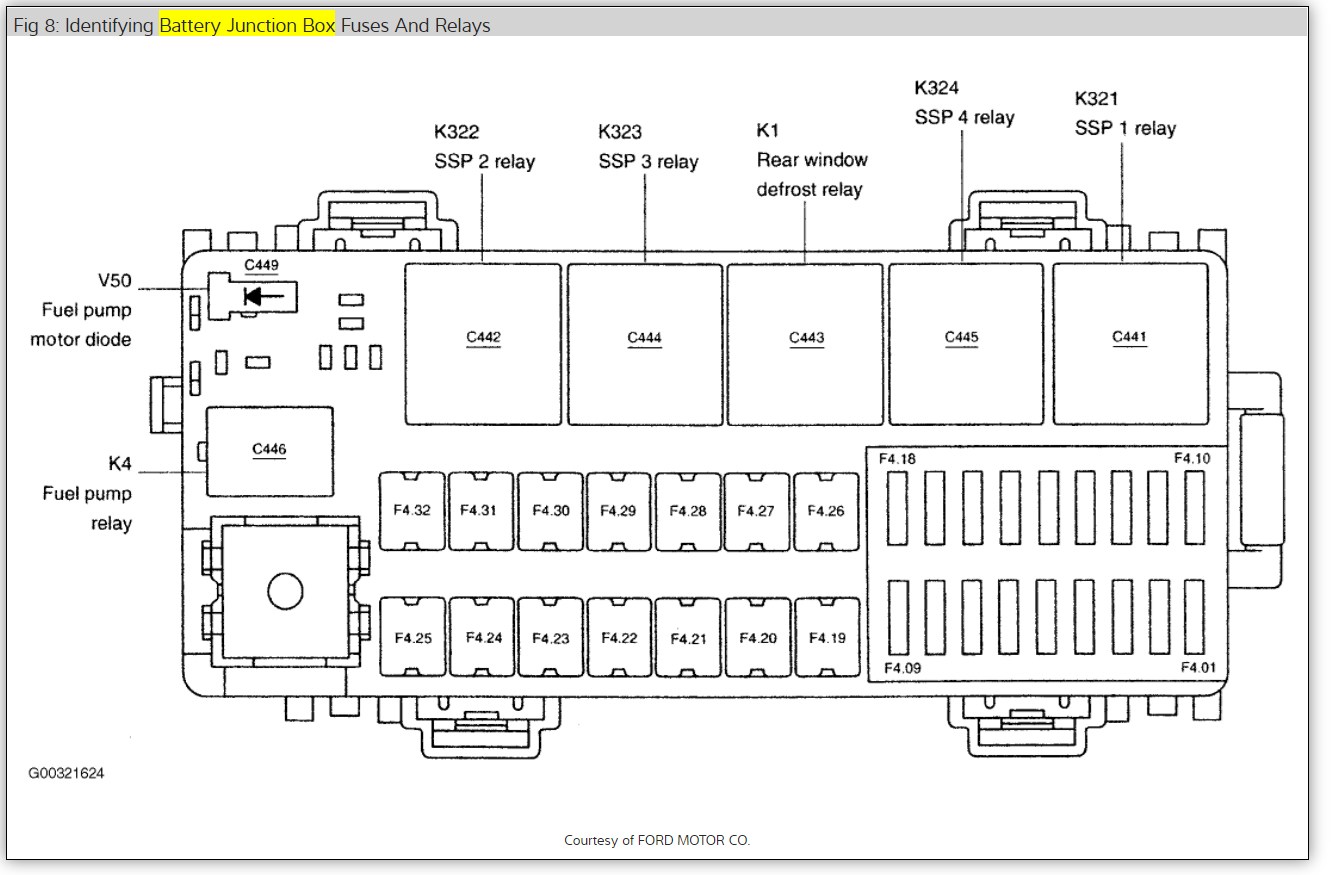

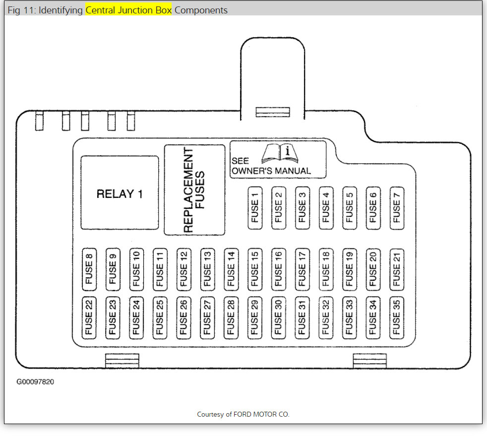

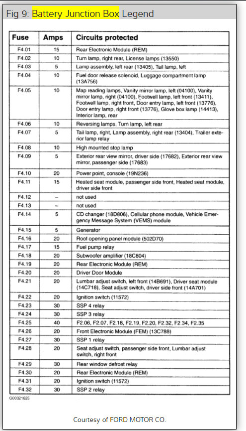

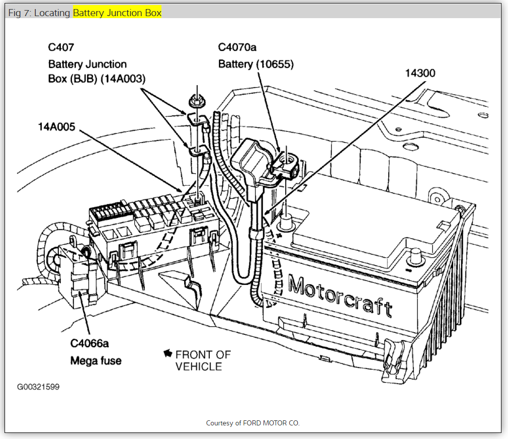

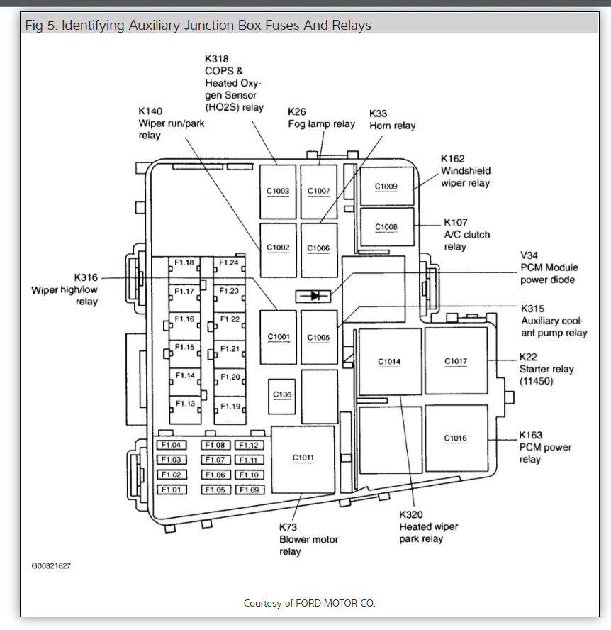

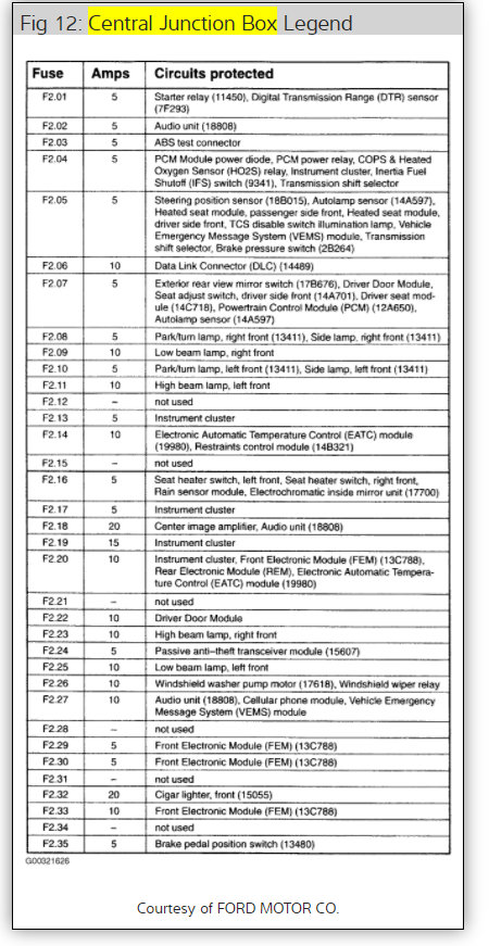

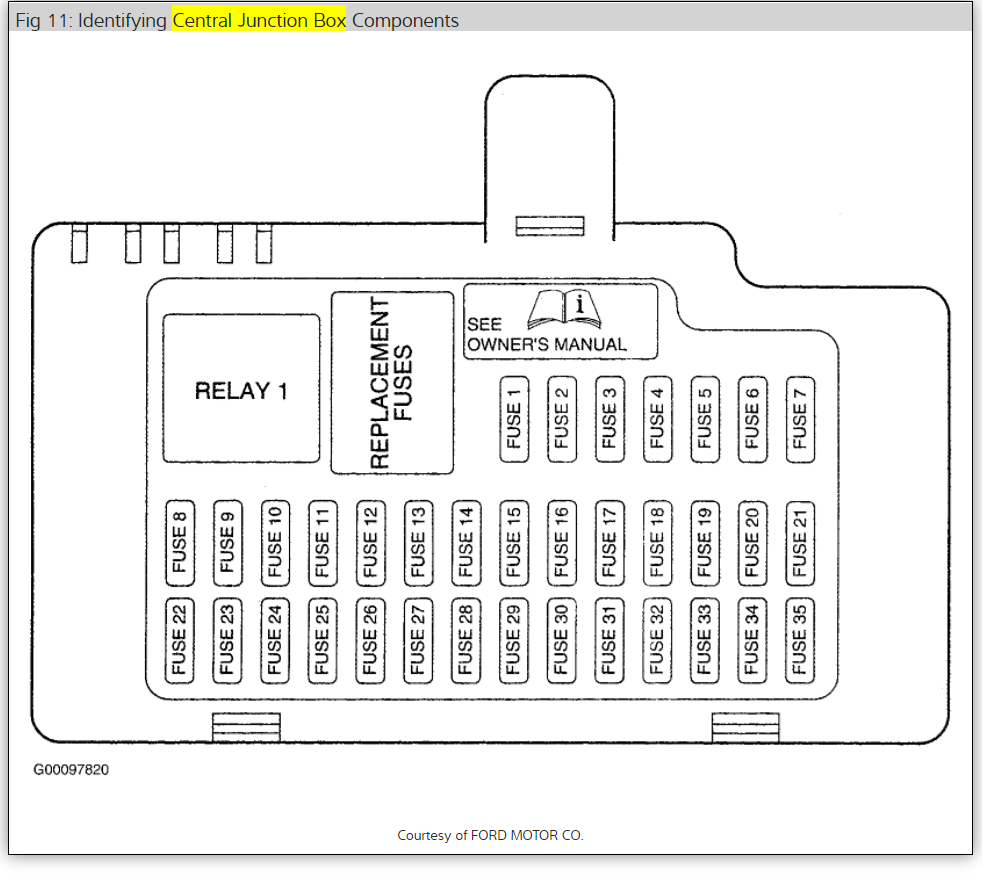

With the key in the on position I would check all fuses. Here is a guide to show you how and the fuse panel locations and identifications:
Check out the diagrams (below). Please let us know what you find.
