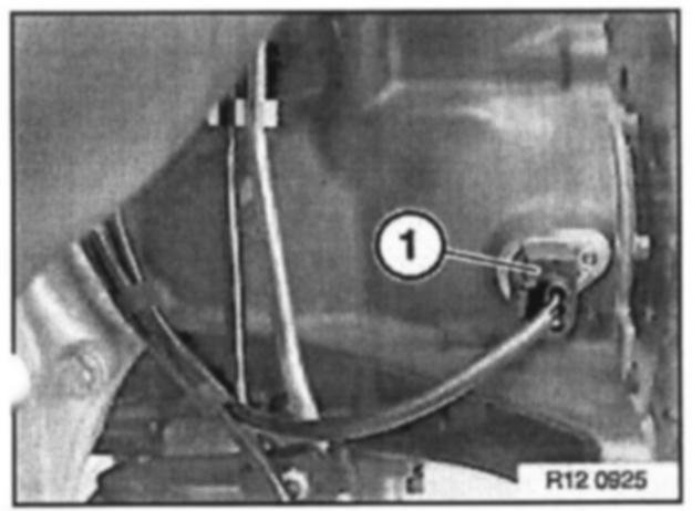

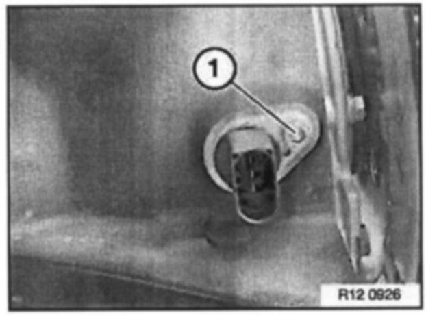

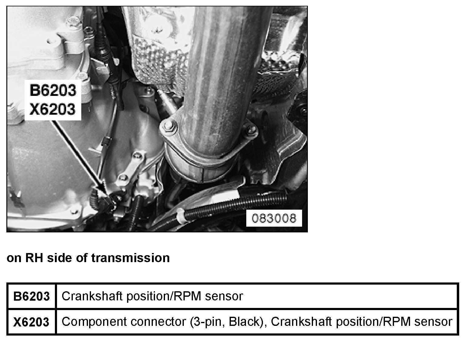

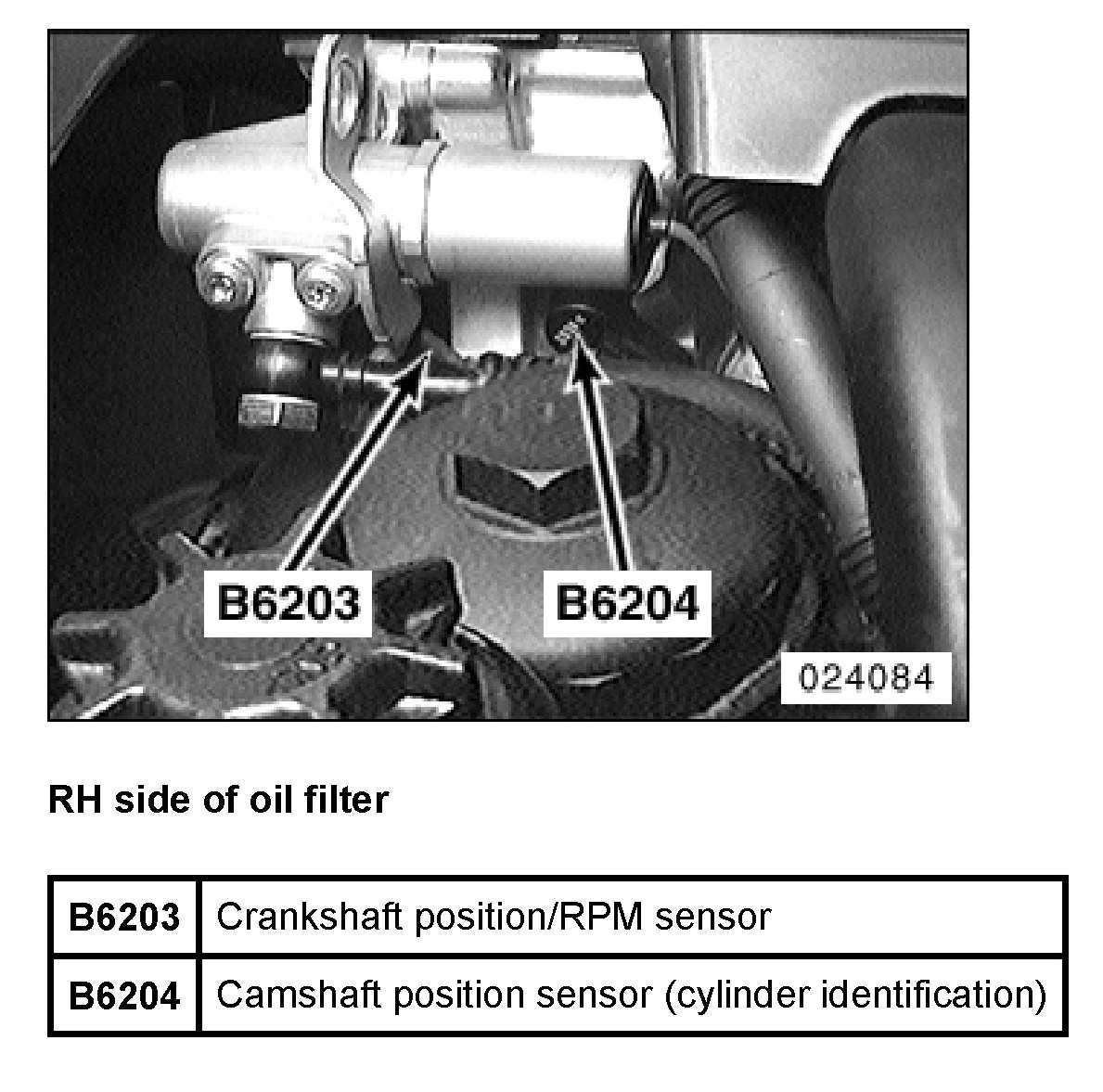

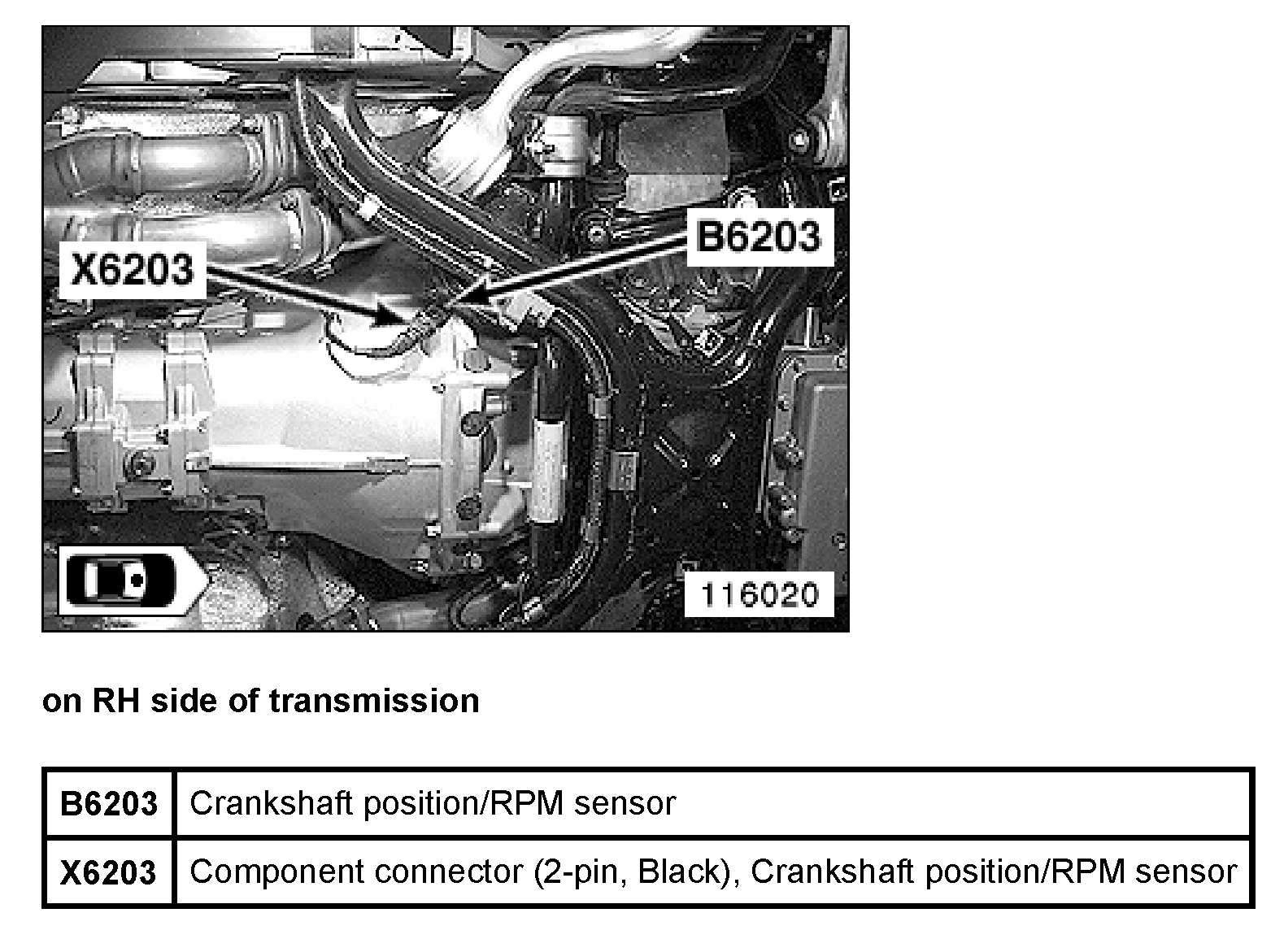

Since you were working on the engine, the first thing I need you to do is confirm the crankshaft position sensor is still connected. I have attached three different pictures. Each shows a possible location for your engine. Since you are getting fuel but no spark, this is my first suspect. The last two pictures show what the sensor looks like and it is most likely location (below the starter).
Note: If you have a live data scanner, check to see if there is an RPM/crank signal. If there is not my guess is the sensor is unplugged.

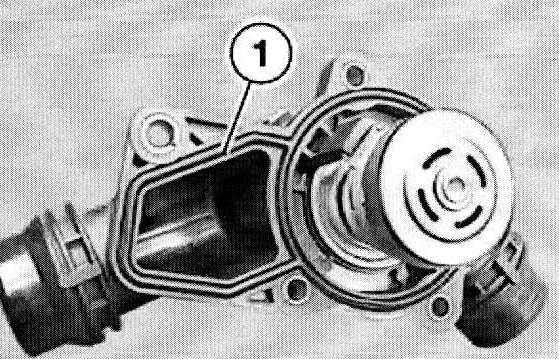

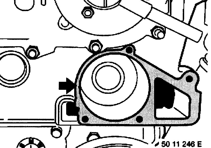

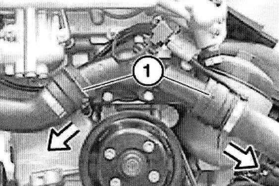

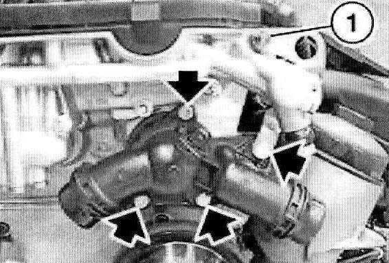

Chances are you do not need this, but here are the directions for replacing the thermostat just in case. The pictures attached correlate with these directions.
_____________________________________________
REMOVING AND INSTALLING/REPLACING COOLANT THERMOSTAT
Remove fan clutch with fan impeller and fan cowl, refer to Fan Clutch, Service and Repair.
Drain and dispose of coolant. See: Coolant > Procedures
Note: The water drain plug is located on the exhaust side on cylinder 2 in the engine block.
Installation:
Replace sealing ring of water drain plug.
Tightening torque, refer to Specifications, Mechanical.
Vent cooling system and check for leaks, refer to Cooling System, Service and Repair. Pull locks and disconnect water hoses.
Installation:
Refer to general instructions for work on cooling system, refer to Cooling System, Service and Repair.
Loosen nut (1).
Release screws on thermostat housing, remove thermostat housing.
Installation:
Keep sealing faces clean and free of oil.
Note: Coolant thermostat is integrated in coolant thermostat housing and can only be replaced as a single unit.
Installation:
Replace gasket (1).
