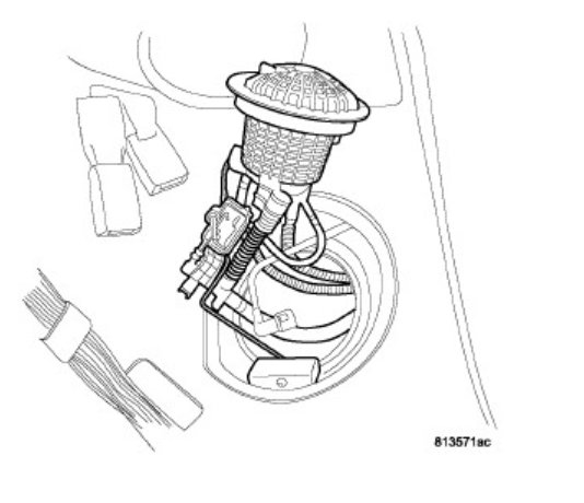

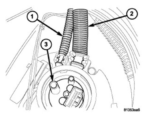

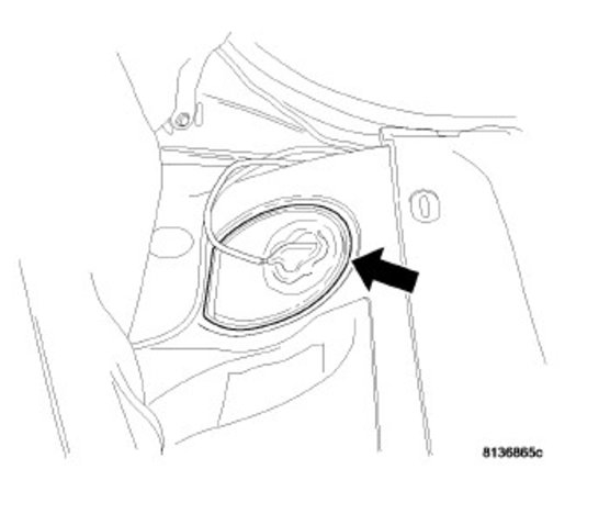

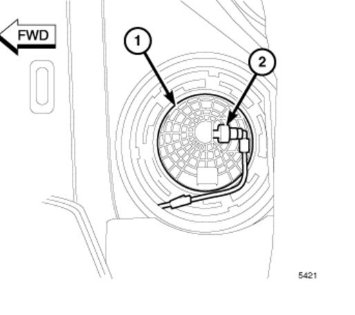

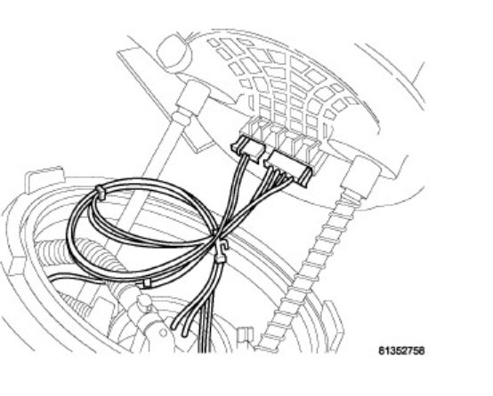

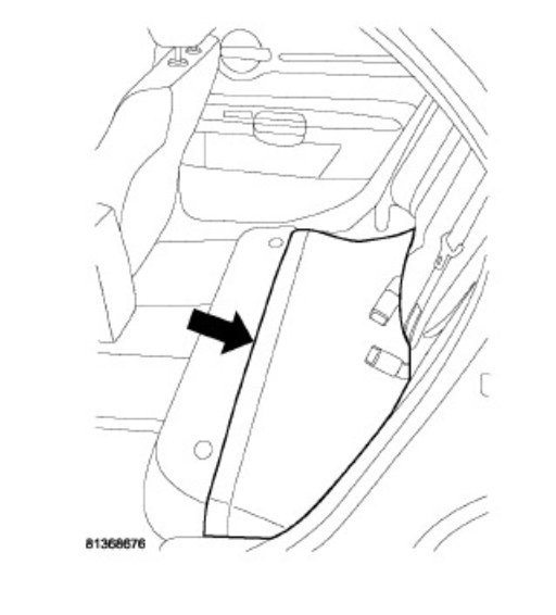

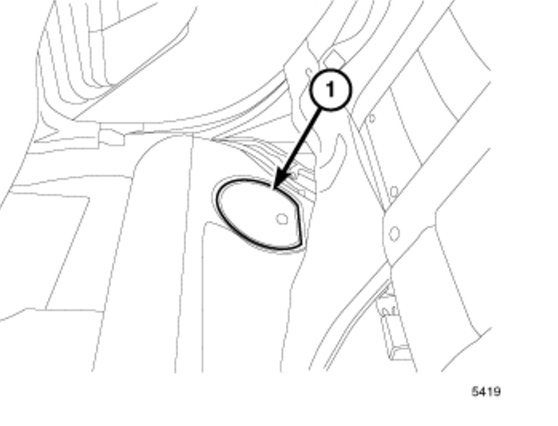

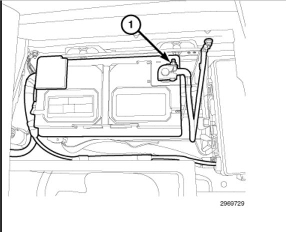

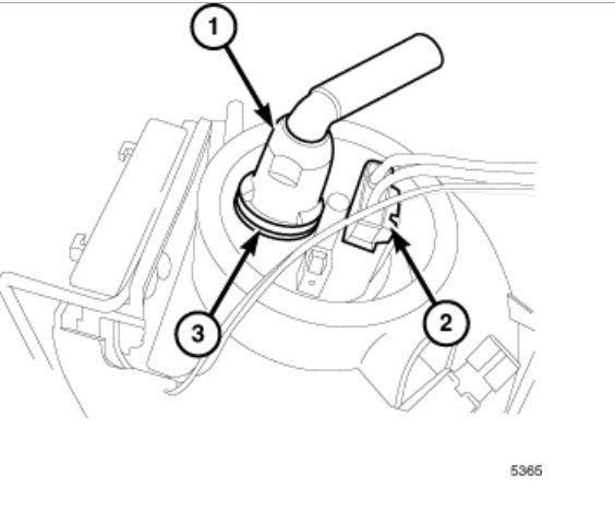

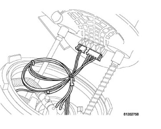

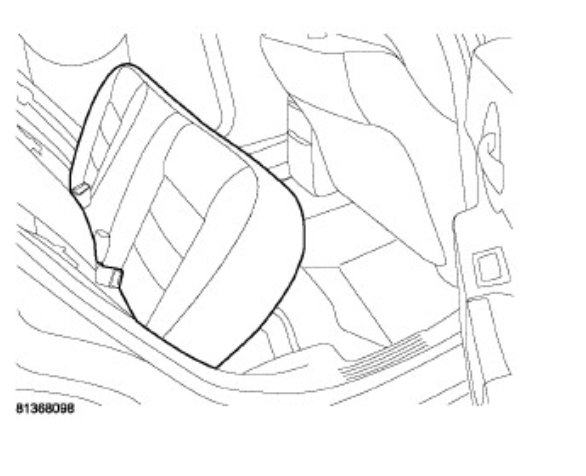

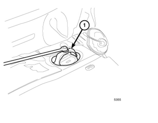

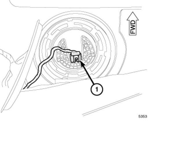

It sounds like the fuel pump when out. Here is a guide to help you get an idea on what you are in for when doing the job:
Your is under the back seat though. Here are the diagrams (below) that will show you how to change it.
Here is an additional guide as well:
