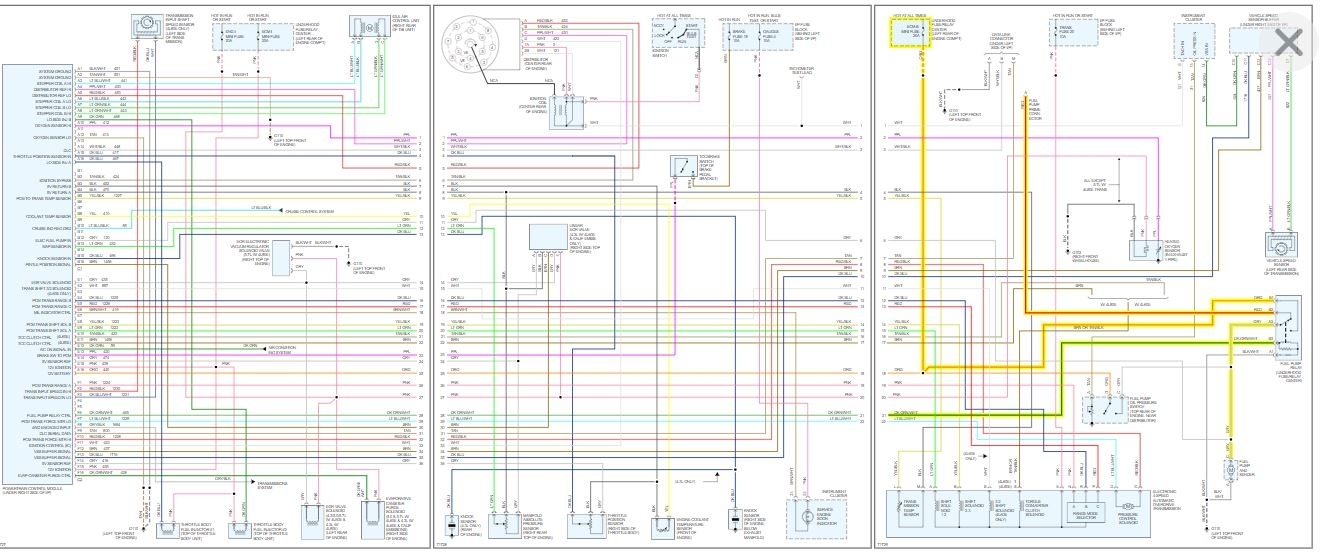

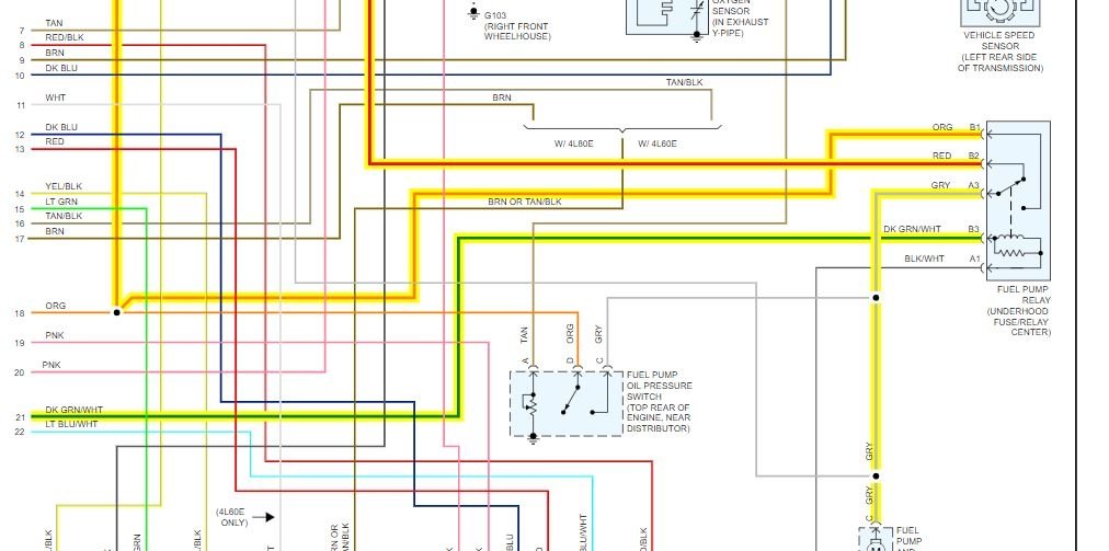

My SUV will crank. It is getting spark to plugs.A bunch of parts have been replaced including the ignition switch. The tell-tale clue is the fuel pump (just replaced) will run for about six seconds and then quit. Therefore no gas is getting to throttle body carburetor.
Does this sound like the fuel pump or an electrical problem?
