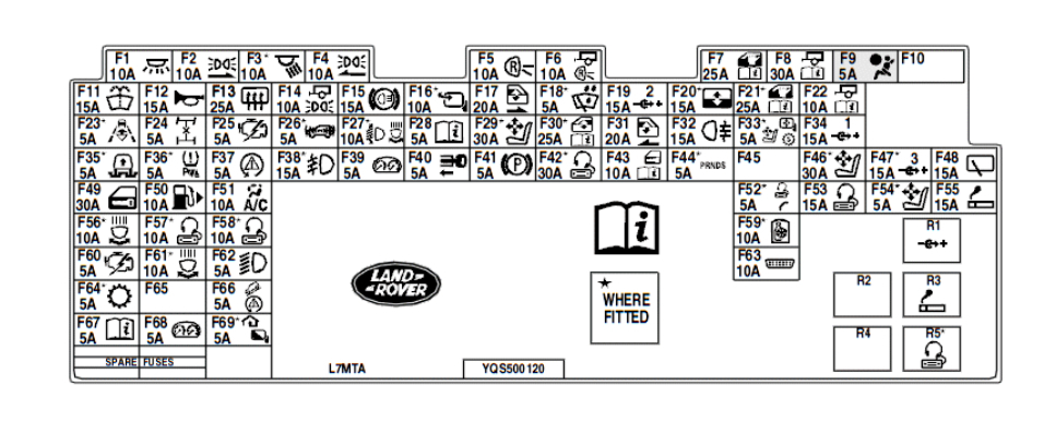

it has fire and turns over good. fuel good but no gas getting to cylinders.
Nov 26, 2017 at 11:09 PM
CERTIFIED EXPERT
53,854 POSTS

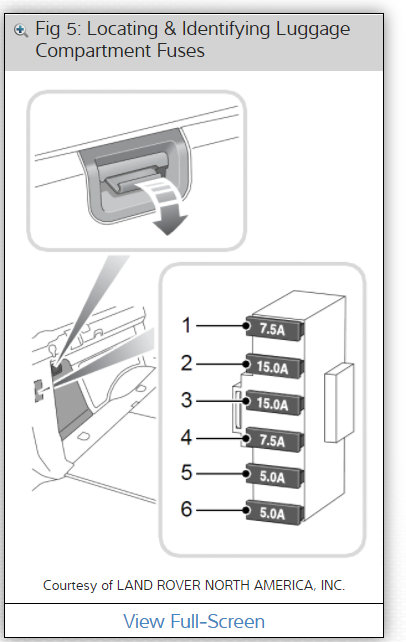

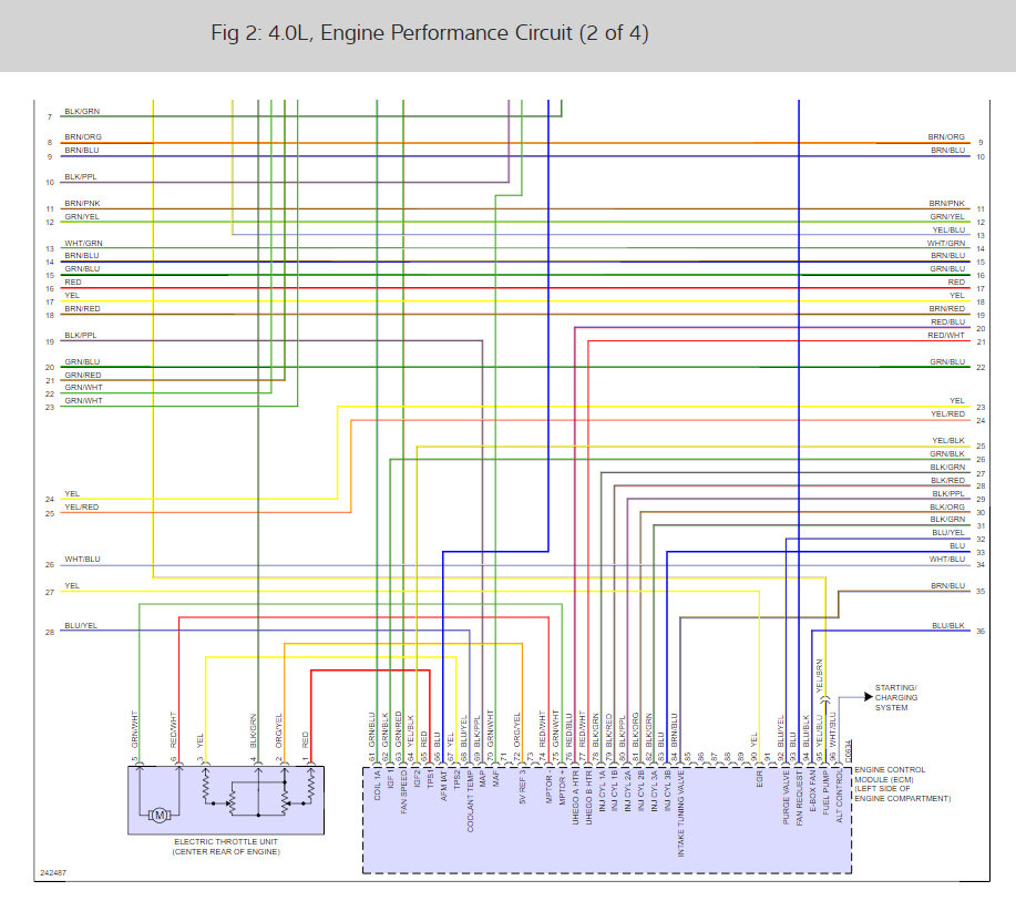

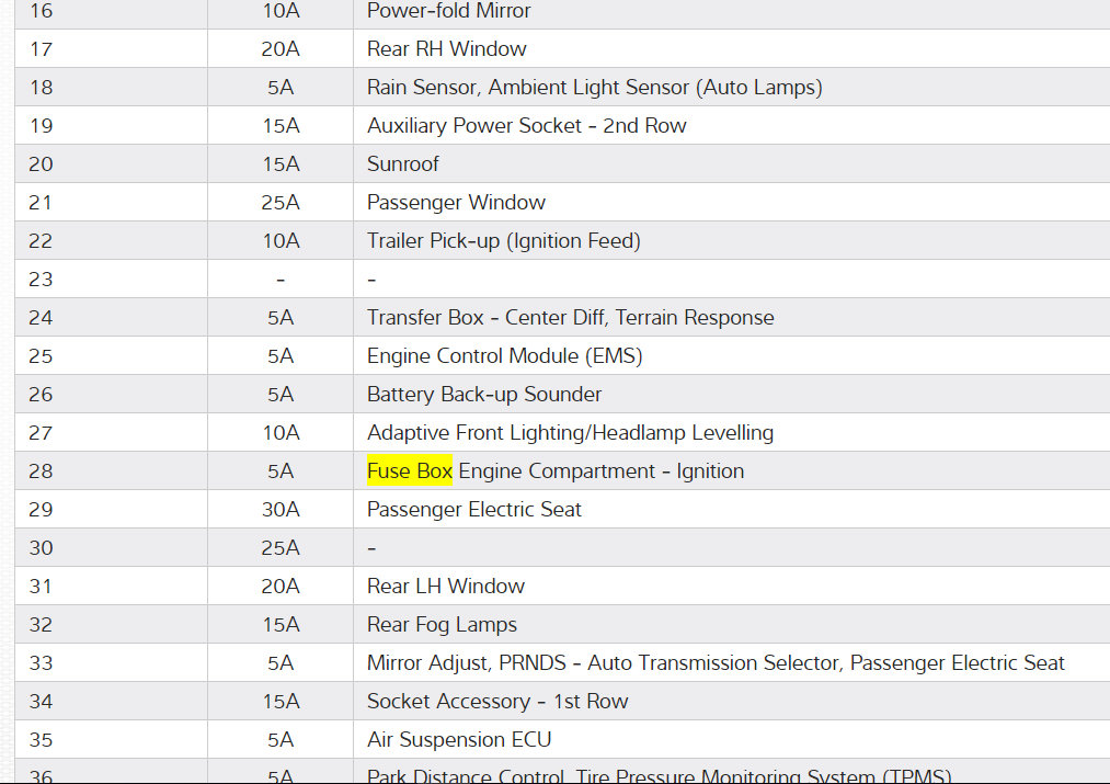

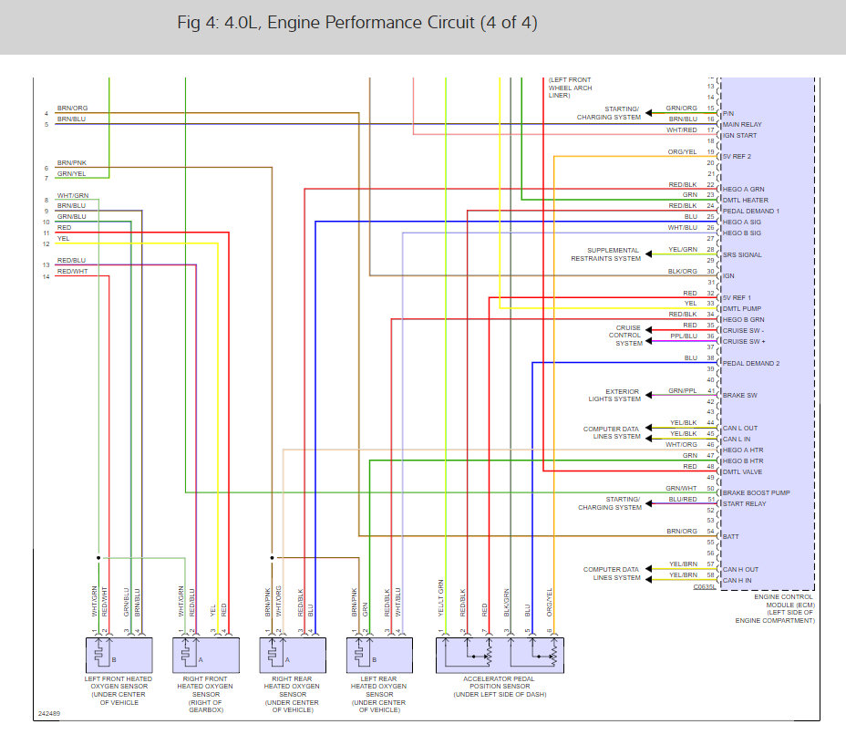

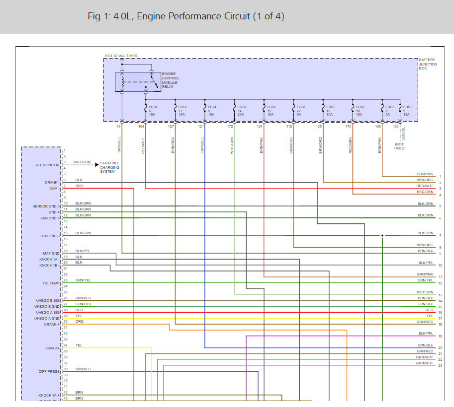

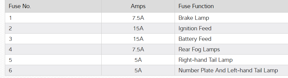

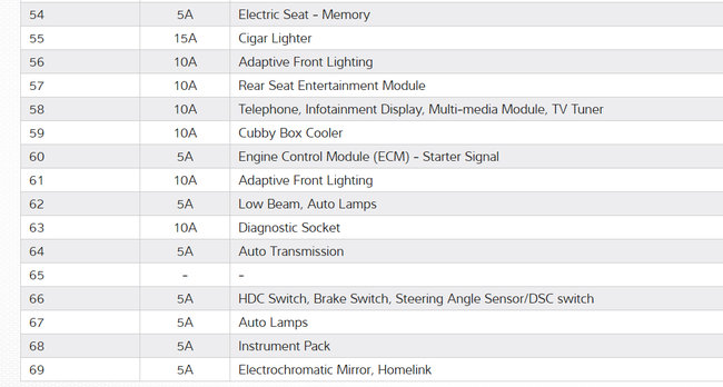

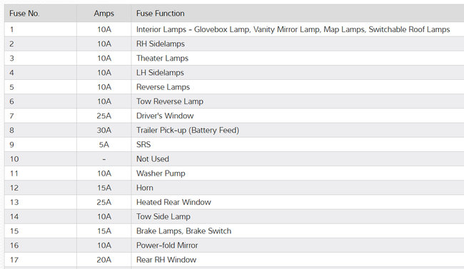

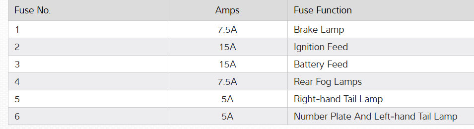

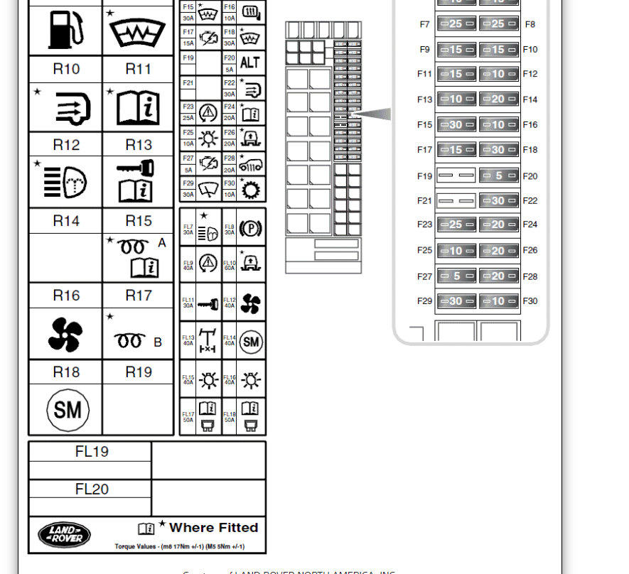

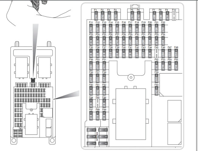

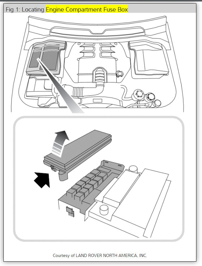

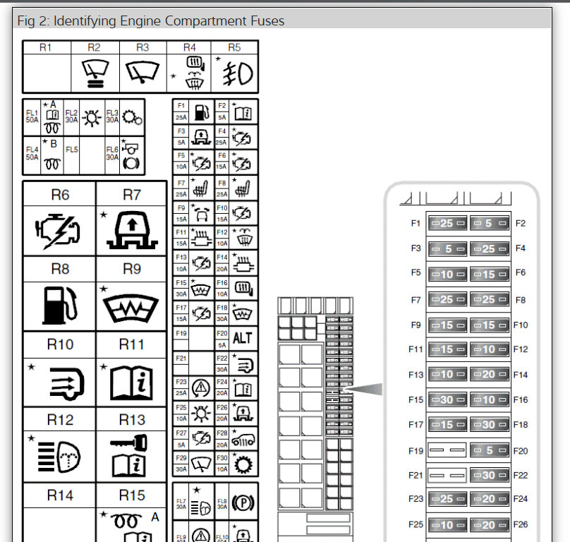

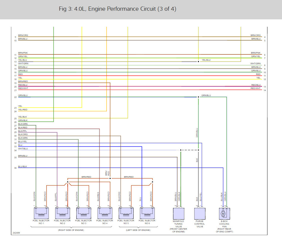

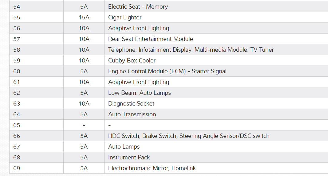

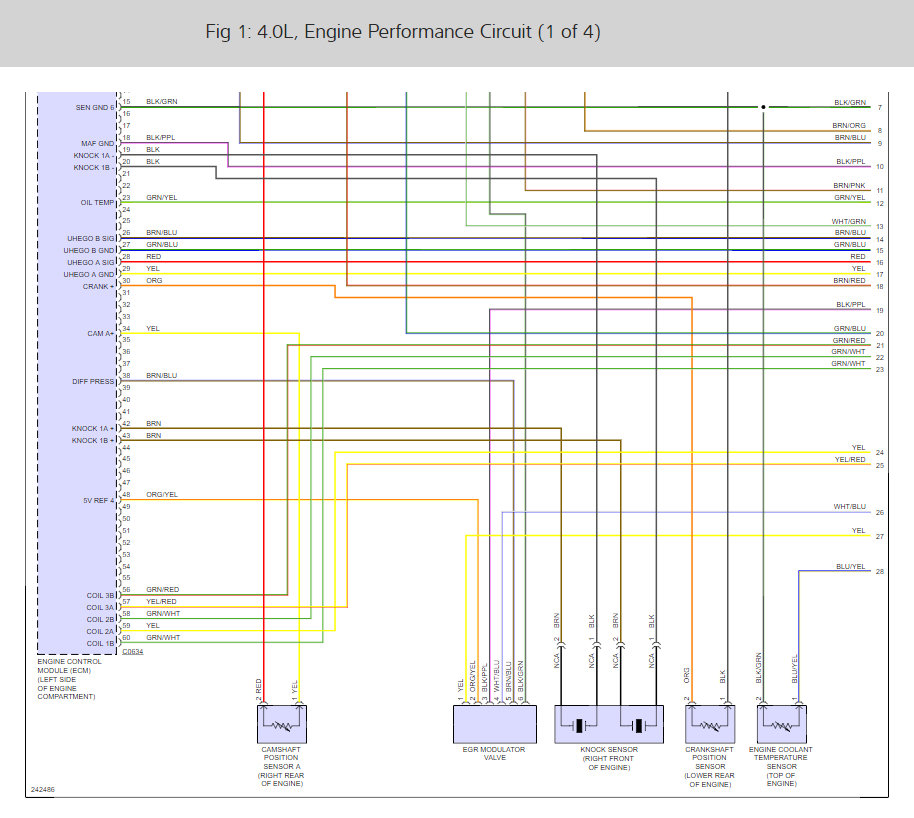

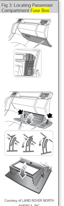

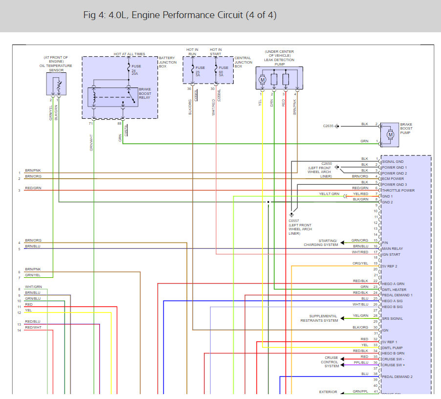

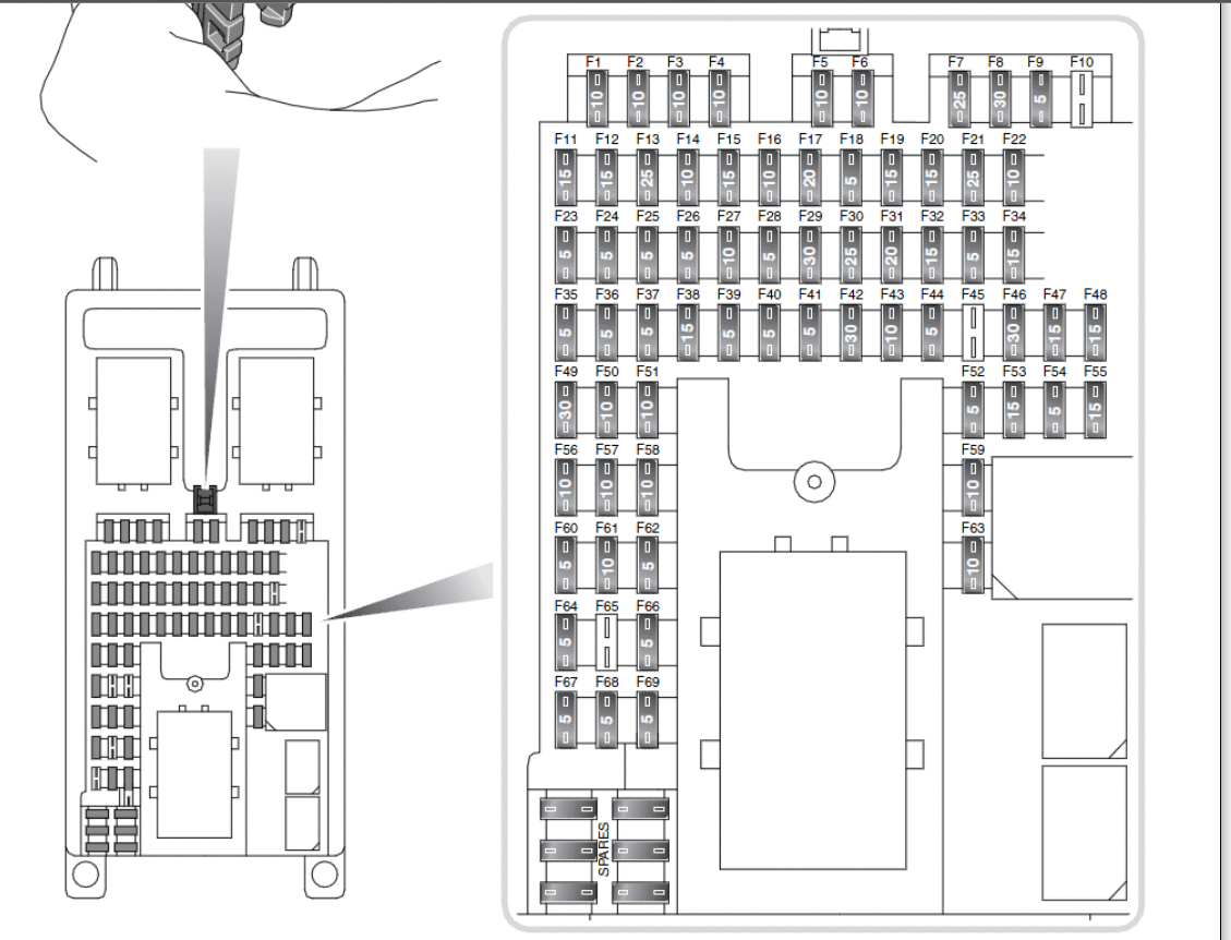

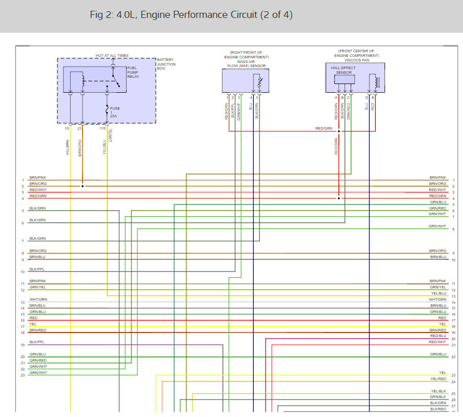

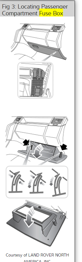

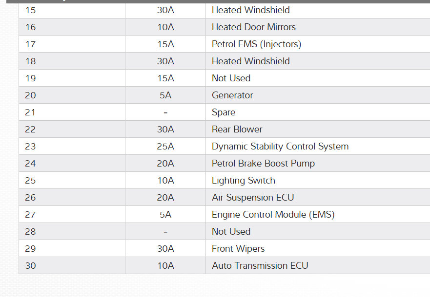

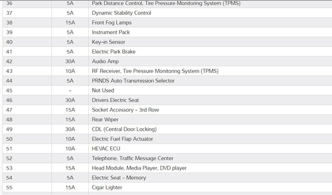

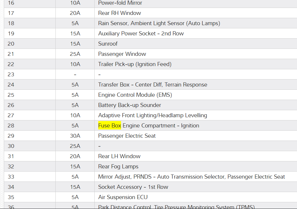

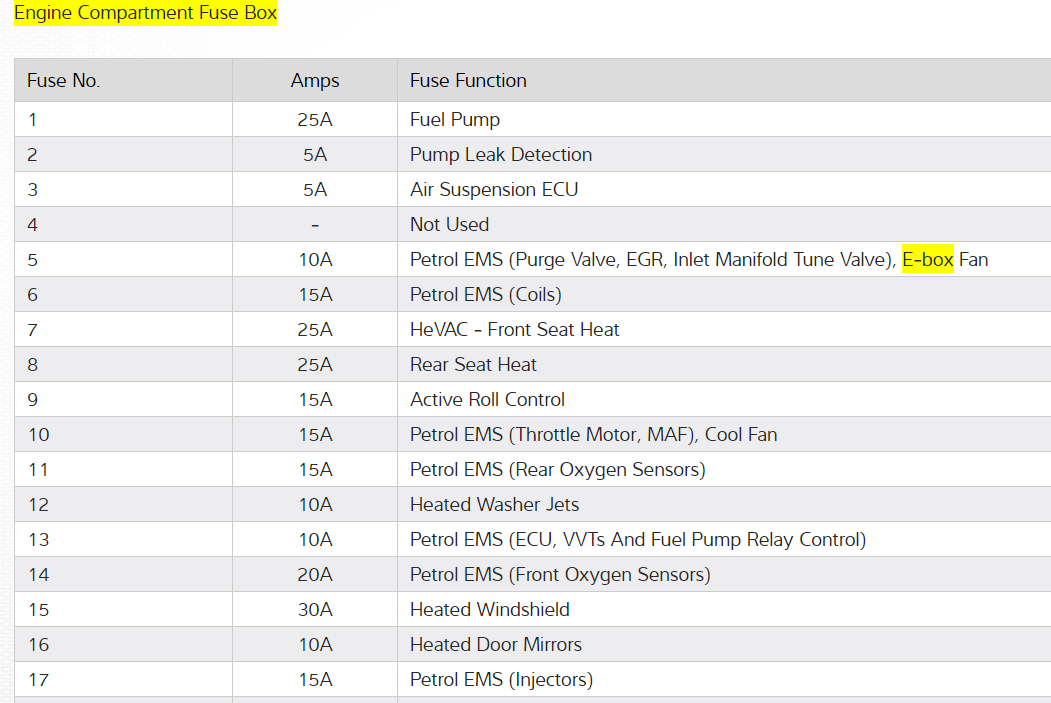

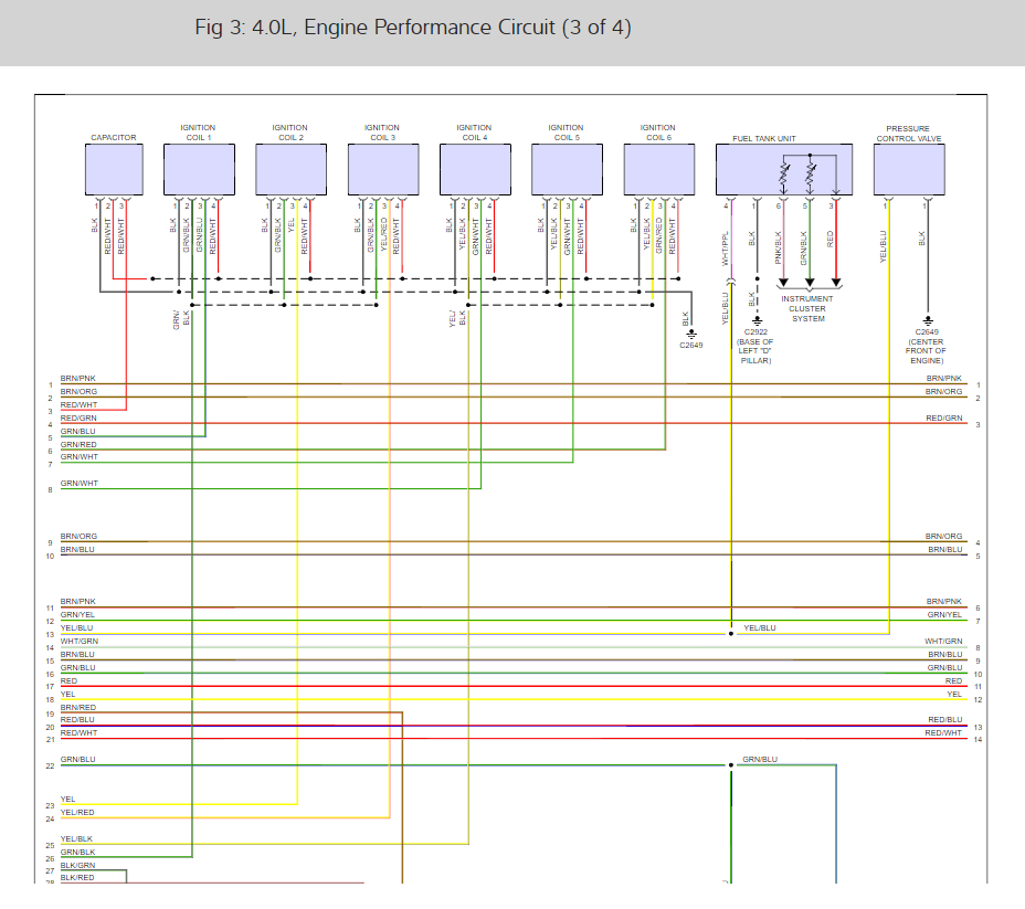

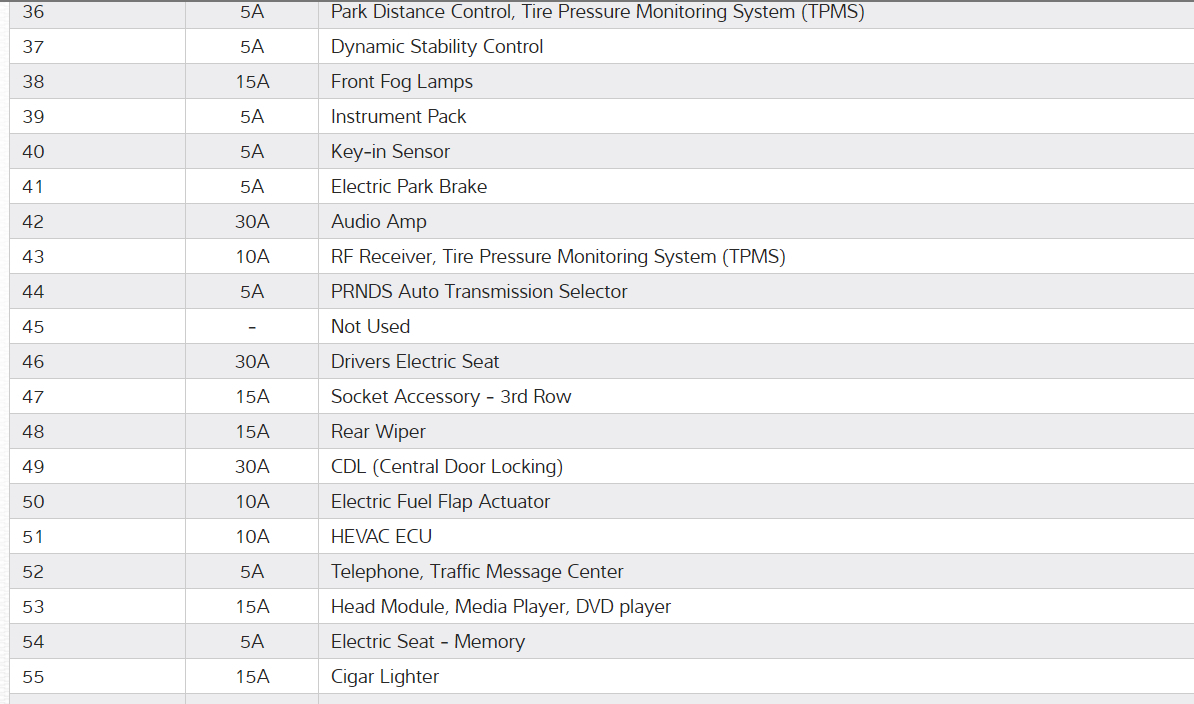

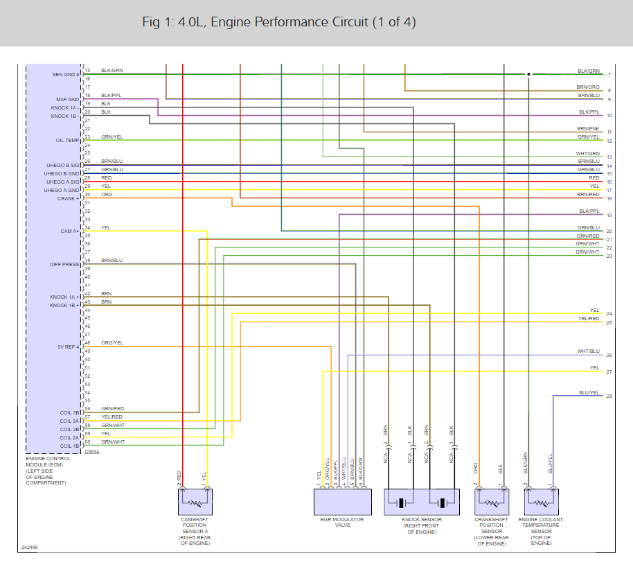

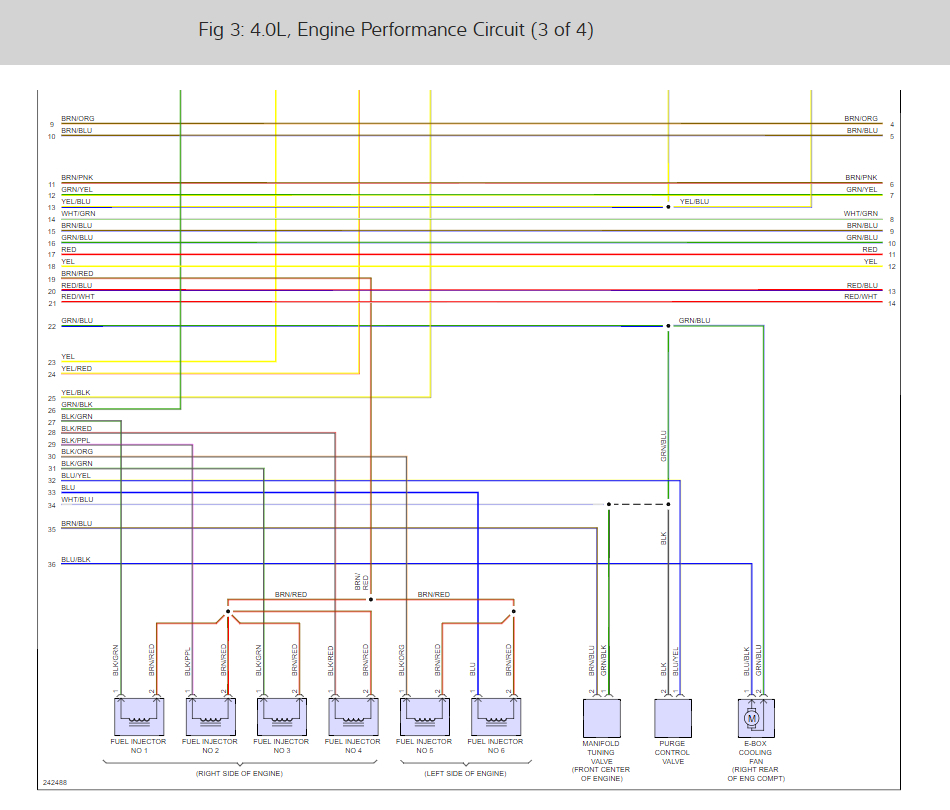

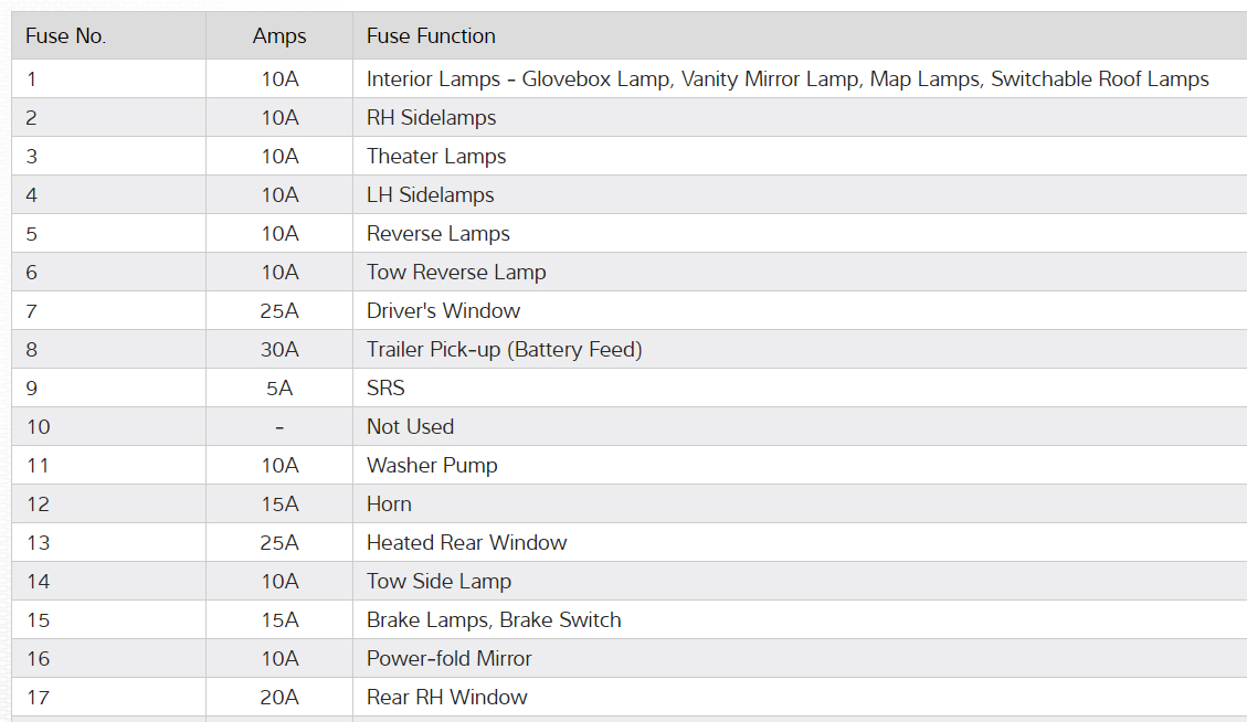

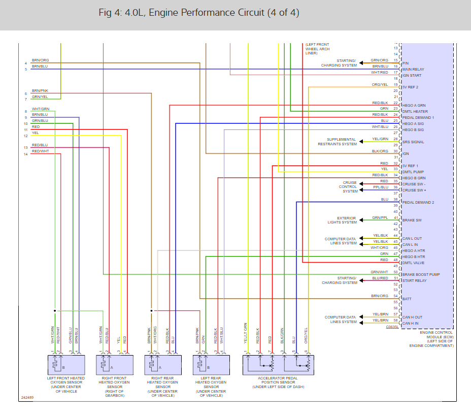

Fuel good did you take a pressure test or hear the fuel pump? If so then it sounds like you have a engine control module relay that is not working you should check the fuses as well. Here two guides to get us started.
