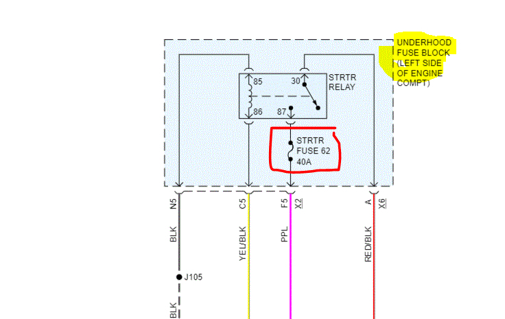

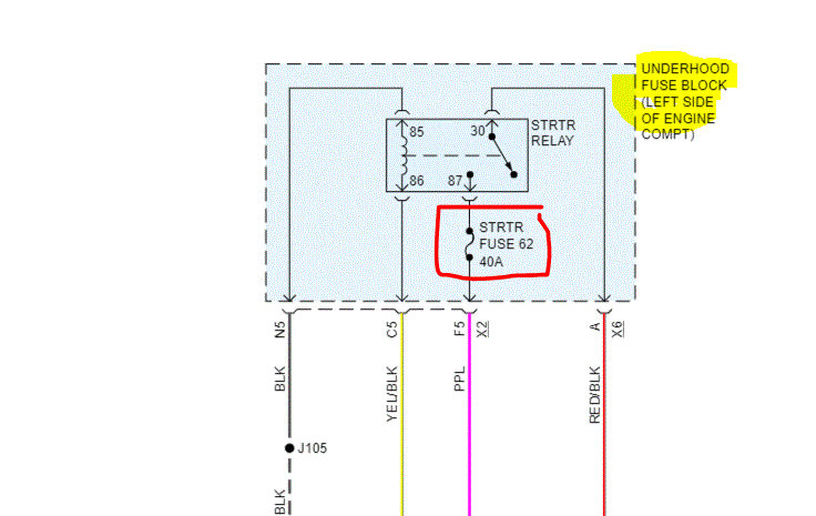

If the starter doesn't engage, try starting it in neutral. If it still doesn't start, check fuse 62 in the under hood fuse box. See pic 1.
