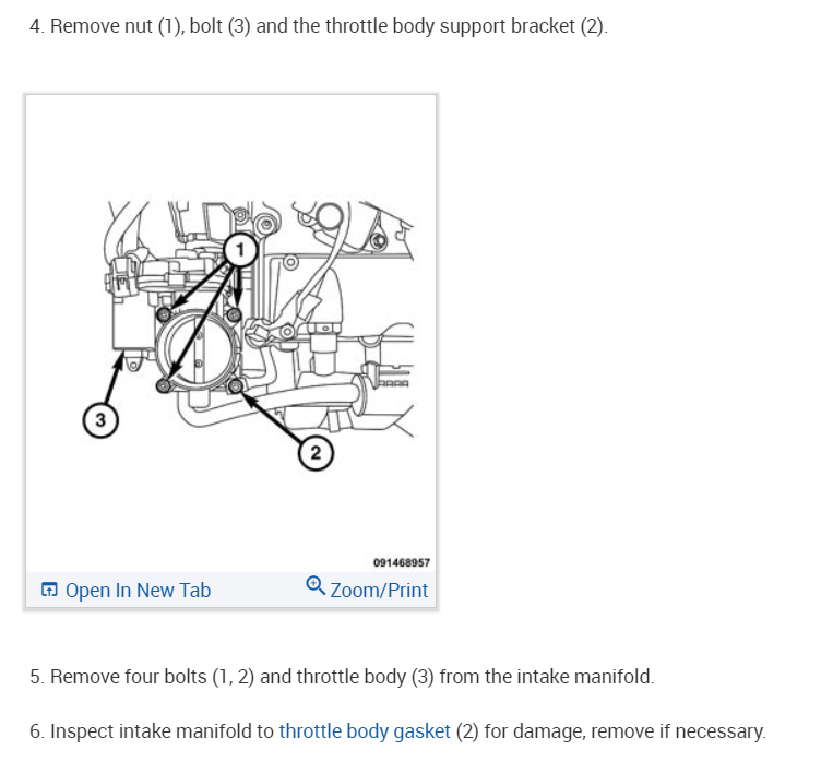

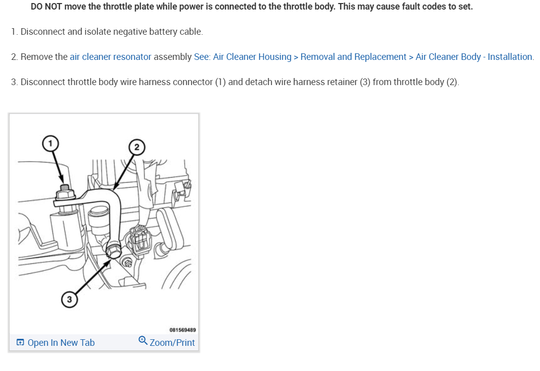

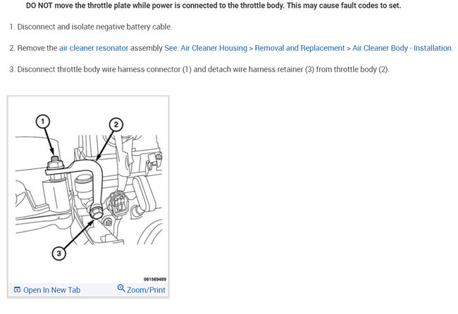

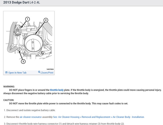

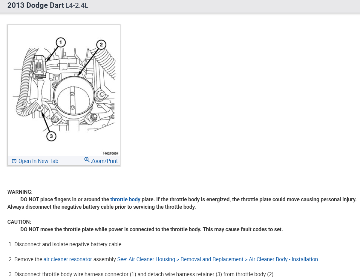

I don't see the video? This problem is typical when the throttle bore needs to be serviced. Leave the wiring connector on the throttle body when doing the service. here is a guide to help walk you through the steps and diagrams below to show you no your car:
