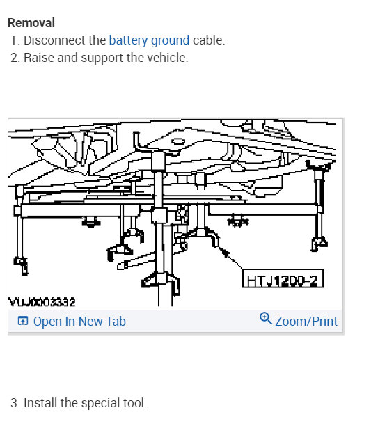

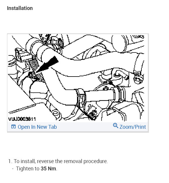

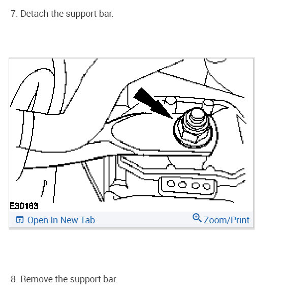

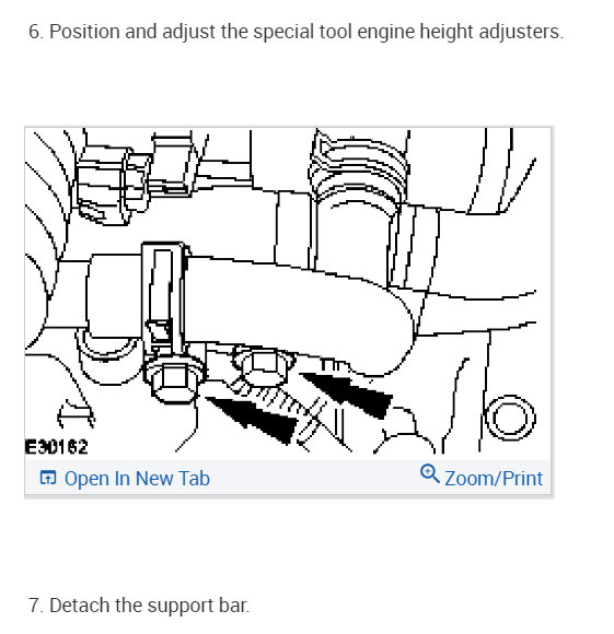

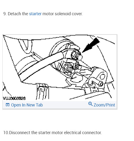

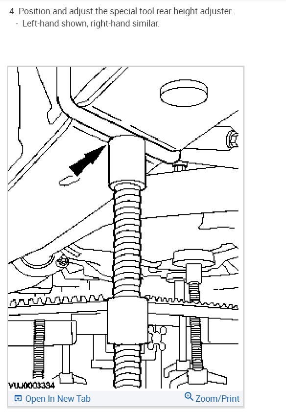

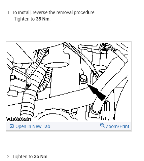

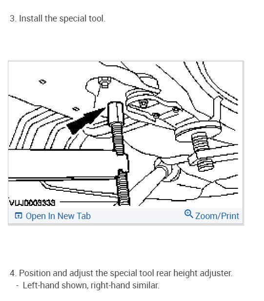

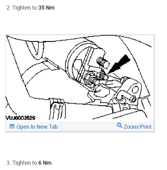

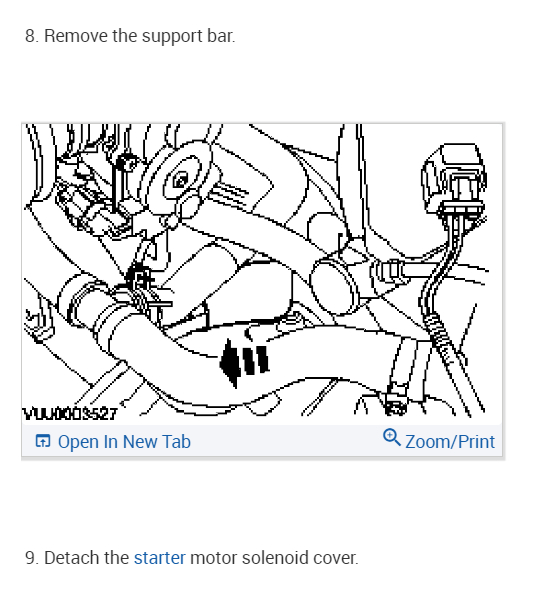

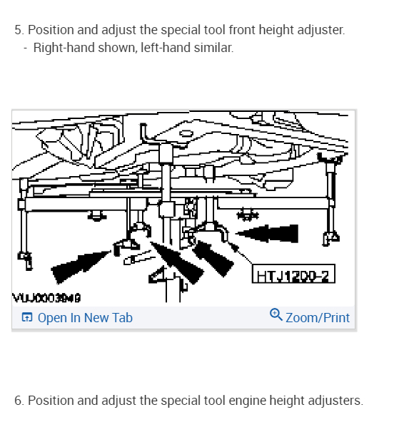

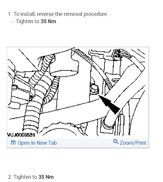

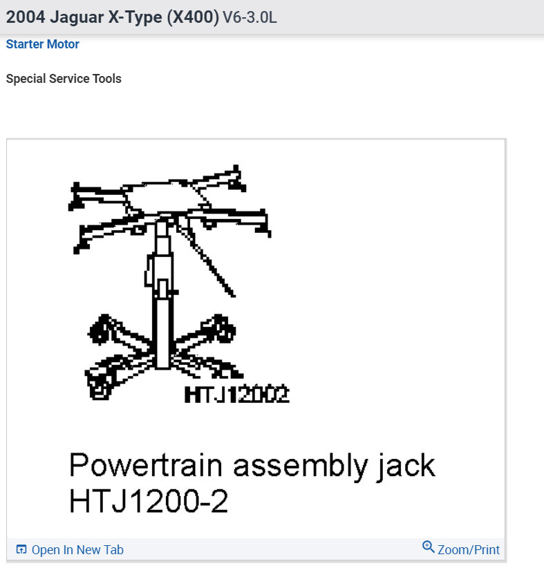

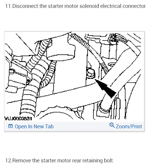

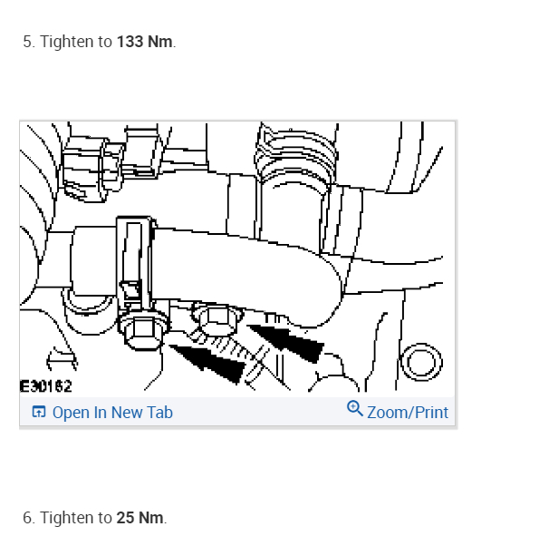

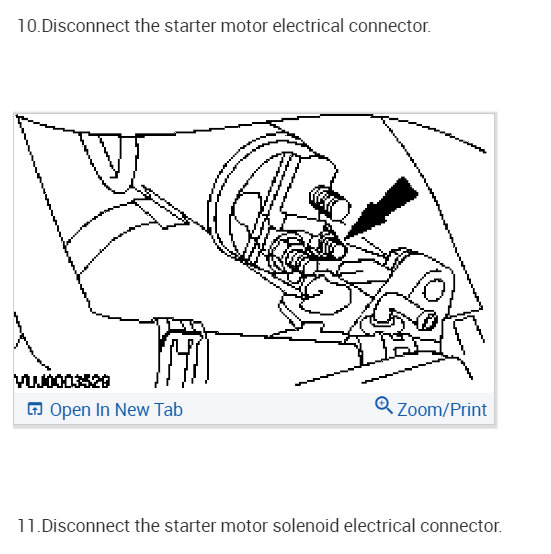

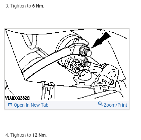

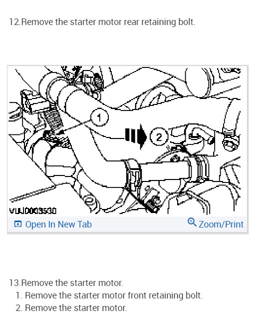

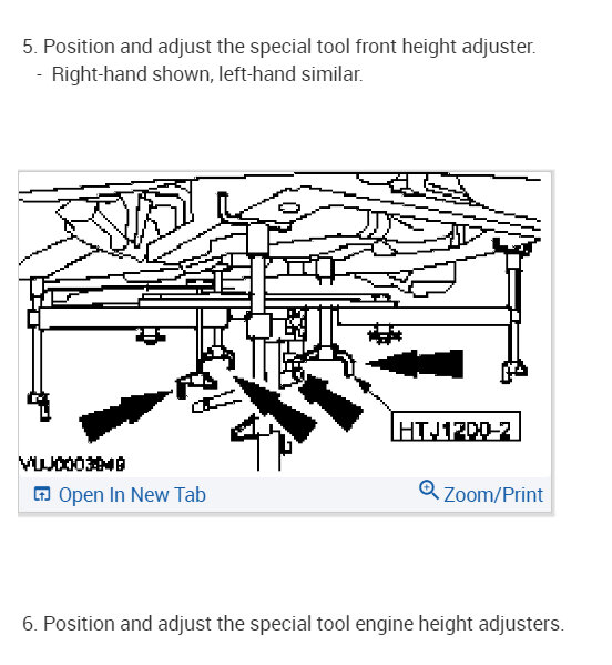

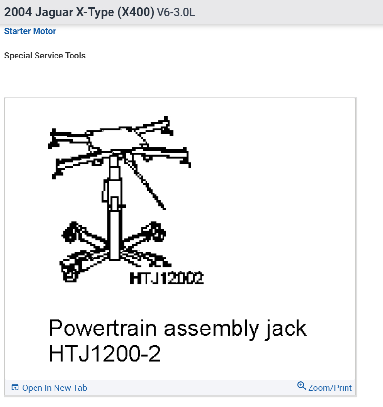

Here is how to change the starter out in case you need it. Check out the images (below). Please let us know what happens.
