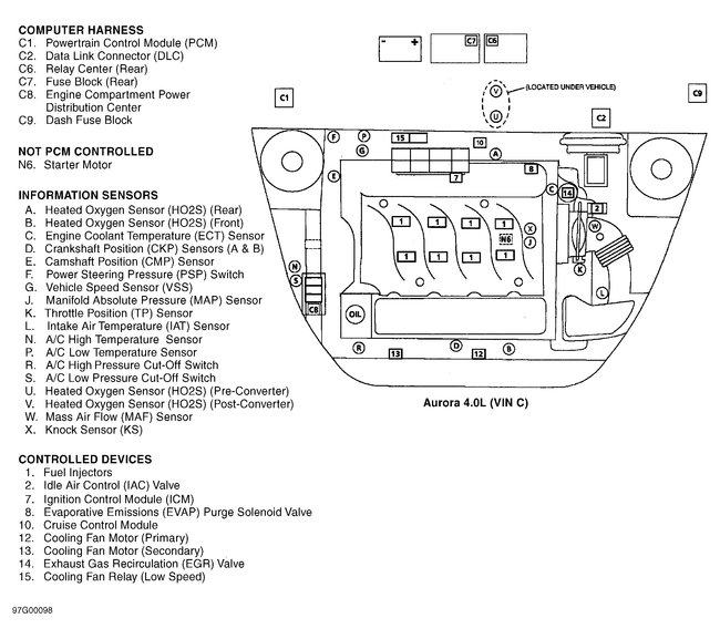

If that is not the problem, then the next likely thing is the starter. And you really do not want to replace the starter on that car because of where it is located. It is under the intake manifold (the plastic looking thing under the plastic cover). You can see it in the image below. Basically, it is a bear.
