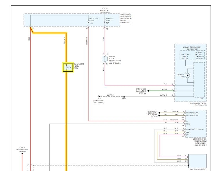

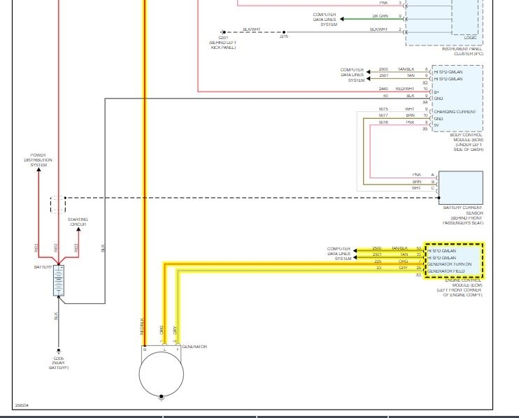

Was driving down the road everything inside truck turned off, then stalled. replaced battery and alternator. now battery isn't keeping charge.
May 9, 2020 at 11:46 PM
Good morning,

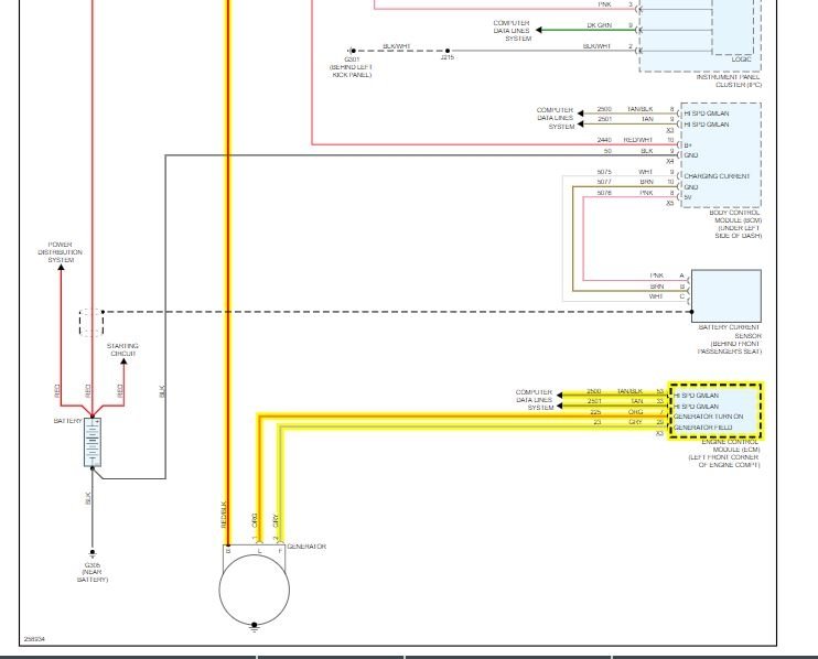

It sounds like the alternator is not working but need to test it to confirm.
Do you have a voltmeter to do some simple testing?

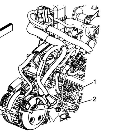

3. Reposition the battery positive junction block cable boot (1).
4. Remove the battery positive junction block cable to generator nut (2).
5. Remove the battery positive junction block cable terminal (3) from the generator stud.

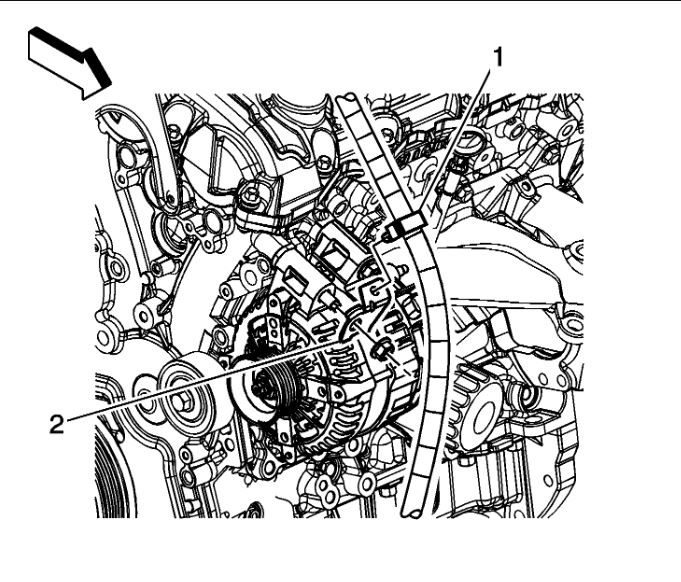

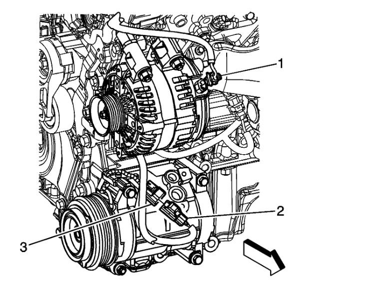

6. Disconnect the engine wiring harness electrical connector (1) from the generator.
7. Remove the power steering reservoir inlet hose clip (1) from the power steering fluid reservoir hose clip bracket (2).

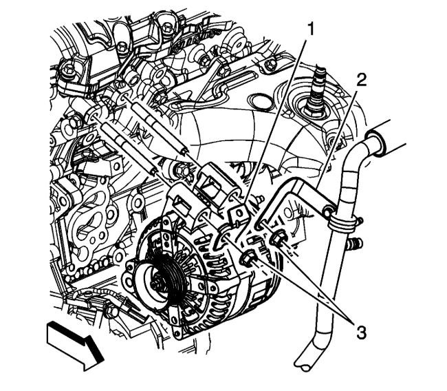

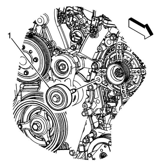

8. Loosen the idler pulley bolt (1) and slide the pulley out as far as possible.
9. Remove the generator nuts (3).
10. Remove the air conditioning (A/C) compressor/evaporator hose bracket (2) from the left generator stud.
11. Remove the power steering fluid reservoir hose clip bracket (1) from the right generator stud.
