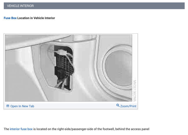

The interior fuse panel is in the right footwell. It may be that you have moisture in the fuse board causing you issues. I have attached a picture of the fuse board below. Please check for signs of water ingress.
Let us know exactly what happened with the water and we can advise what might have been affected. Check the carpets to see where the water may be getting in.
