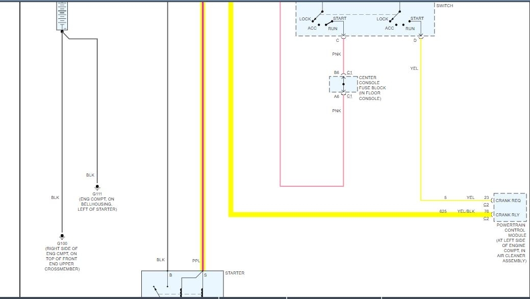

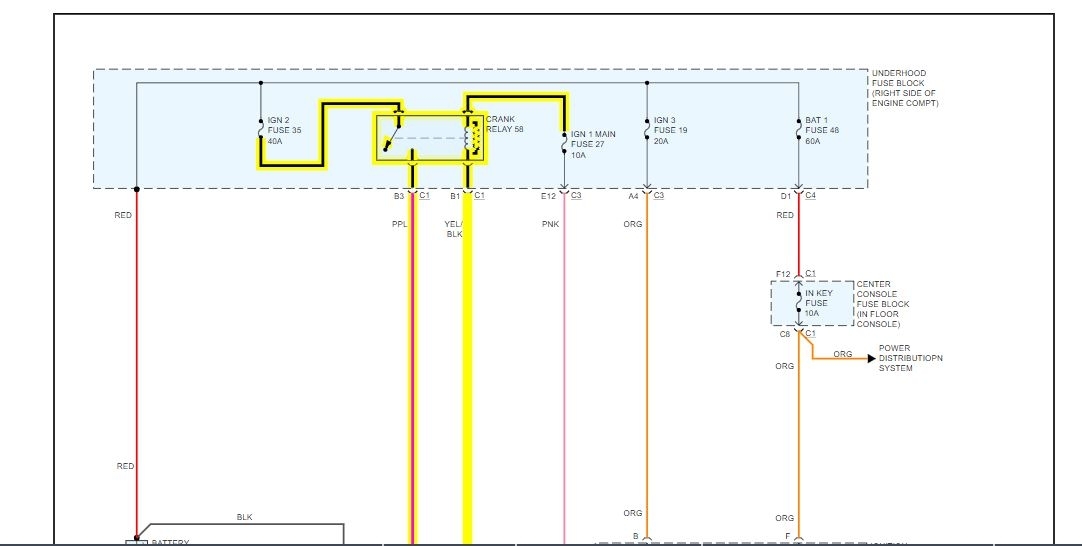

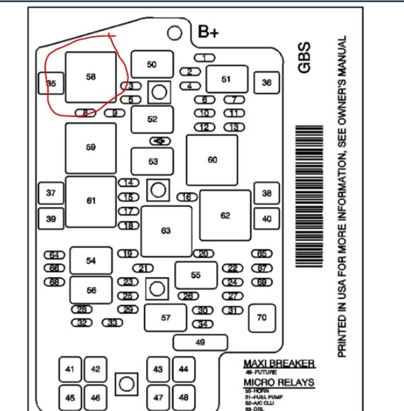

I have changed the cam sensor, have a new battery, fuses are good. I am not getting any power to turn the car over. The computer is working, the lights on the dashboard do come on, but still will not crank.
