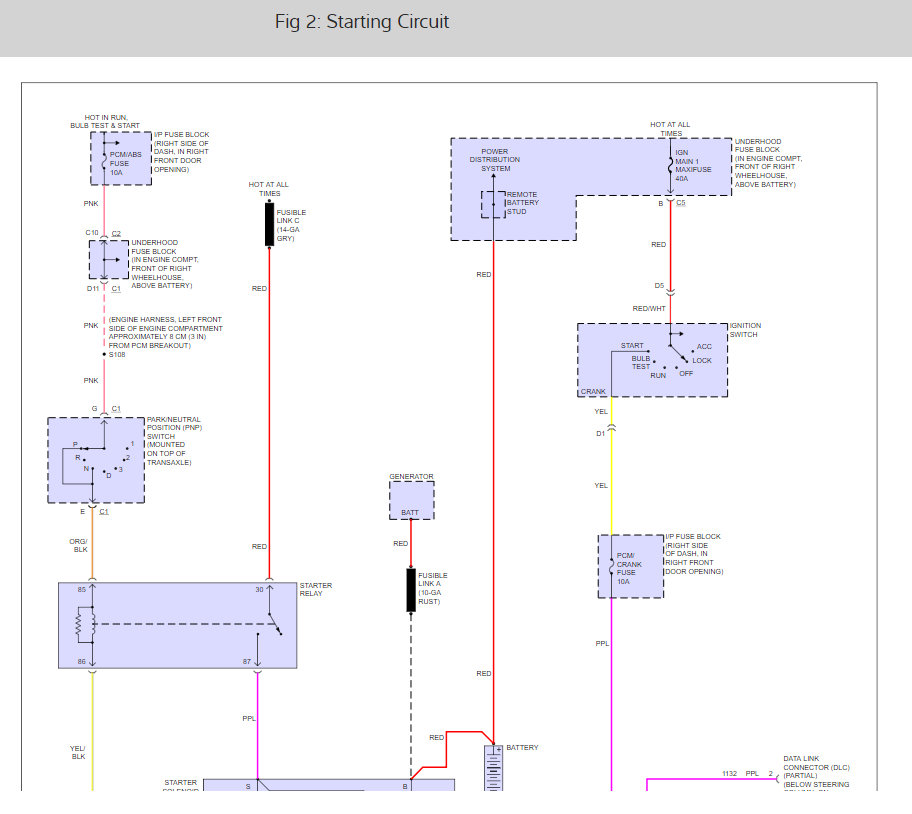

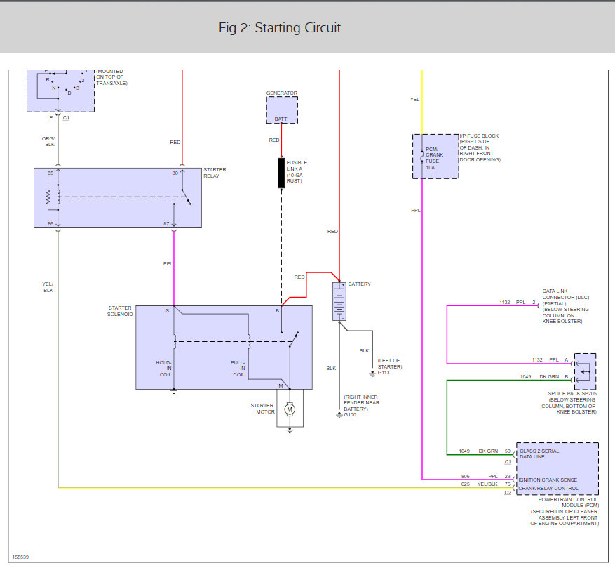

It sounds like the starter has gone out but to be sure you need to test the starter trigger for power when the key is turned. Here is a guide to help you see whats going on:
Here is a guide to test the wiring and the starter wiring diagrams to help you see how it works:
