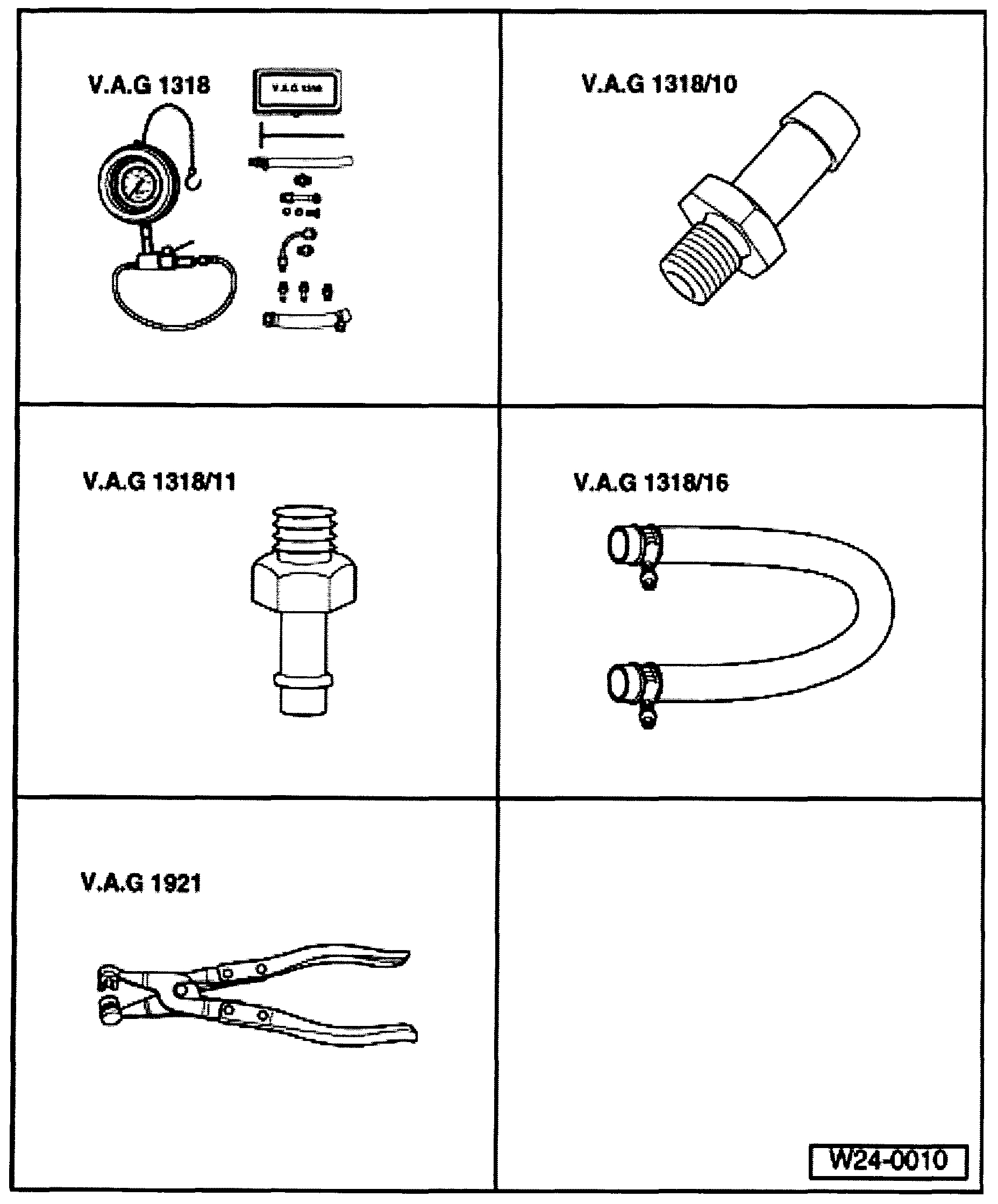

Special tools and equipment
- V.A.G1318 pressure gauge
- V.A.G1318/10 adapter
- V.A.G1318/11 adapter
- V.A.G1318/16 hose adapter
- VAS5024 Assembly tool for spring-type clamps.

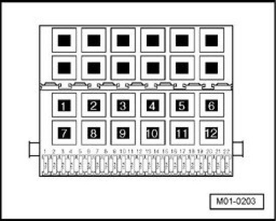

- Remove fuse no. 18 from fuse holder.

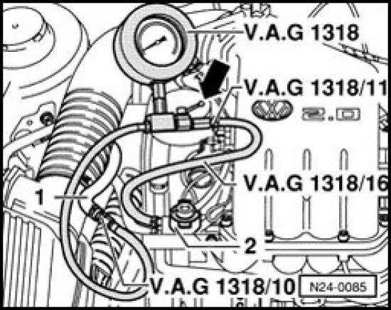

- Disconnect fuel supply line -1- from connection on fuel rail -2- and connect to adapter V.A.G 1318/10 at pressure gauge V.A.G 1318
- Use a rag to catch escaping fuel.
- Connect pressure gauge (V.A.G 1318) with adapters (V.A.G 1318/11) and (V.A.G 1318/16) to fuel rail -2-.
- Open pressure gauge shut-off valve. The lever points in the direction of flow (arrow).
- Re-insert fuse 18 (fuel pump) into fuse holder.
- Start engine and let run at idle.
- Measure fuel pressure.
Specified value: approx. 2.5 bar positive pressure

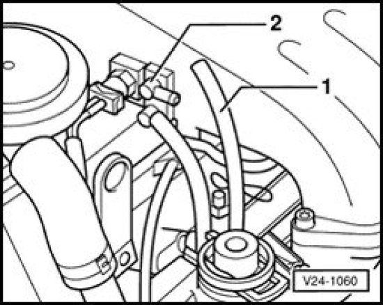

- Disconnect vacuum hose -1- from connecting piece -2-. Fuel pressure should rise to approx. 3.0 bar positive pressure rise.
- Switch ignition off.
Note:If fuel should escape at the vacuum connection of the pressure regulator, replace fuel pressure regulator.

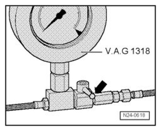

- Wait until pressure has dropped, and then switch off ignition. Simultaneously close pressure gauge shut-off valve (lever perpendicular to direction of flow -arrow-).
- Observe pressure drop on pressure gauge.
