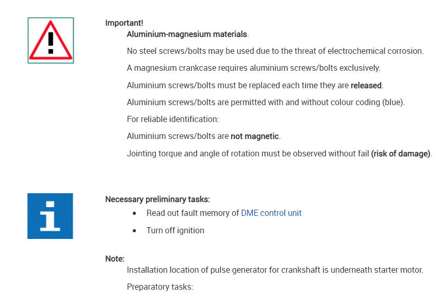

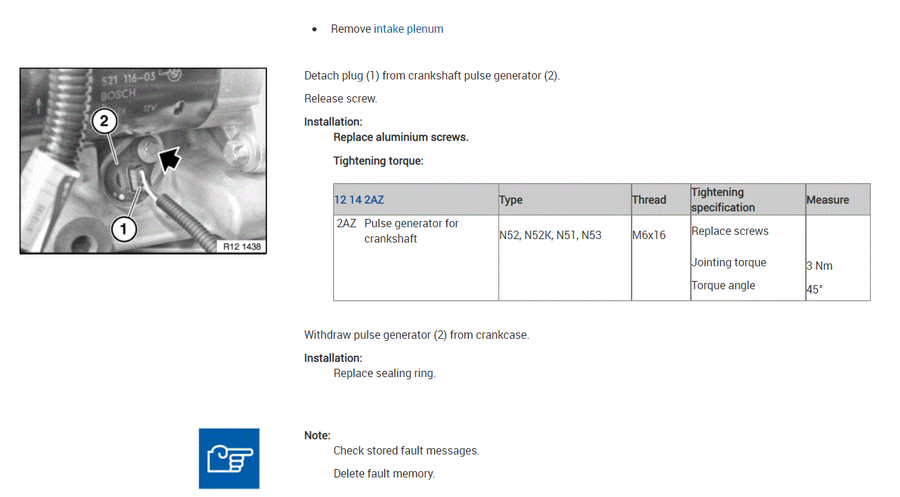

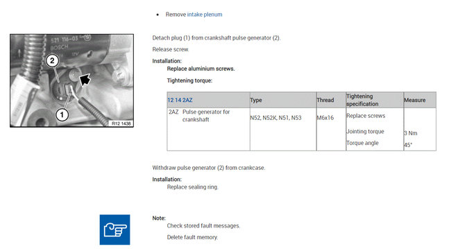

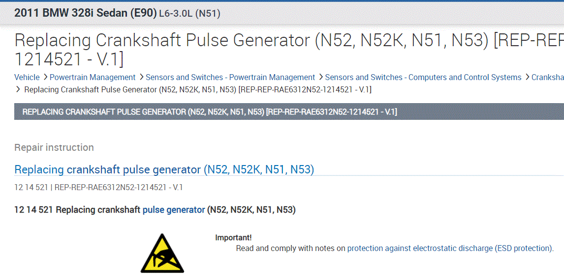

If you look at the attachments below, they are the directions specific to your vehicle for replacement.
See pics below.
