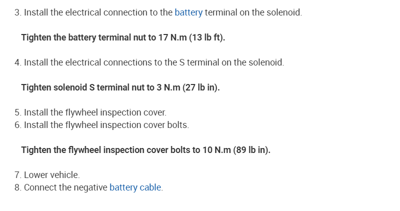

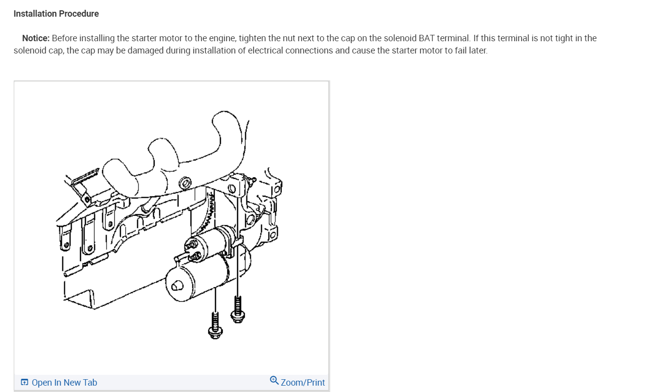

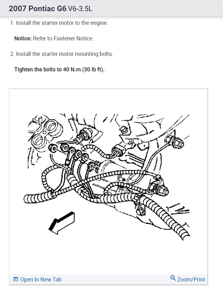

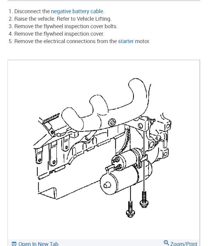

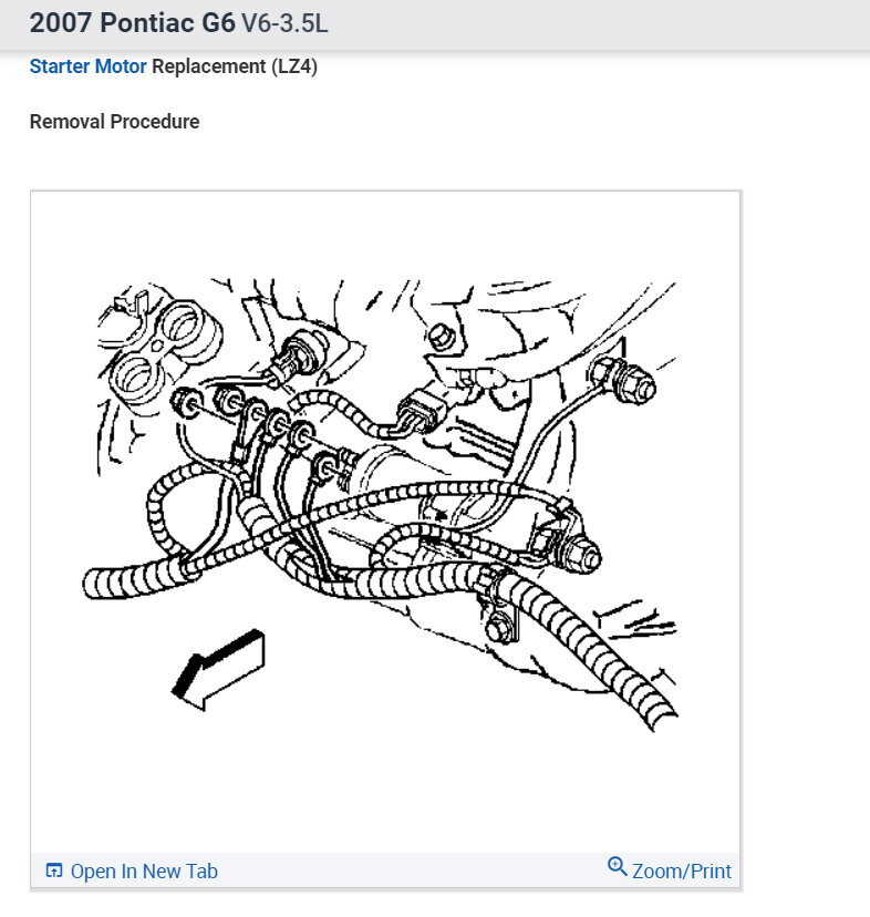

The engine will heat up a little more with the air on and this can affect the starter motor but to be sure let's use a test light on the trigger wire to see if it gets power when the key is in the crank position. This guide can help, and I have included how to change the starter motor out in the images below.
https://www.2carpros.com/articles/starter-not-working-repair
This guide can help walk you through the steps:
Check out the images (below). Let us know what happens and please upload pictures or videos of the problem so we can see what's going on.
