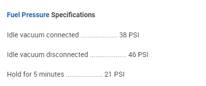

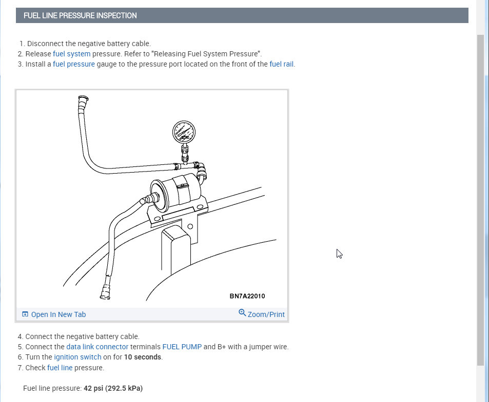

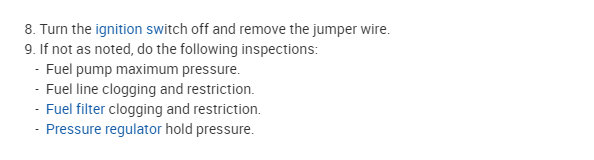

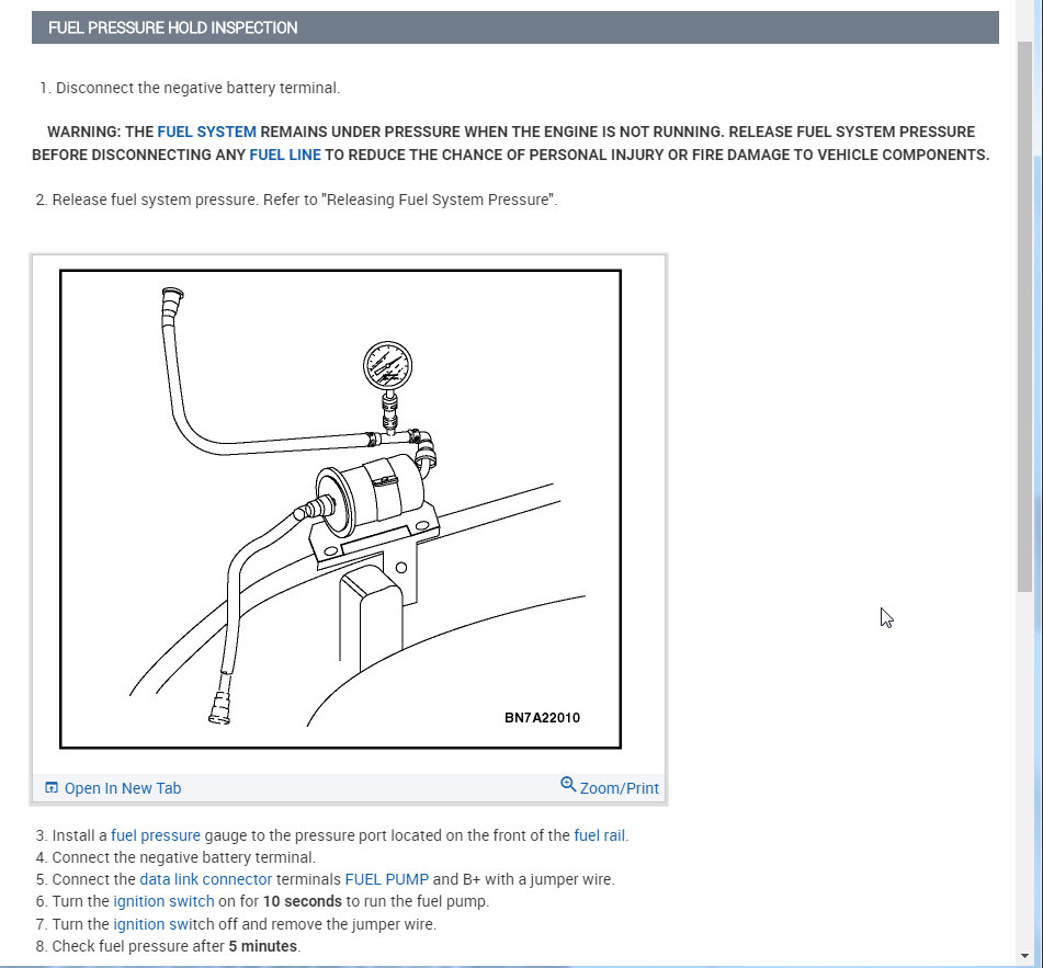

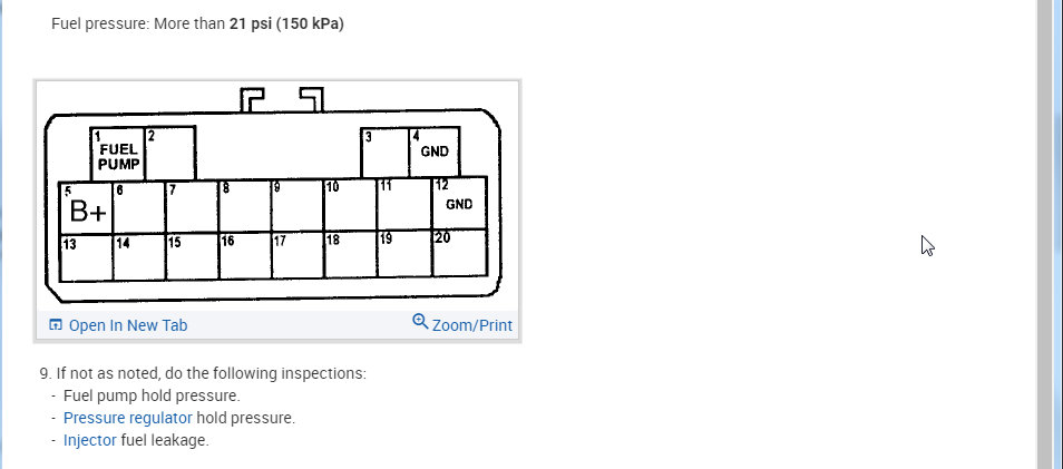

This does sound like a fuel issue so we need to dig further into this. Here is the pressures it should be and then inspections we need to do first. Let me know what the pressure is when you turn the key on and the other tests and we can go from there. Thanks
