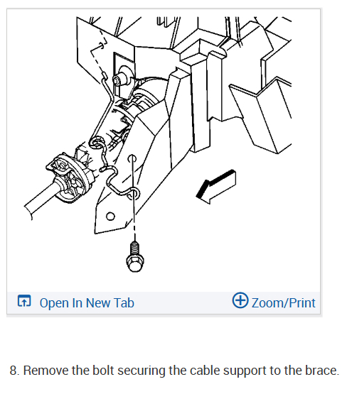

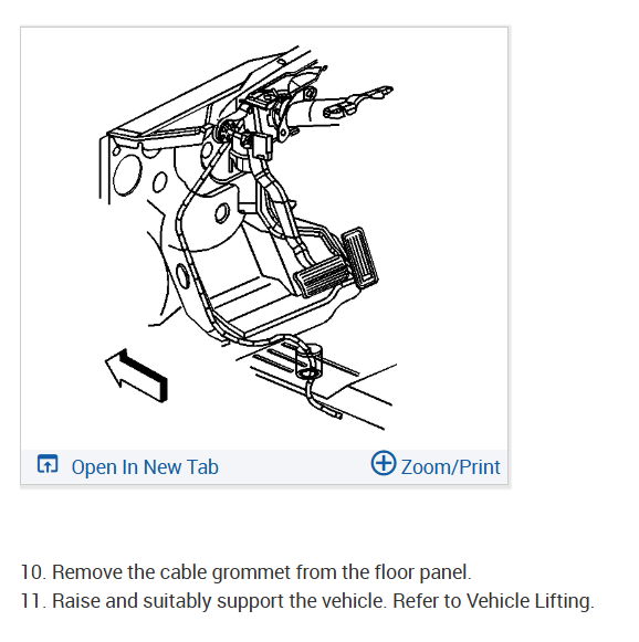

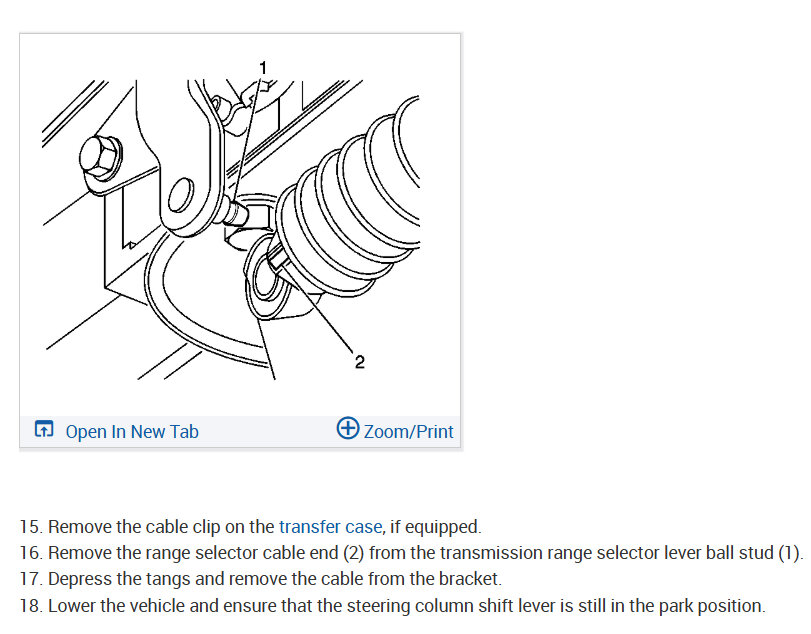

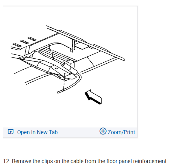

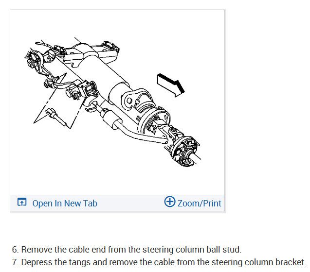

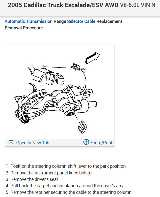

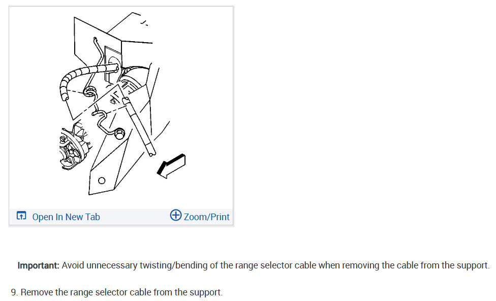

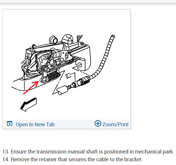

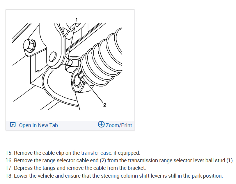

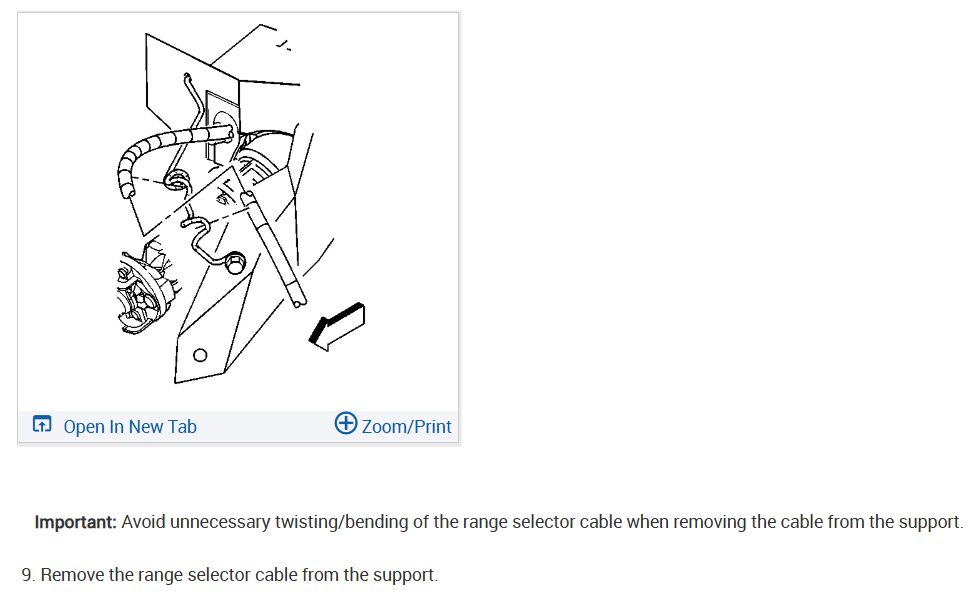

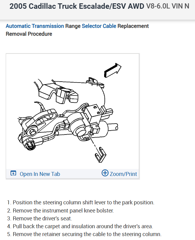

It sounds like the shift cable broke. I would have a helper shift through the gears, (parking brake on) while you look at the shift arm for movement, if not the cable is bad or one of the cable ends has fallen off their mount. Here is how to replace it and what to look for. I marked a red arrow in the diagram below what to watch. Check out the images (below). Please let us know what happens.
