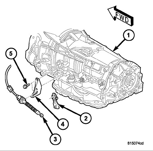

So the lever moves but the transmission doesn't go into gear. The first thing would be to look at the side of the transmission under the vehicle. Have someone move the shifter and see if the lever on the side of the transmission moves at the same time.

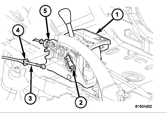

If it doesn't and the cable is connected to the lever, then it is likely that the shift cable has come loose at the shifter inside the console. The cable just snaps onto pins at both ends and the bushing inside the ends tend to wear or break and the cable falls off. The one on the side of the trans isn't hard to repair. The one inside requires the console be removed to get to the shifter.
Now if the shift lever on the trans does move when shifted, there is an internal problem with the transmission OR the transfer case is in neutral.

In your case where the shift lever moves throughout its range, but the transmission doesn't go into gear, the cable going to the transmission is broken or became disconnected, usually AT the transmission. If the cable broke, it's because it frayed at one end. That would have given plenty of warning because it would have become harder and harder to move the shift lever. It's also possible for the cable's outer casing to slip in its anchor, again, usually AT the transmission end. Most commonly the symptom, at least at first, is you have to move the shift lever too far to get the desired gear, and / or the indicator might show the wrong gear. Showing the wrong gear can happen on older vehicles with a mechanical pointer. Yours should have a digital indicator in the instrument cluster. The clue then is it continues to show "park" when you move the shift lever.

She took in and it was the cable was broken
