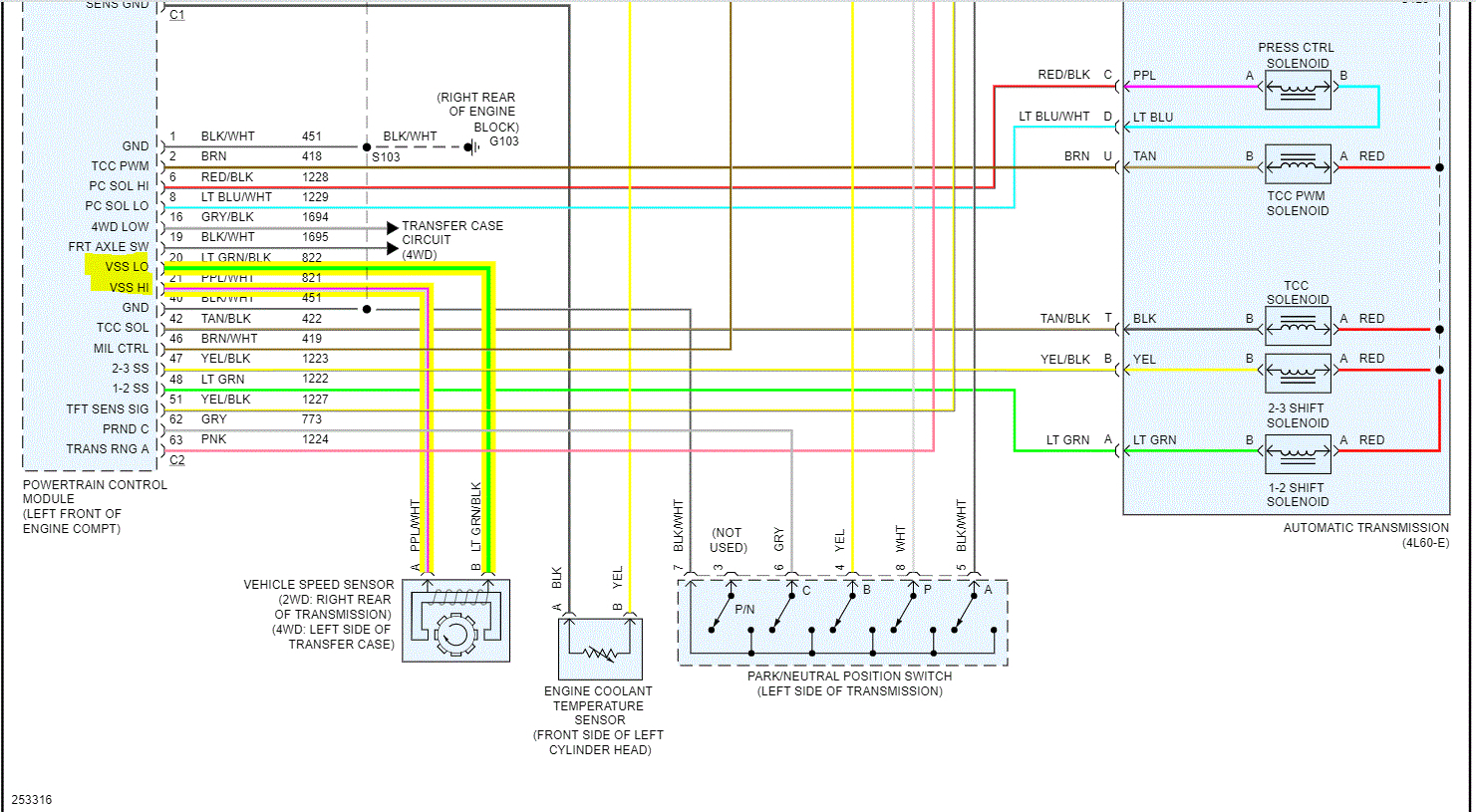

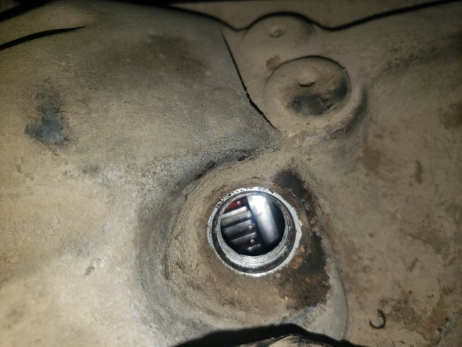

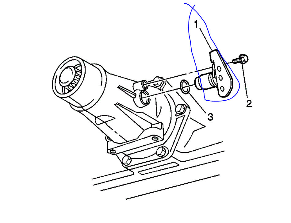

i can re create the problem. Here goes: first speedometer does not work when this problem occurs. The speedometer always jumps from 0 when i first start out until about 4 mph, even when problem is not happening. I can re create by driving slow in the 0-4 mph range sometimes, and i get the speedometer inoperable and wont shift out of first. I have replaced the VSS on the transmission. Also reset TCM and ECM by disconnecting battery and drained by turning lights on. The TCM feeds signals to ECM, ECM drives the speedometer. I suspect the TCM is wigged out but before spending $125.00, wanted opinion. Thanks. Joe
